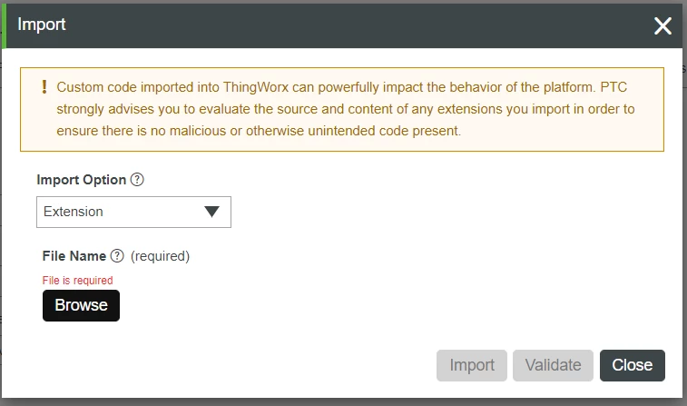

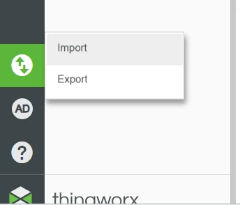

      2. In the lower-left side of Composer, click Import/Export, then Import.
      3. In the Import From File pop-up, under Import Option select Extension from the drop-down, then click Browse
     4. Navigate to the .zip file you downloaded.
     5. Click Import in the Import From File pop-up, then click Close after file is successfully imported.

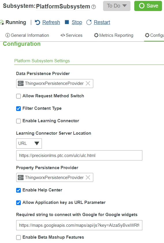

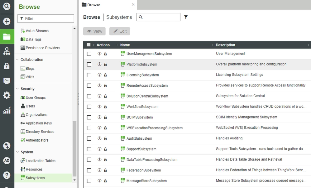

     6. In the ThingWorx Browse tab, in the System section, click on Subsystems, then PlatformSubsystem.
     7. Click on the Configuration tab, then click the Edit button if you are not already in edit mode.
     8. Scroll down to the Required string to connect with Google for Google widgets field where you enter the Google Maps JavaScript URL with your API key: https://maps.googleapis.com/maps/api/js?key=<Your API key>
       9. Click Save

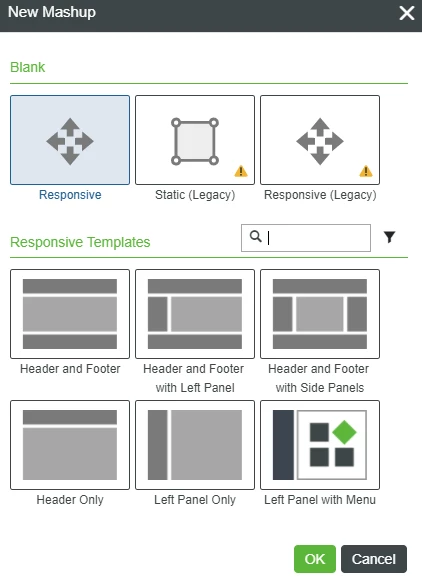

      2. Select Mashups in the left-hand navigation, then click + New to create a new Mashup.
      3. For Mashup Type select Responsive.
NOTE: A Responsive Mashup scales with a browser's screen size. In the steps below we will create 5 containers, one for each widget, to organize how the widgets are presented.
     4. Click OK.

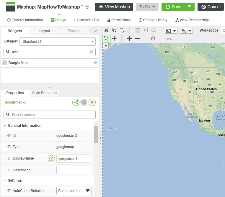

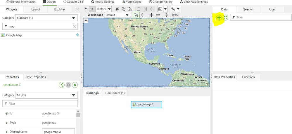

     8. Select the Design tab to display Mashup Builder.
     9. Click the Widget tab on the top-left, then enter map inside the Filter Widgets field.
     10. Drag-and-drop the Google Map widget onto the Mashup.

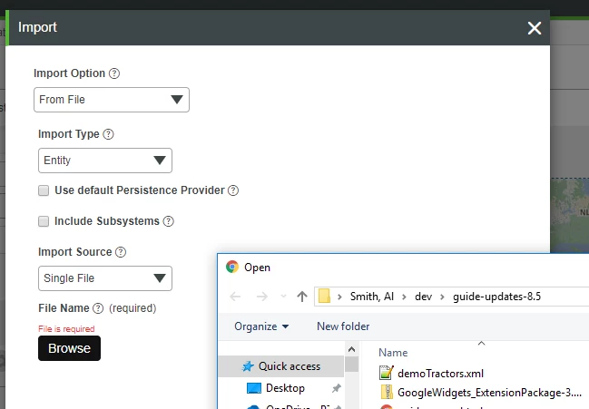

We have created a file with sample entities for this exercise.
  1. Download demoTractors.xml to your computer.
      2. Click Import/Export in the lower left of Composer, then select Import
     3. Click From File in the drop down, then Browse.
     4. Browse to the demoTractors.xml file and click Open.
     5. Click Import, then Close after entities are successfully imported.

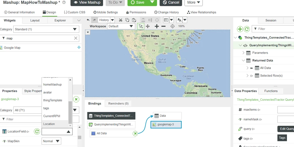

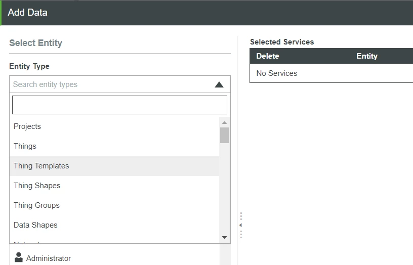

Step 4: Add Markers to Google Maps Widgets

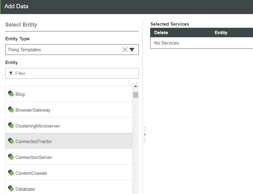

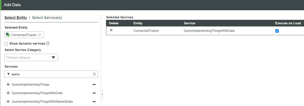

To display markers on the map you must bind an Info Table to the Widget's Data Property and specify which column has location information. In this example we will use the QueryImplementingThingsWithData Service to bind a group of Things created with the same Template.
  1. Click the + button in the Data tab on the right side of the Mashup Builder window
      2. In the Add Data pop-up, click Thing Templates from the Entity Type drop down.
      3. Select a Template from the list that has a Location property and was used to create Things. For this exercise, use the ConnectedTractor Template that was imported from the sample file downloaded in the prior step.
     4. Enter query into the filter text box then click the arrow to the right of QueryImplementingThingsWithData.
     5. Click the Execute on Load check box, then click Done. This will cause the QueryImplementingThingsWithData Service to execute as soon as Mashup is loaded.

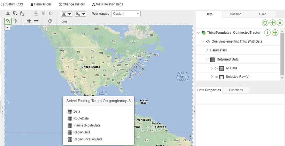

     6. Expand Returned Data if you do not see All Data then click and drag All Data onto the Google Maps Widget.
     7. Click Data in the Select Binding Target pop-up.
     8. In the Properties panel in the lower left, scroll to see the LocationField property and select Location, the name of the Property with location information.
Test Map Operation

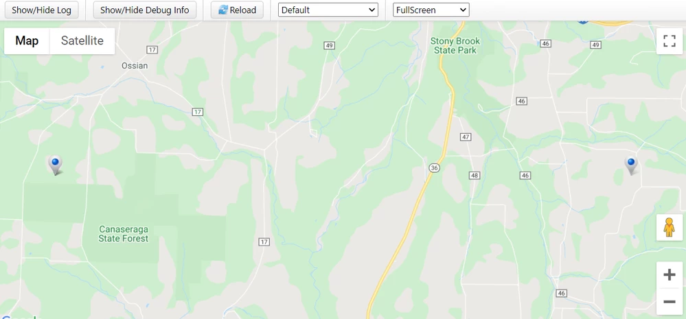

  1. Click Save to save your Mashup.
      2. Click View Mashup to see the Google Maps Widget displaying the locations of each Thing.
NOTE: The Google Maps Widget has built-in functionality that allows users to pan and resize the map as well as switch to satellite photo maps.
