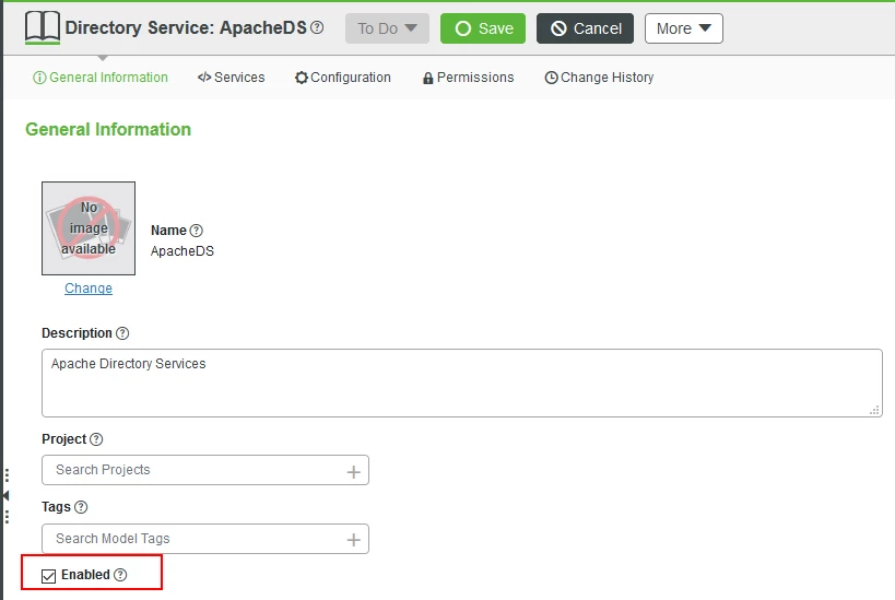

  1. From the ThingWorx Composer, go to the SECURITY section and click Directory Service.
  2. Open the Directory Service Entity you imported, ApacheDS.
  3. Enable LDAP in the General Properties section by checkicking the Enabled checkbox.
4. (Optional) Set the priority for the authentication if you have multiple Directory Service entities configured:
  • Use the Priority property to assign an order of authentication to log in.
  • The lower the number the higher the priority (1 is the highest priority).
5. Click Save to save ApacheDS and enable LDAP authentication.

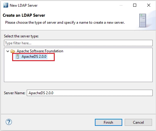

  1. Open Apache Directory Studio.
  2. Right-click in the LDAP Servers section and select New -> New Server.
  3. Select your version of ApacheDS in the menu and click Finish.

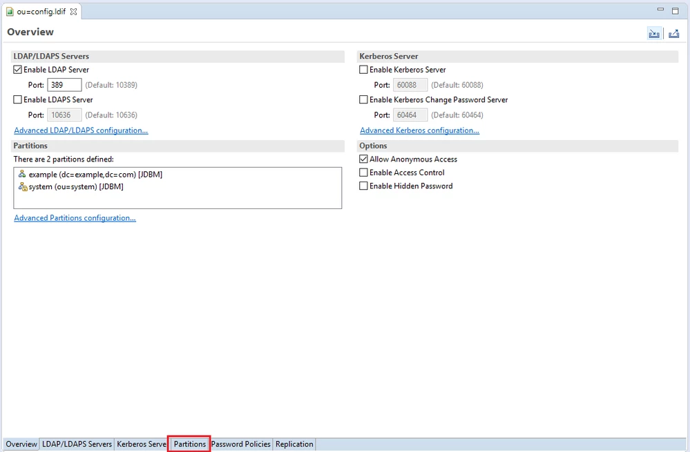

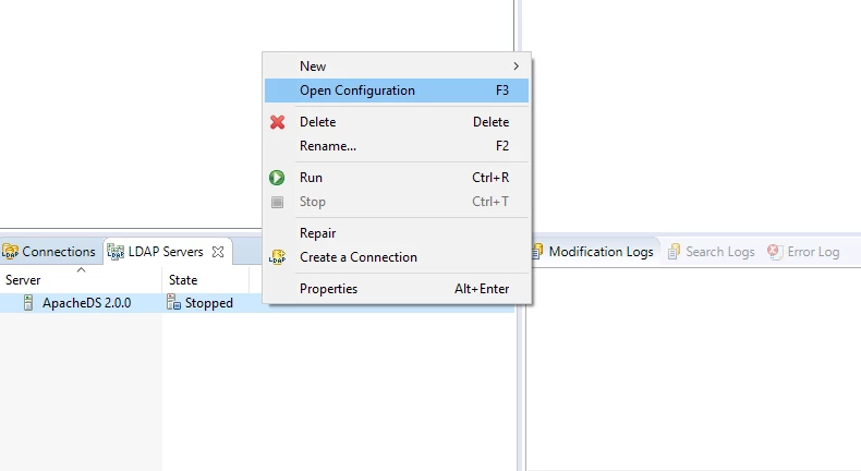

  4. Right-click the newly created LDAP server and select Open Configuration.

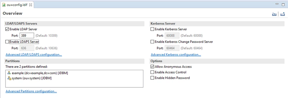

  5. Update the Port for the LDAP server to 389 and uncheck the LDAPS server.

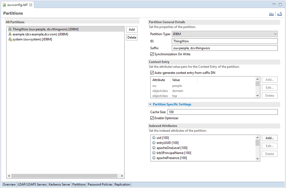

  6. Click Partitions at the bottom of the configuration and click Add.
  7. Set the new Partition ID to ThingWorx.
  8. Set the Suffix value of the Partition to ou=people, dc=thingworx.
  9. Save and close the configurations.

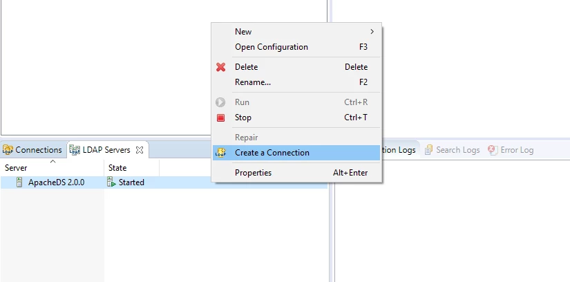

  10. Right-click the LDAP server and select Run.
  11. Once the State of the LDAP server has changed to Started, right-click the LDAP server and select Create Connection.
Utilize the ApacheDS adding entries guide to create users for your new LDAP server then follow the below instruction to create the ThingWorx connection.

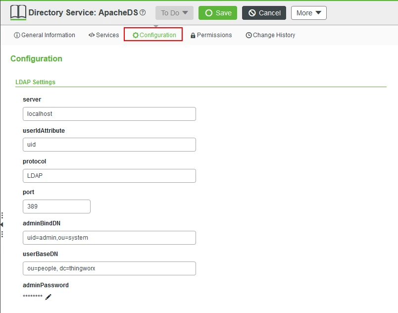

Configure ThingWorx For LDAP Connection: The sample XML files provided are configured with the most common attribute for the platform.
  2. Open the Directory Service Entity you imported, ApacheDS. Generally, only one Entity listed unless multiple authentication realms have been configured.
  3. Click Congifurations to bring up Directory Service configuration details.
  4. Update the configuration parameters for the LDAP server:
    • server: The hostname of the LDAP server
    • userIdAttribute: LDAP attribute that is used to uniquely identify the user logging in. This property should be set to the name of the attribute containing the user's username.
    • port: Connection port for the LDAP server. LDAP standard port is 389. If the LDAP server's connection port is 636, it is very likely that the server is expecting LDAPS, which ThingWorx does not currently support.
    • adminBindDN: The full distinguished name for the user that the ThingWorx server will use for browsing the LDAP directory tree. The user that is defined here must have Read permissions on the directory tree. Generic Format: uid=admin, ou=Users, dc=company, dc=com
    • userBaseDN: Distinguished name for the parent organizational unit (OU) containing any user that will need to log in. *Generic Format*: ou=ThingWorxUsers, ou=Users, dc=company, dc=com
    • adminPassword: The password for the user configured in adminBindDN above
  5. Click Save to update the ApacheDS Directory Service.
