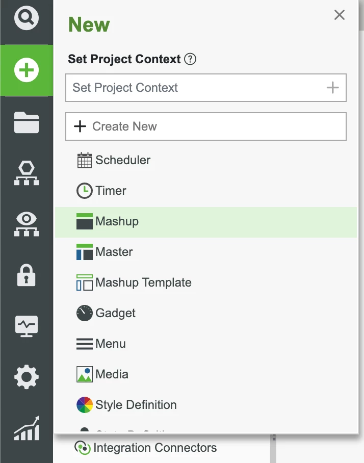

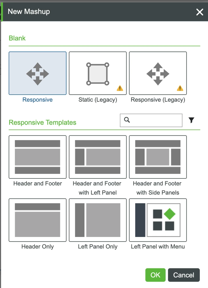

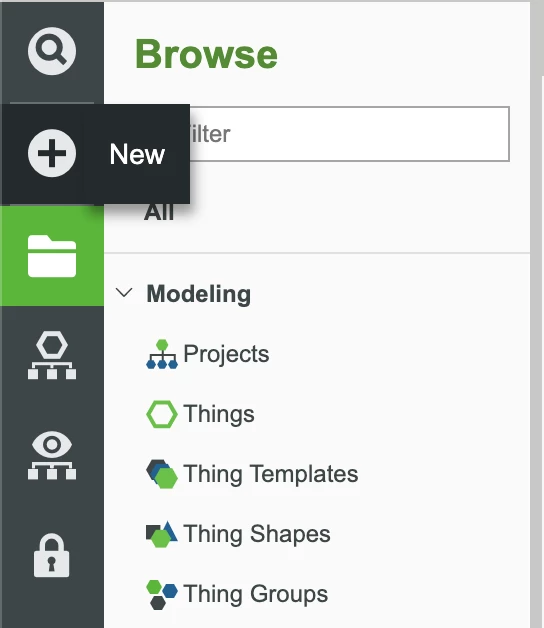

  1. In the ThingWorx Composer, click the + New at the top of the screen.
  2. Select Mashup in the dropdown.
  3. Select the Responsive layout then hit OK.

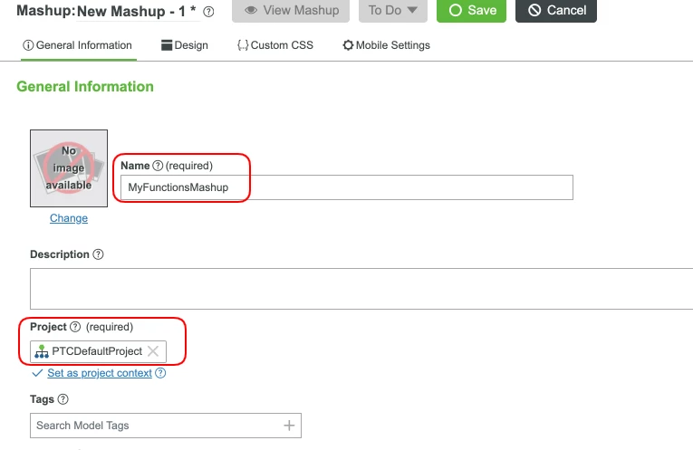

  4. Set the Name to  MyFunctionsMashup.
  5. For the Project, click the + button and select PTCDefaultProject.

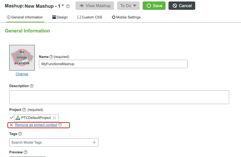

  6.  Under Project, click the blue Set as project context option. This will stop us from having to set the Project on every Thing we create. It should now match the following.
  7.  Click Save.

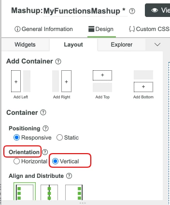

  1. Click the Layout tab.
  2. Scroll down and set the Orientation to Horizontal.

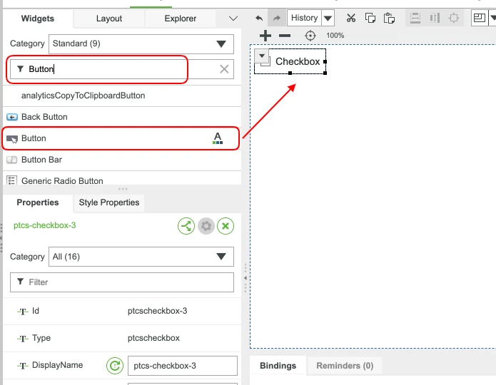

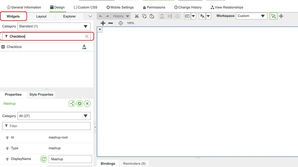

  3. Click on the Widgets tab.
  4. Type in the Filter text box for Checkbox.
  5. Drag and drop a Checkbox Widget to the Mashup Canvas. This Checkbox will dictate whether what we show for the coming Labels and Textbox.
  6. Type in the Filter text box for Button. This Button will dictate the event that triggers our Functions.
  7. Drag and drop a Button Widget to the Mashup Canvas.

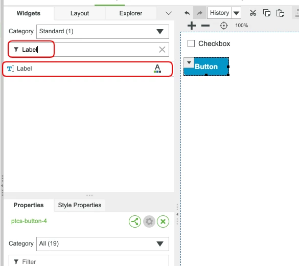

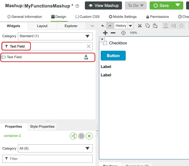

  8. Type in the Filter text box for Label.
  9. Drag and drop TWO (2) Label Widgets to the Mashup Canvas. We will only show one Label at a time and I'll show you how.
  10. Type in the Filter text box for Text Field.
  11. Drag and drop a Text Field Widget to the Mashup Canvas.

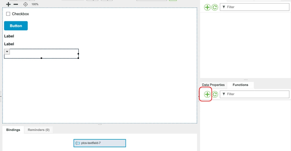

We have the Widgets we need to show our Expression example. Let's start with connecting the Widgets to Functions.

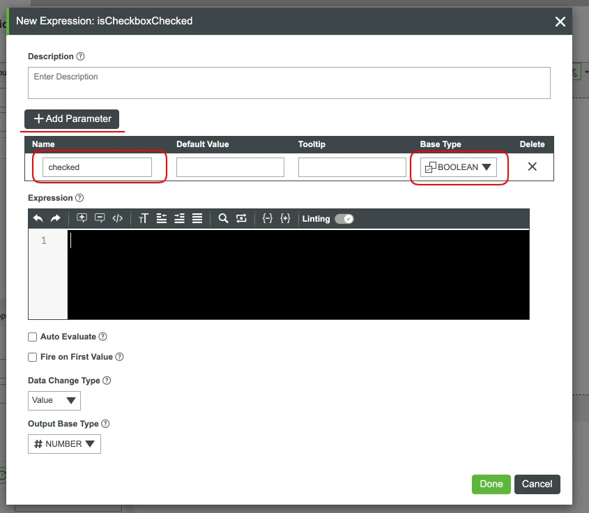

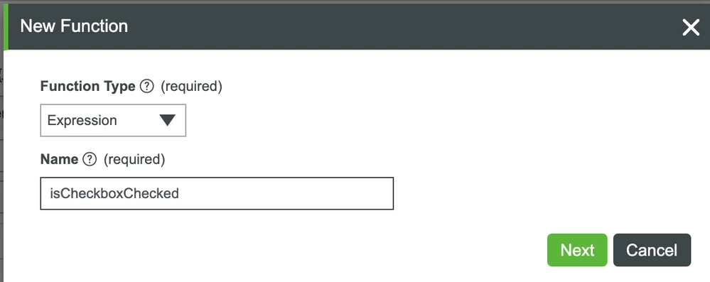

  1. Click the + button in the Functions section in the bottom right.
  2.  In the New Function popup, select Expression.

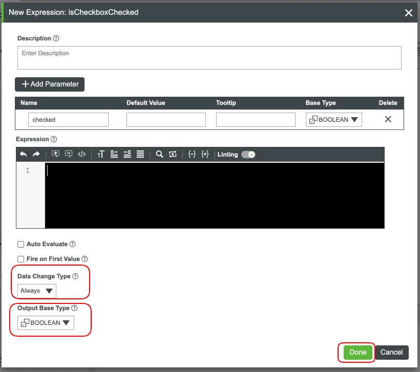

  3. Set the Name of the new Expression to isCheckboxChecked.
  4. Click Next.
  5. In the new screen, click Add Parameter.
  6. Set the Name to this new parameter as checked.
  7. Set the Base Type as BOOLEAN.
  8. Switch the Data Change Type to ALWAYS.
  9. Switch Output Base Type to BOOLEAN.

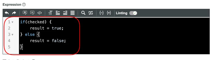

  10. Add the following code to the Expression area.
if(checked) {
 result = true;
} else {
 result = false;
11. Click Done.

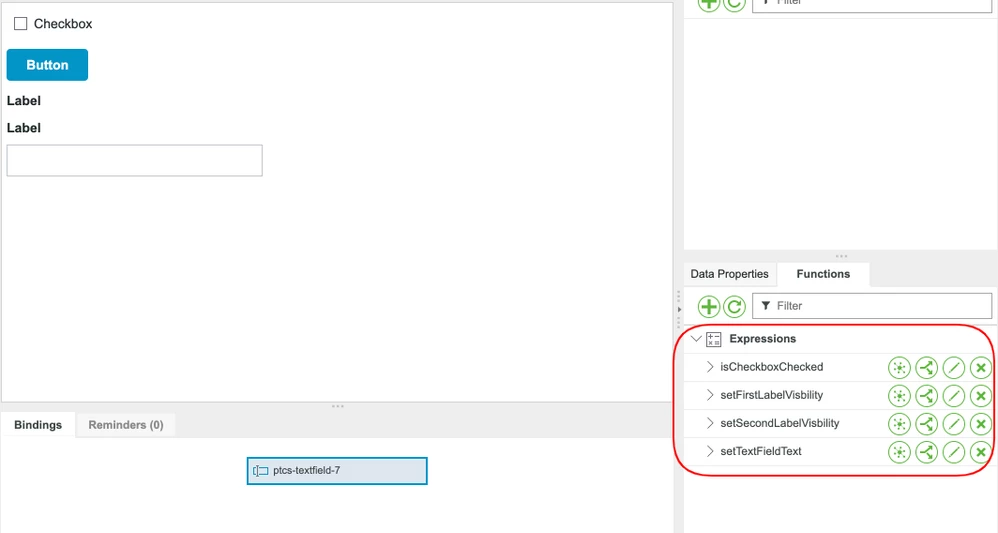

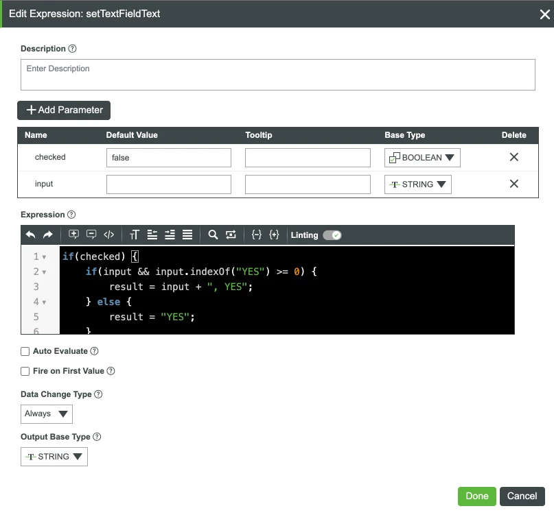

You've now created your first expression. This expression is an example of how easy it can be done. Let's add three three additional Expressions to have some fun.
  1. Repeat steps 1-11 in the last section for TWO (2) new Expressions. Name these Expressions setFirstLabelVisbility and setSecondLabelVisbility. You should now have three total.

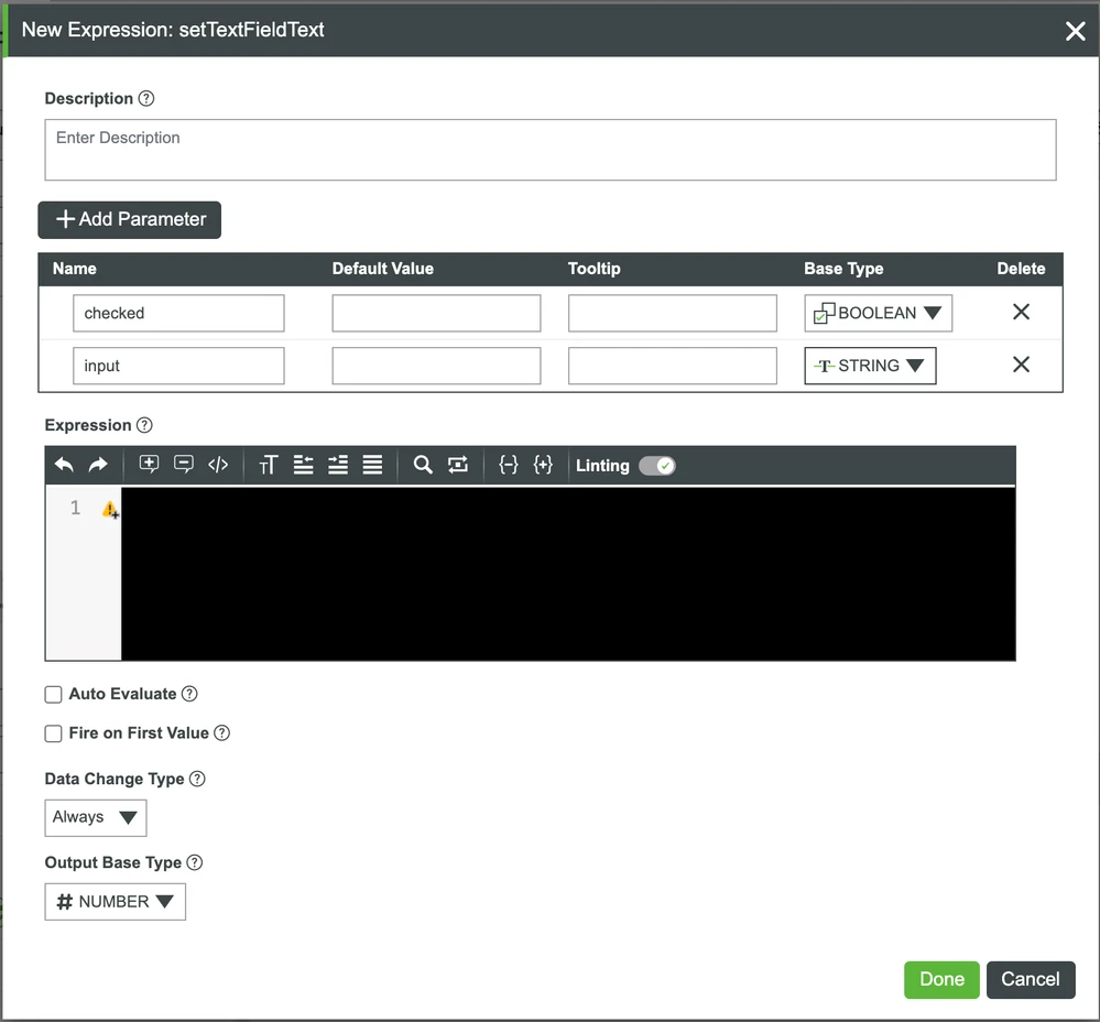

  2. Repeat steps 1-8 in the last section for ONE (1) new Expression. Name this Expression setTextFieldText.
  3. We should have a Parameter called checked. Click Add Parameter again to add a Parameter named input. This fourth Expression should match the following thus far:
  4.  Switch Output Base Type to STRING.
  5. Add the following code to the Expression area:
if(checked) {
    if(input && input.indexOf("YES") >= 0) {
    result = input + ", YES";
    } else {
        result = "YES";
} else {
    result = "NO";
6. Click Done.

  1. Ensure Expressions are visible and match the following.

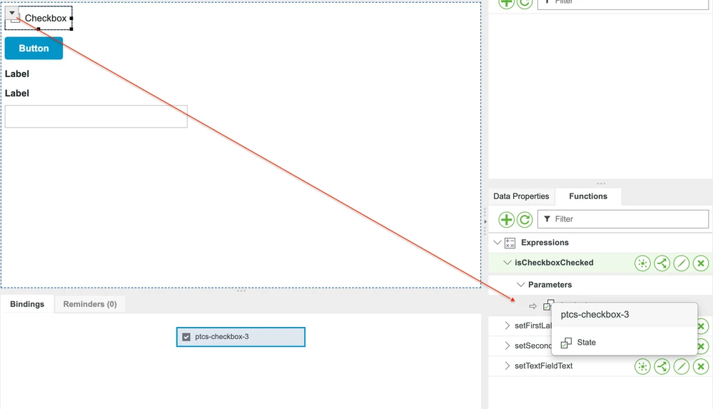

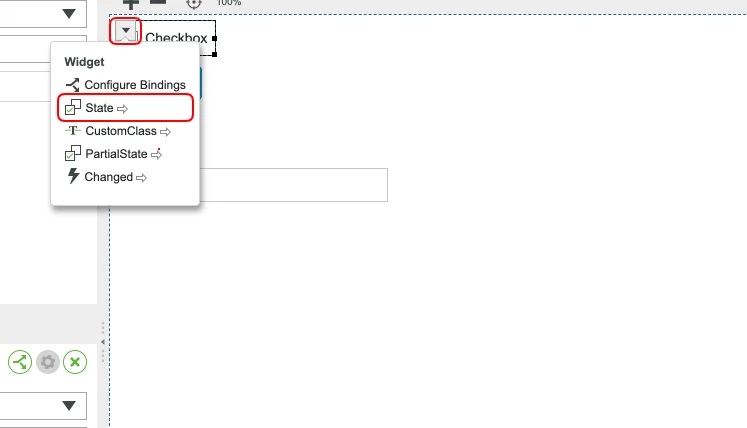

  2. Click on the Checkbox in the Mashup Canvas.
  3. Click the dropdown that appears.

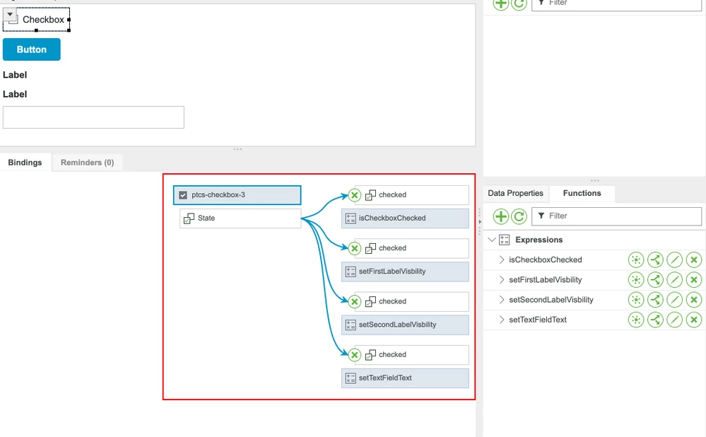

  4. Drag and drop the State Property to the checked Parameter of all FOUR (4) of the Expressions.
  5. Your bindings should match the following after you're done with setting all four.

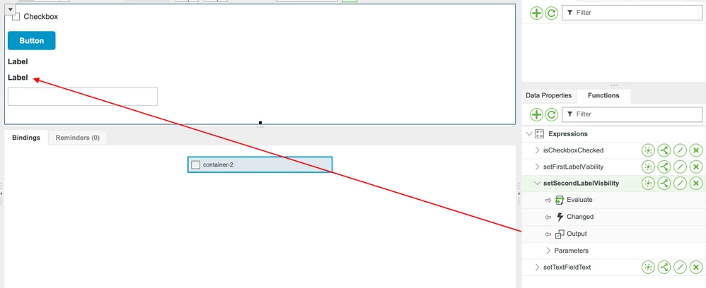

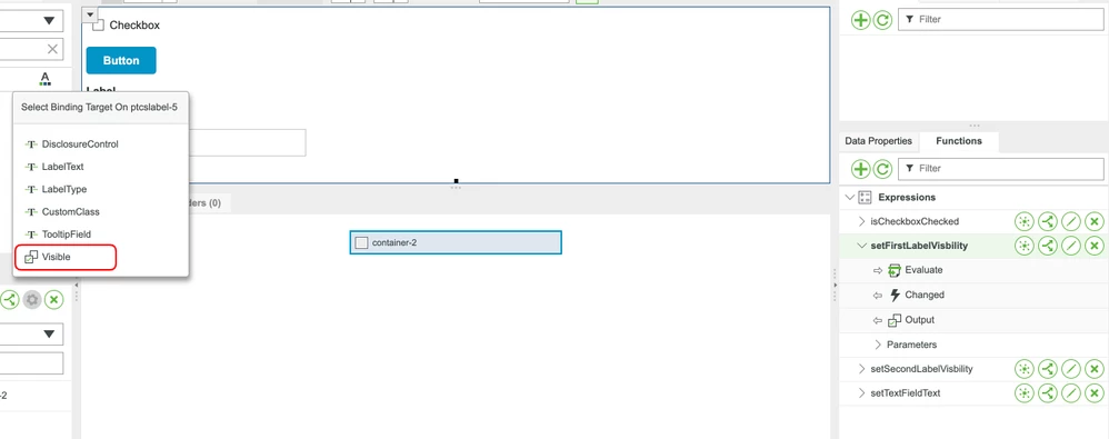

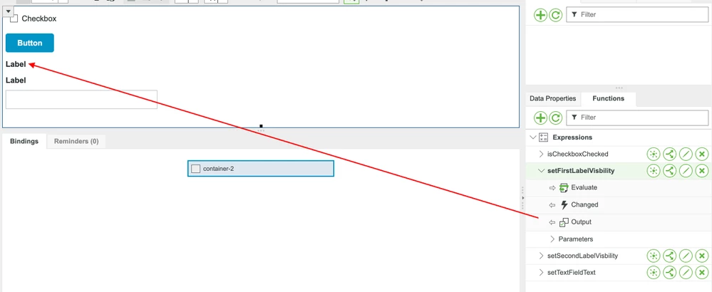

  6. Expand the setFirstLabelVisibility Expression (if not already expanded).
  7. Drag the Output to the first Label and select Visible
  8. Expand the setSecondLabelVisibility Expression (if not already expanded).
  9. Drag the Output to the second Label and select Visible.

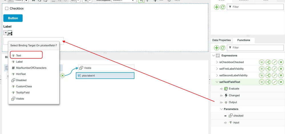

Our labels are configured. Now let's setup our Text Field Widget.
  1. Expand the setTextFieldText Expression (if not already expanded).
  2. Drag the Output to the Text Field and select Text.

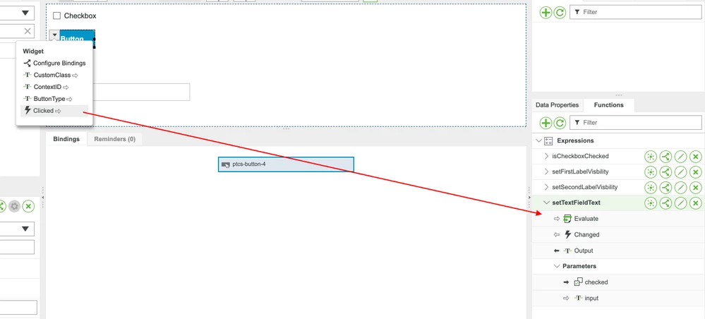

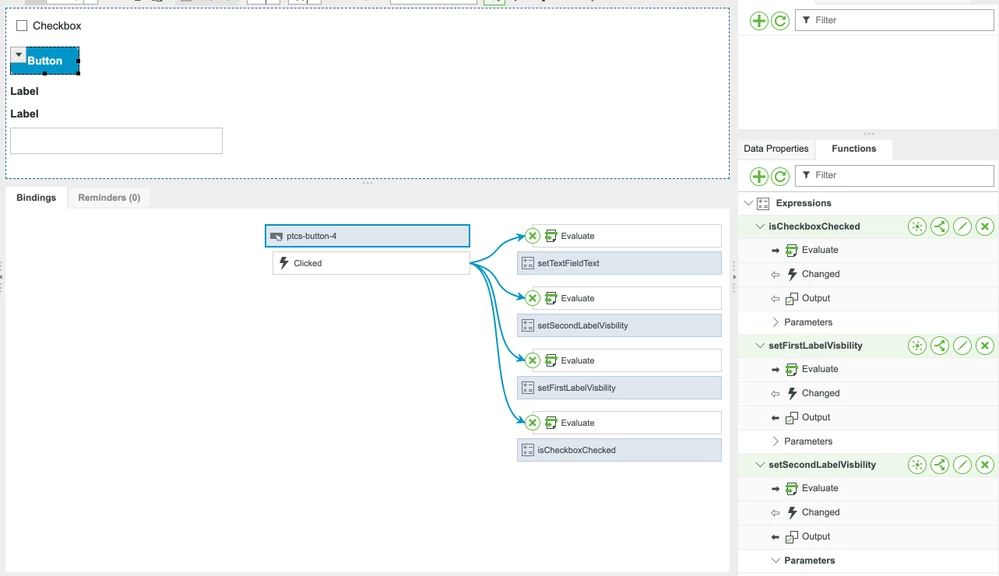

  3. Select the Button Widget in the Mashup Canvas.
  4. Click the dropdown for the Button Widget.
  5. Drag and drop the Clicked Event to all FOUR (4) of the Expressions.
  6. Your Button Widget should look like the following:

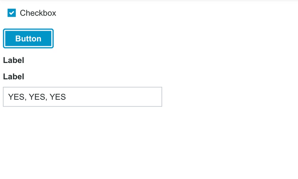

  11. Click View Mashup. Play around and see all the work you've done.
You may notice that both Label Widgets show or hide at the same time. To split when they will show or hide, update the code for one of the Label visibility Expressions to the following:
if(checked) {
    result = false;
} else {
    result = true;
Click here to view Part 2 of this guide.
