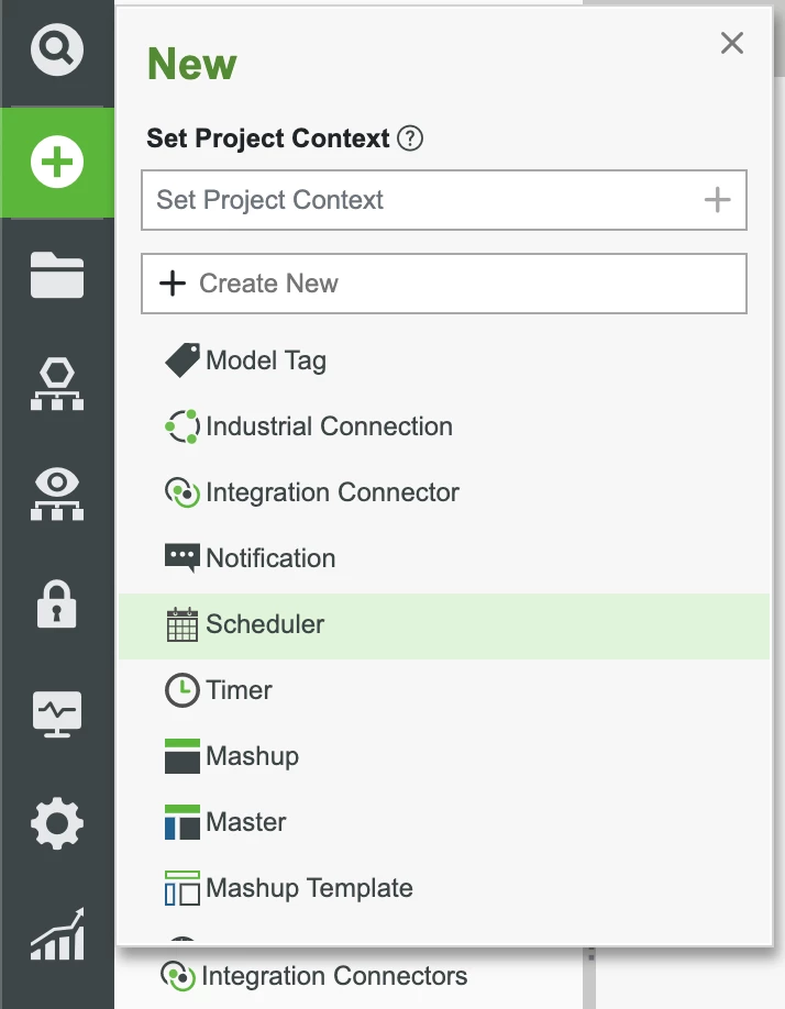

Let's create the schedule that will start the cooking process.

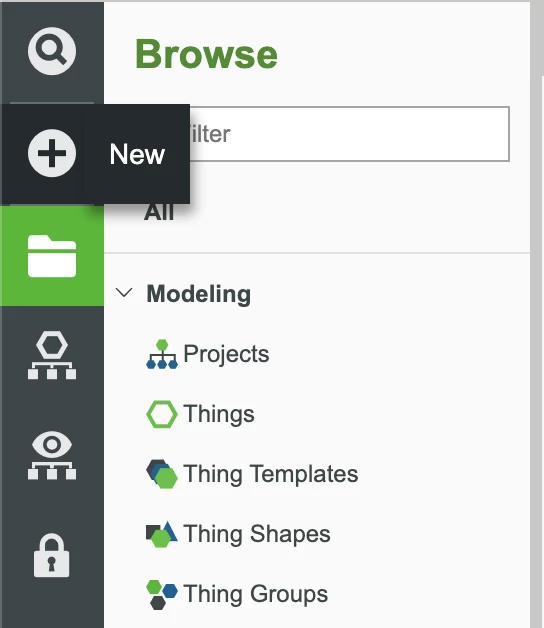

  1. In the ThingWorx Composer, click the + New in the top left of the screen.
  2. Select Schedules in the dropdown.

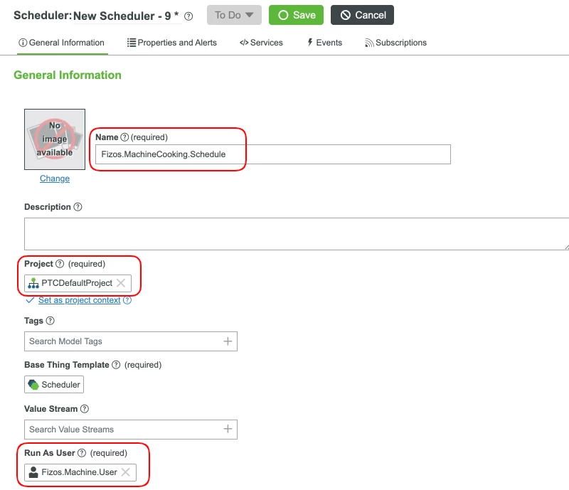

3. Name the new Schedule Fizos.MachineCooking.Schedule and set the Project (ie, PTCDefaultProject).
4. For the Run As User field, select the Fizos.Machine.User that was provided in the download.
5. Click Save and your entity should match the below configuration.
6. For the Schedule field, set it to 0 0 0/3 * * ?. This will run the process every 3 hours.

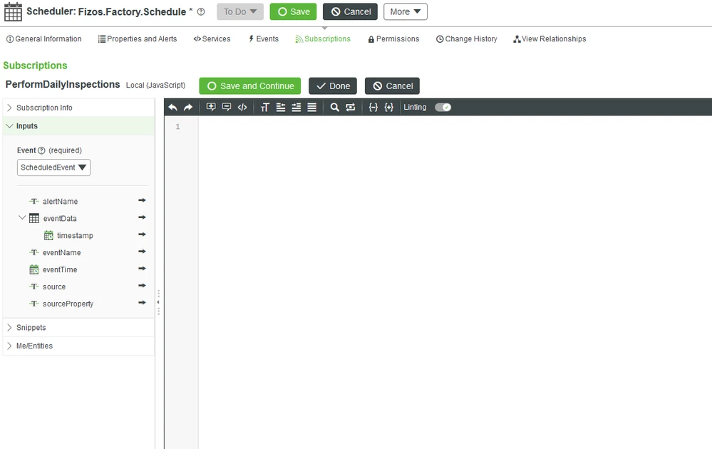

7. Switch to the Subscriptions tab and add a new subscription.
8. Name this new subscription StartCooking and select ScheduledEvent as the event input.
9. Add the following code to the source section:
var index = 0;
var brauts = Resources["SearchFunctions"].SearchThingsByTemplate({
 thingTemplate: "Fizos.BrautsMachine.ThingTemplate"
var sausage = Resources["SearchFunctions"].SearchThingsByTemplate({
 thingTemplate: "Fizos.SausageMachine.ThingTemplate"
for(index = 0; index < brauts.rows.length; index++) {
 brauts.StartCookingProcess();
 sausage.StartCookingProcess();
// This will begin the process to start each machines cooking process.
// The process itself will then be ran by alerts, subscriptions, and services

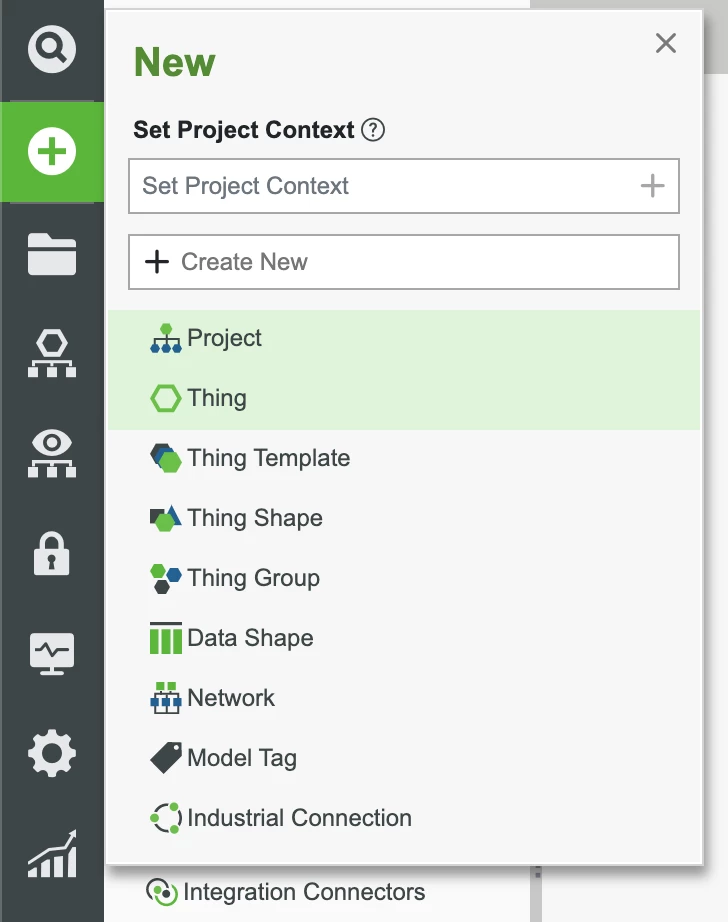

  2. Select Thing in the dropdown.

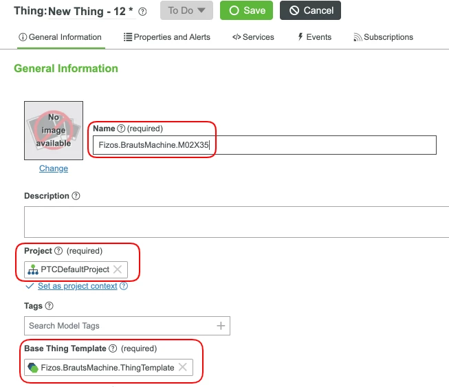

  3. Set the Project (ie, PTCDefaultProject) and in the name field, enter Fizos.BrautsMachine.M02X35.
  4. In the Base Thing Template field, enter Fizos.BrautsMachine.ThingTemplate.
  5. Click Save.

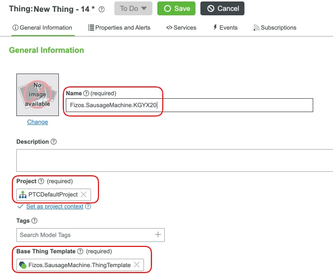

6. In the ThingWorx Composer, click the + New in the top left of the screen.
7. Select Thing in the dropdown.
8. In the name field, enter Fizos.SausageMachine.KGYX20.
9. In the Base Thing Template field, enter Fizos.SausageMachine.ThingTemplate.
10, Click Save.

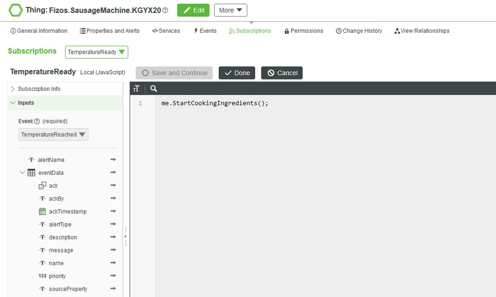

Creating Cooking Subscriptions
These steps will need to be in both of the entities we just created.
  1. Switch to the Subscriptions tab and add a new subscription.
  2. Name this new subscription TemperatureReady and select TemperatureReached as the event input.
3. Add the following code to the source section:
//The temperature is high enough. Start cooking
me.StartCookingIngredients();
You now have a system (when enabled) will run every three hours. It will start our secret cooking process (that can be added in the service or created remotely).
