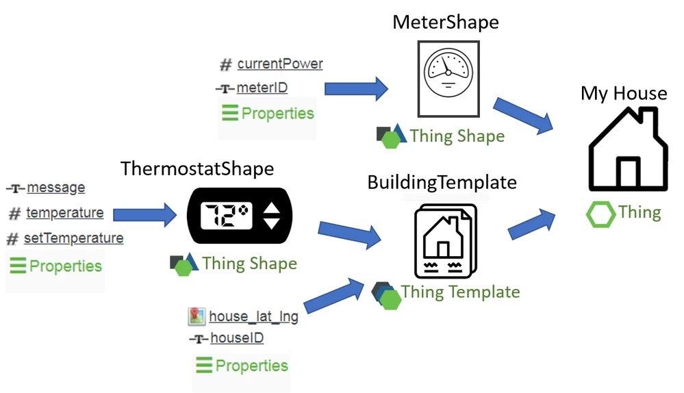

In this tutorial, we will develop an application for a house including a thermostat, an electrical meter, and a sensor data simulator. We will demonstrate how to capture, store, and visualize data using the ThingWorx Foundation Server.
You will create Thing Shapes that model both a thermostat and an electric meter. You will then create a Thing Template that represents a house based on these shapes and other Properties.

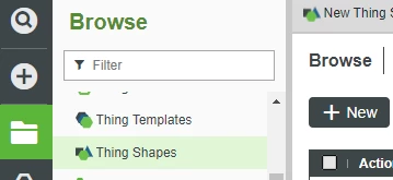

  1. Start on the Browse, folder icon tab of ThingWorx Composer.
  2. Under the Modeling section of the left-hand navigation panel hover over Thing Shapes, then click the + button.

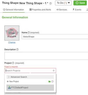

  3. Type MeterShape in the Name field.
NOTE: Thing Shape names are case sensitive
4. If Project is not already set, choose PTCDefaultProject.
5. Click Save.

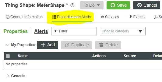

Add Properties
  1. Click Properties and Alerts tab at the top of your shape.IoTProductMgmt_3-1659618086232.png
  2. Click + Add.

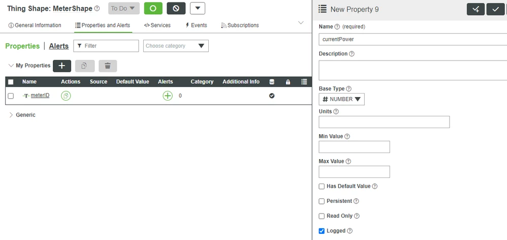

  3. Enter the property name from the first row of the table below into the Name field of the Thing Shape
Name
Base Type
Persistent?
Logged?
meterID
STRING
X
currentPower
NUMBER
X
costPerKWh
NUMBER
X
X
currentCost
NUMBER
4. Select the Base Type from the drop-down menu that is listed in the table next to the Property name.IoTProductMgmt_4-1659618086234.png
5. Check Persistent and/or Logged if there is an X in the table row of the Property.
NOTE: There is a new Index checkbox that is unique to Thingworx 9.3. Users will be able to run high performant quick “search” queries across thousands of connected  assets​. In addition, they can pre-filter query resultsets for better overall query performance leveraging database Indexing capabilities.
NOTE: When Persistent is selected, the property value will be retained when a Thing is restarted. Properties that are not persisted will be reset to the default during a restart. When Logged is selected, every property value change will be automatically logged to a specified Value Stream.
6. Click + button.
TIP: When adding multiple properties at once, click Done and Add after each, once you've entered a Name, selected a Base Type and any other criteria. If adding a single property, click Done.
7. Repeat steps 2 through 6 for each of the properties in the rows of the table.

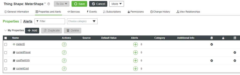

       8. Click the done  Button. You'll see that these Properties have been created for the Meter Thing Shape.
9. Click Save.

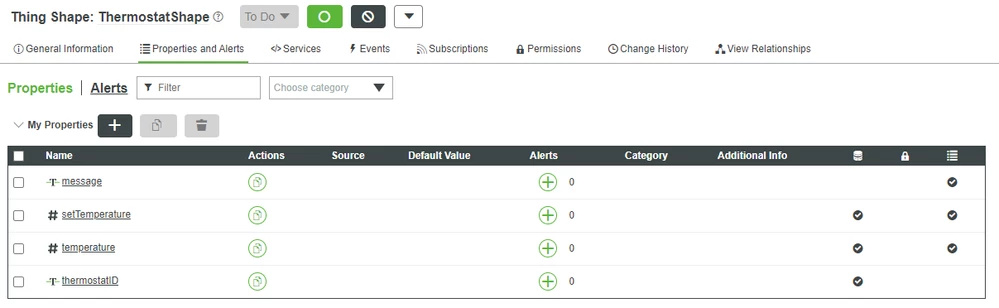

4. Select the Properties and Alerts tab at the top.
5. Click + Add and create the following properties following the same steps as before:
Name
Base Type
Persistent?
Logged?
thermostatID
STRING
X
temperature
NUMBER
X
X
setTemperature
NUMBER
X
X
message
STRING
X
6. Click Save. You'll see that these Properties have been created for the Thermostat Thing Shape.

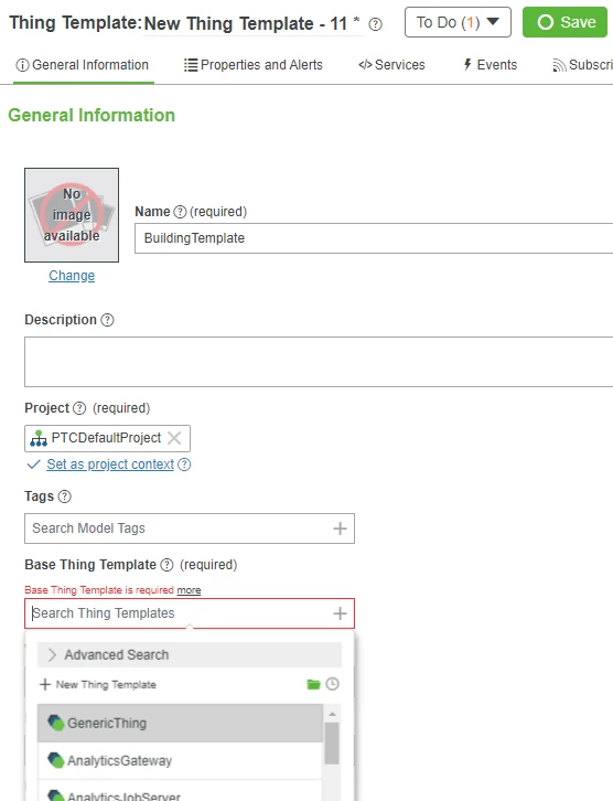

  3. Type BuildingTemplate in the Name field.
NOTE: Thing Template names are case sensitive
      4. If Project is not already set, click the + in the Project text box and select the PTCDefaultProject.

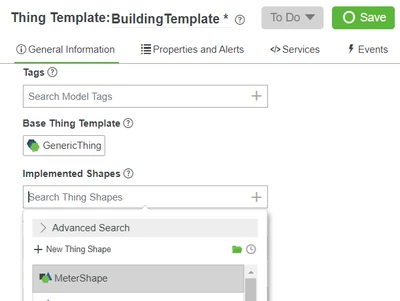

      5. In the Base Thing Template box, click + to choose GenericThing as the Template.IoTProductMgmt_9-1659618086240.png
      6. In the Implemented Shapes field, click the + to select the MeterShape Thing Shape.IoTProductMgmt_10-1659618086242.png
7. Click Save.

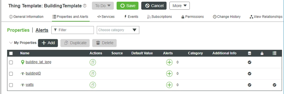

Add Properties
In this step, you will specify the Properties that represent the characteristics of a building. Some Properties like the building location may never change (static), while other properties like power and temperature information may change every few seconds (dynamic).

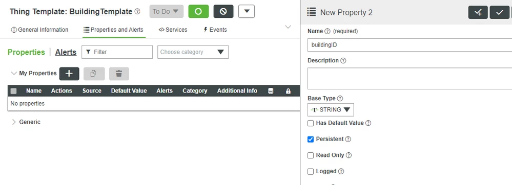

  1. Select the Properties and Alerts tab under Thing Template: BuildingTemplate.IoTProductMgmt_11-1659618086243.png
  2. Click the Edit button if the Template is not already open for editing, then click + Add next to My Properties.
  3. Enter the property name in the Name field copied from a row of the table below,
  4. Select the Base Type of the property from the drop down menu.
NOTE: When Persistent is selected, the property value will be retained during a system restart. Properties that are not persisted will be reset to the default during a system restart. When Logged is selected, every property value change will be automatically logged to a specified Value Stream.
6. Click the + button.
TIP: When adding multiple properties at once, click Check+ after each, once you've entered a Name, selected a Base Type and any other criteria. If adding a single property, click Check button.
7. Repeat steps 3 through 6 for each of the properties in the rows of the table.
Name
Base Type
Persistent
Logged
buildingID
STRING
x
building_lat_long
LOCATION
x
watts
NUMBER
x
x
8. After entering the final property, click the  button.
9. Click Save.
You should see the following properties in your Composer.
