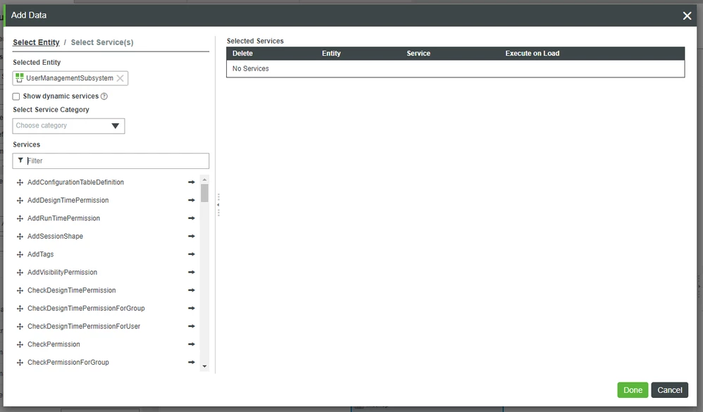

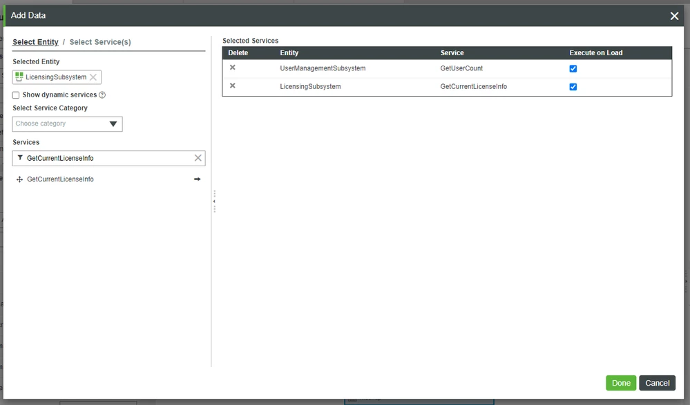

Step 5: Add Data
Now that our Mashup's Layout and Widgets have been set, we need to bring in backend data and tie it to those Widgets for display.

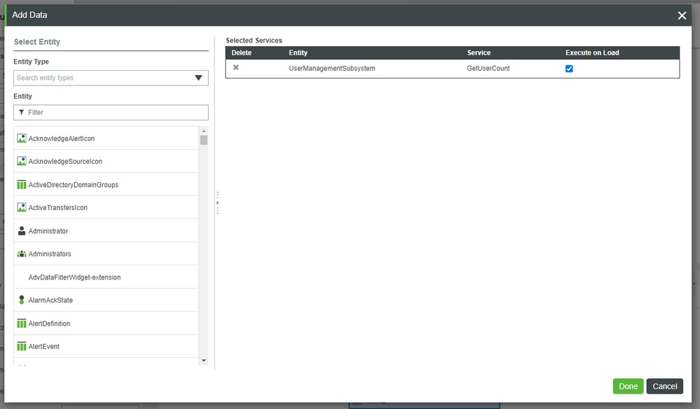

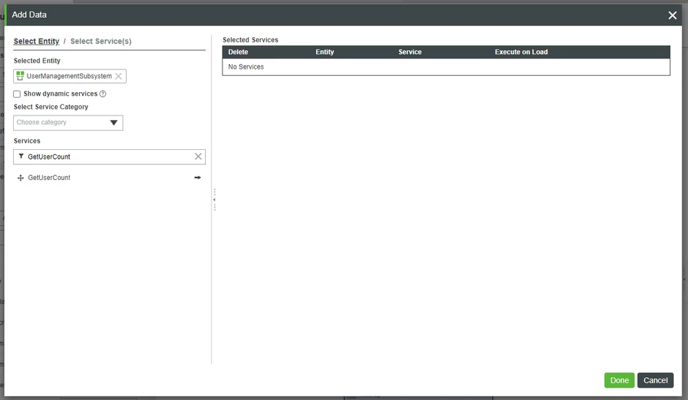

We'll make use of Mashup Data Services for this. The first one we'll add will be UserManagementSubsystem > GetUserCount.

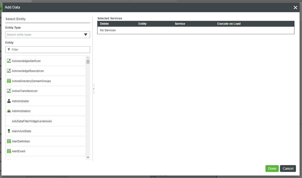

- Ensure that the Data tab in the top-right is active.
- Click the + icon.
- In the Entity field, search for and select UserManagementSubsystem.

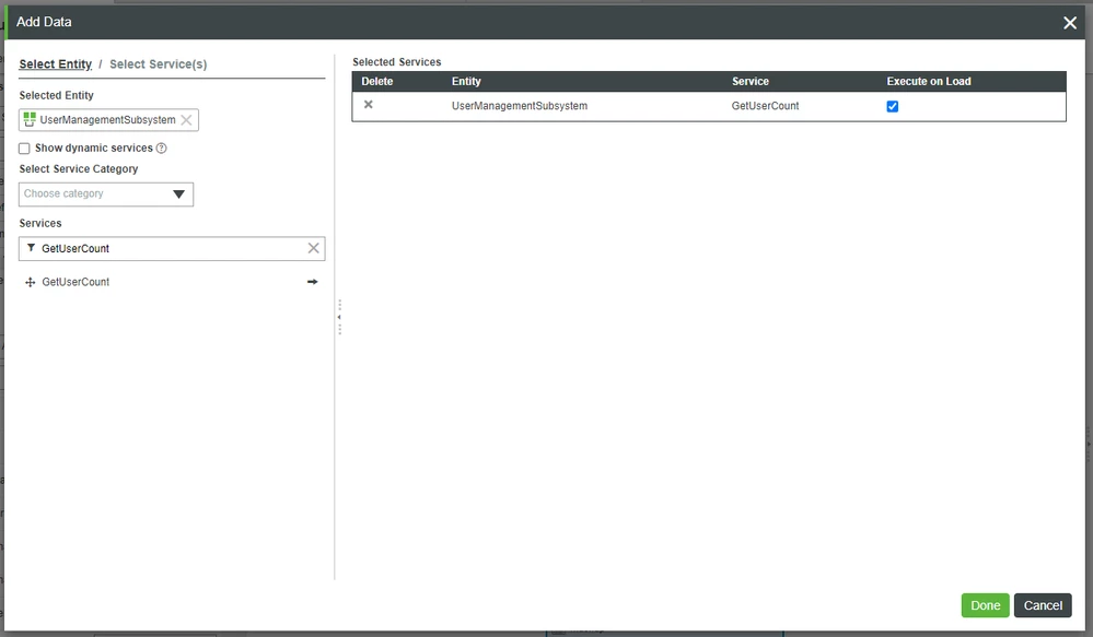

- In the Services field, type GetUserCount.
- Beside the GetUserCount Service, click the right arrow.
- Under Selected Services, check the box for Execute on Load.

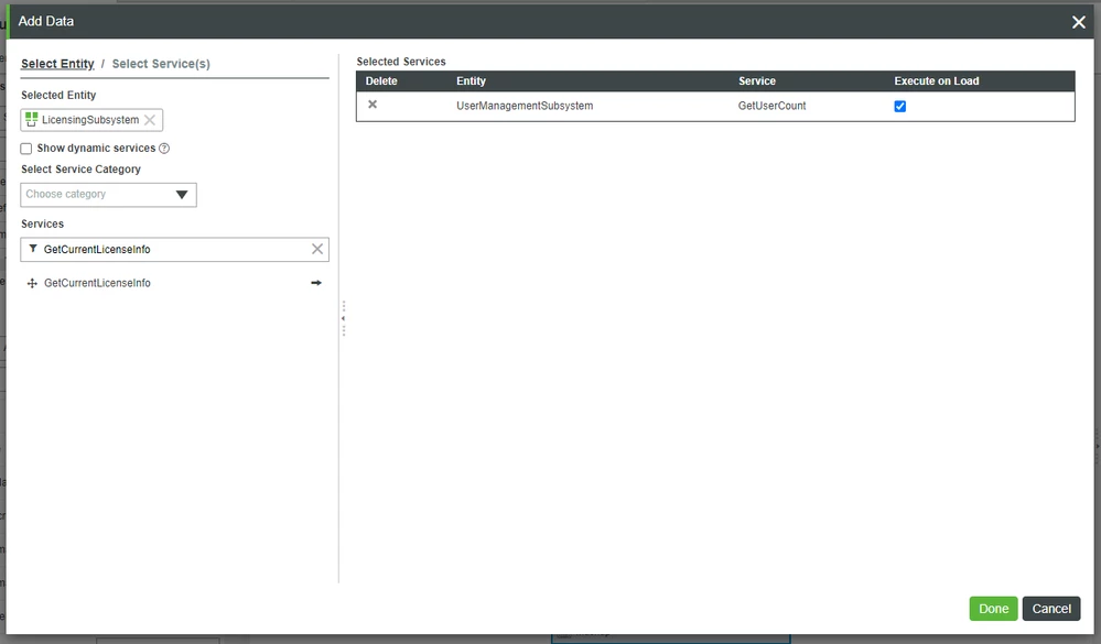

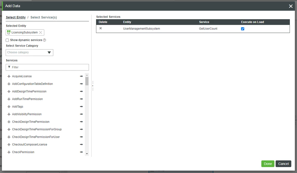

Add LicensingSubsystem > GetCurrentLicenseInfo
You're not limited to only pulling information from one Mashup Data Service.
We already have User Management's GetUserCount. We'll now also bring in information from the Licensing Subsystem.
- On the same Add Data pop-up, click the X beside UserManagementSubsystem to clear it.
- In the Entity field, search for and select LicensingSubsystem.
- In the Services field, type GetCurrentLicenseInfo.
- Beside GetCurrentLicenseInfo, click the right arrow.
- Under Selected Services on the GetCurrentLicenseInfo line, check the box for Execute on Load.
- On the bottom-right of the pop-up, click Done.
- At the top, click Save.

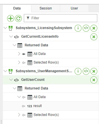

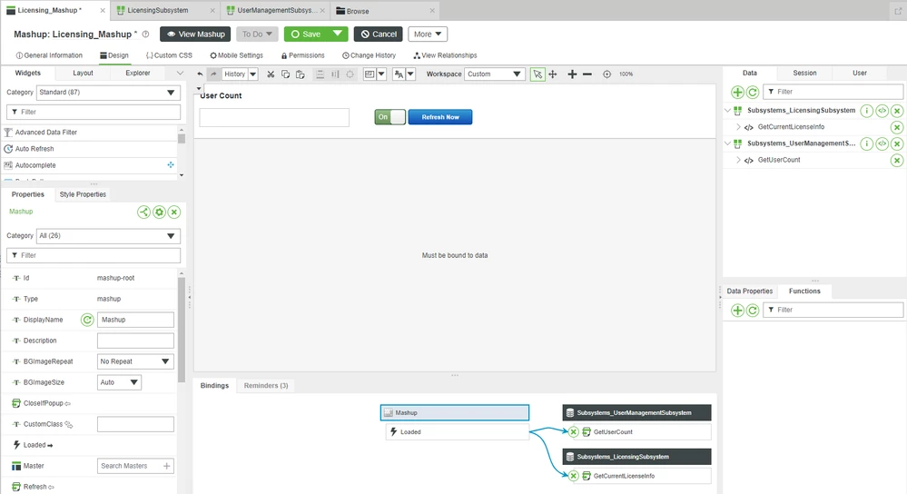

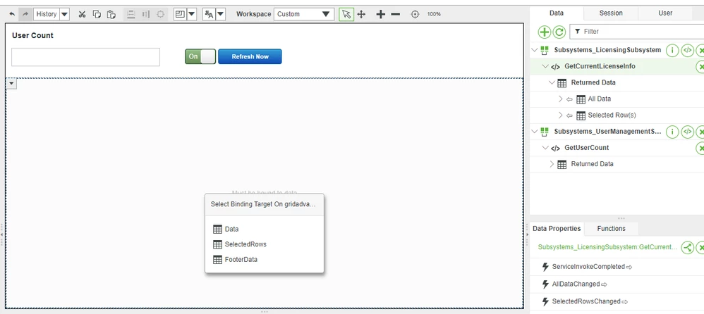

Bind Data
With our backend data now accessible, let's bind it to our Widgets for display.

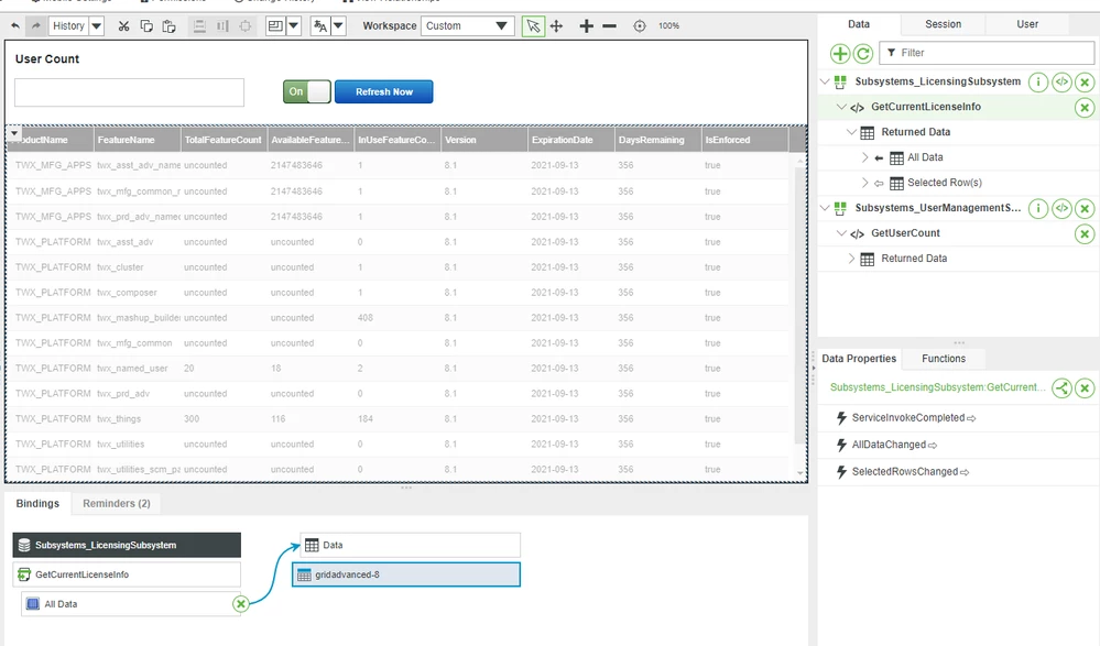

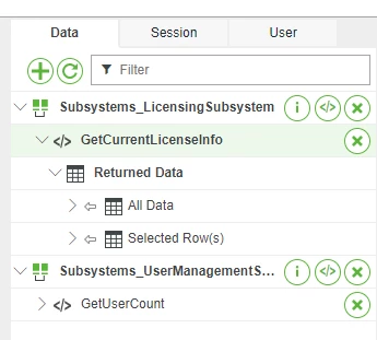

- On the Data tab, expand Subsystems_LicensingSubsystem > GetCurrentLicenseInfo > Returned Data.
- Drag-and-drop Licensing's All Data onto the Grid Advanced Widget in the bottom section.
- On the Select Binding Target pop-up, click Data.

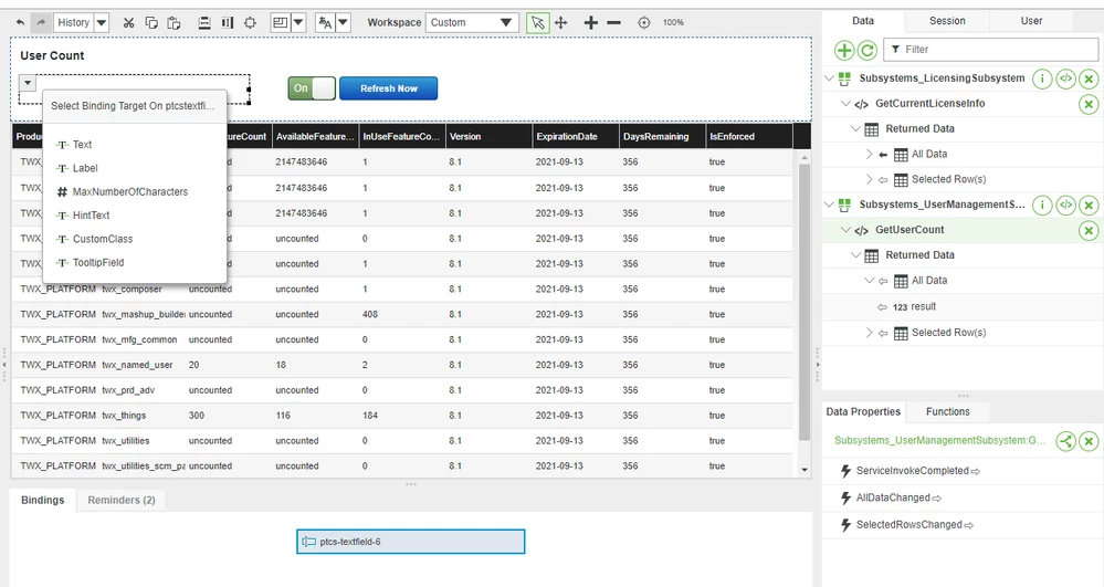

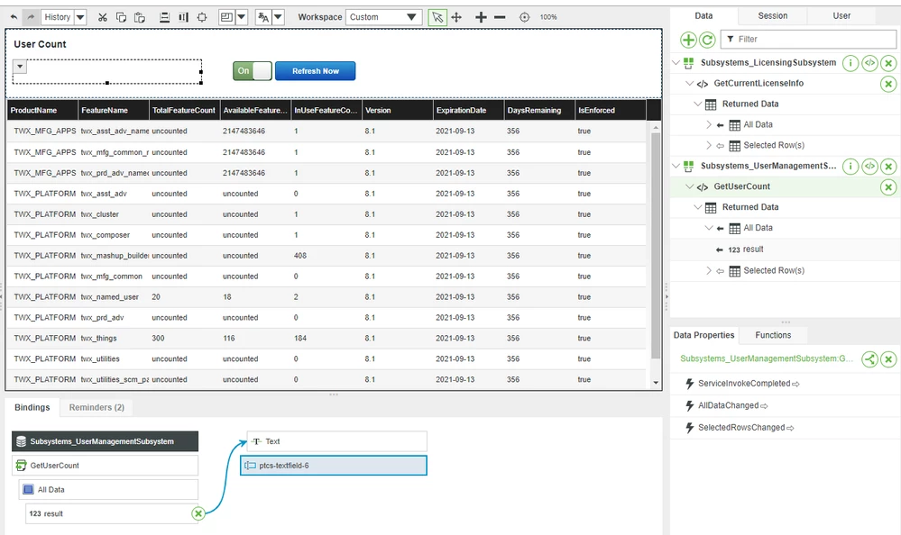

- Expand Subsystems_UserManagementSubsystem > GetUserCount > Returned Data > All Data.
- Drag-and-drop User Management's result onto the Text Field Widget in the top section.
- On the Select Binding Target pop-up, click Text.

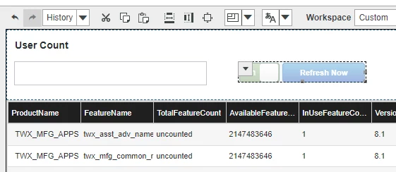

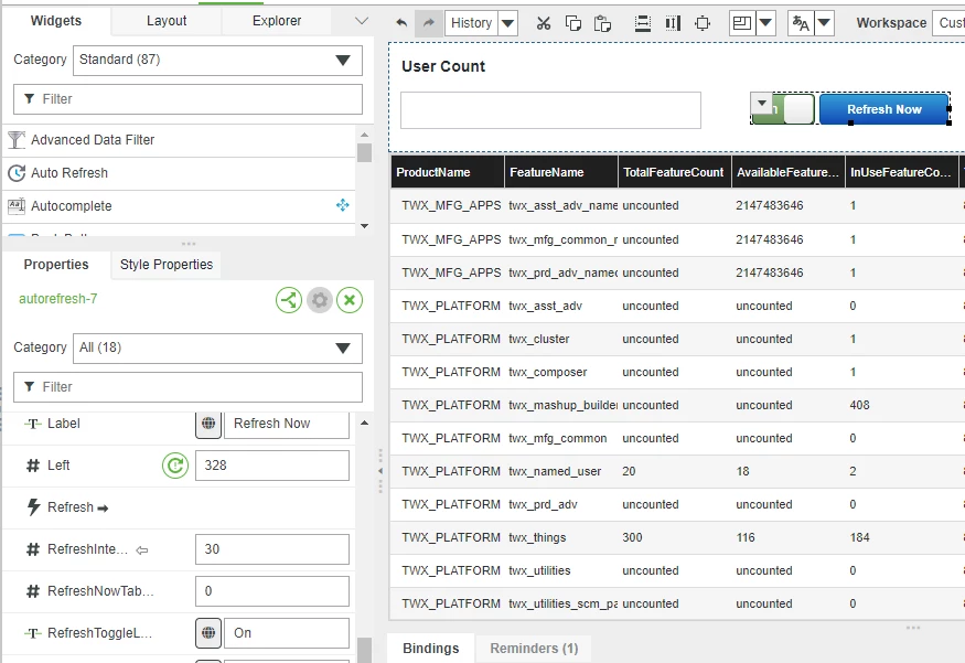

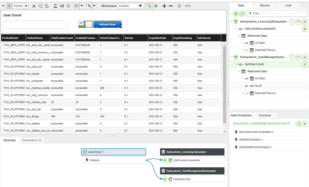

Automatically Refresh
If we were to click View Mashup now, we would see the User Count and Licensing info displayed in the Mashup's Widgets. However, it would never update unless we manually refreshed the page.
To automate that process, we'll use the Auto Refresh Widget.

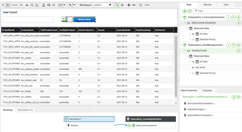

- In the top section of the Mashup, click the Auto Refresh Widget to select it.
- On the top-left of the Auto Refresh Widget, click the drop-down icon to reveal additional options.
- Drag-and-drop the Refresh Event onto GetCurrentLicenseInfo.
- Repeat steps 1-3 to drag-and-drop the Refresh Event onto GetUserCount also.

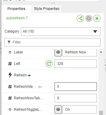

- With the Auto Refresh Widget still selected, browse the Properties section in the bottom-left.
- Change RefreshInterval to 5, and hit your keyboard's Tab key to lock in the change.
- This will cause the Refresh Event to fire every 5 seconds.
- Click Save.
- Click View Mashup.

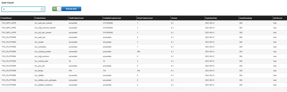

Step 6: Replace License
We have now created a Minimum Viable Product (MVP) of a "licensing dashboard" to ease our administration work.
This dashboard could still be improved. For instance, a Mashup Function could be created which automatically recalculates the value from GetUserCount to more accurately match GetCurrentLicenseInfo. This can be accomplished via the Mashup Builder's bottom-right Functions tab. Or, you could even add a separate Text Field Widget to to the top section and directly access the remaining license time via the LicensingSubsystem > GetDaysRemainingInLicense Service.

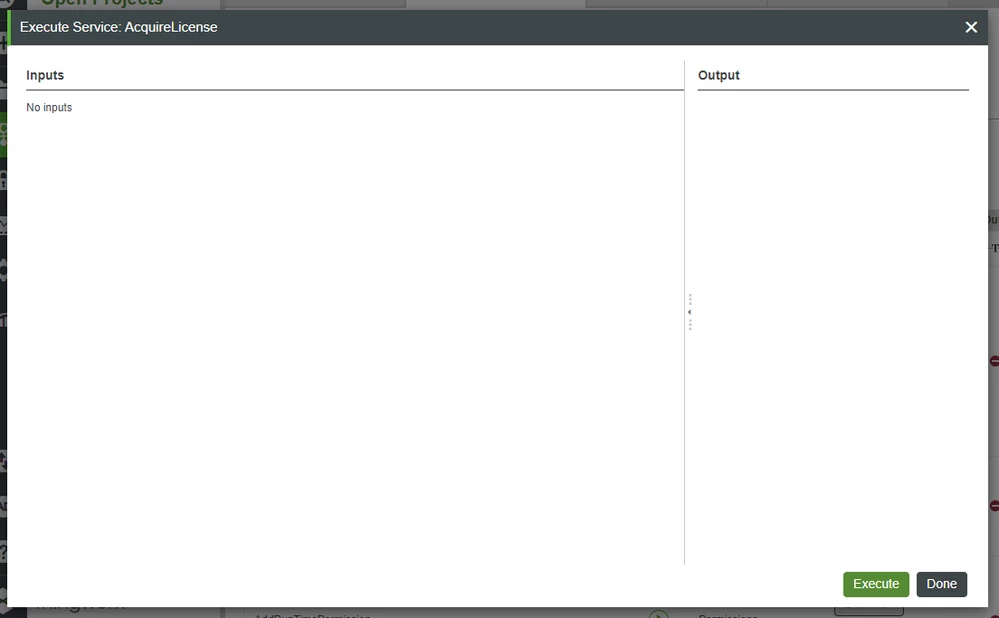

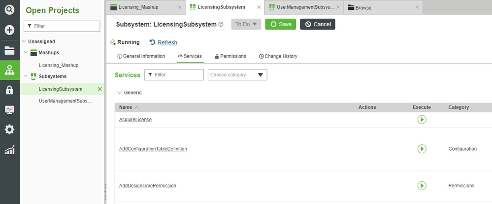

- In Foundation, navigate to the LicensingSubsystem > Services page.
- On the AcquireLicense row, click the "play" icon for Execute Service.
- On the bottom-right of the pop-up, click Execute.
- Note that if you receive an error, it will be necessary to restart the ThingWorx Tomcat service. The act of restarting the service will automatically load the new license.
- To close the pop-up, click Done.
