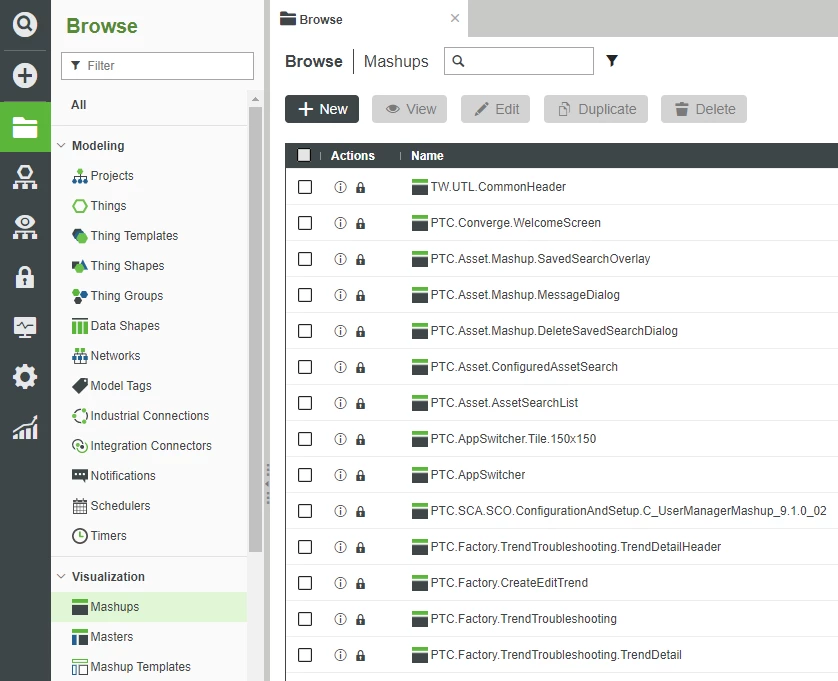

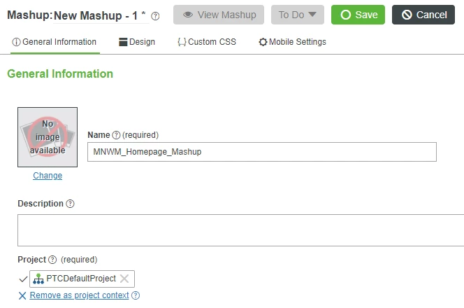

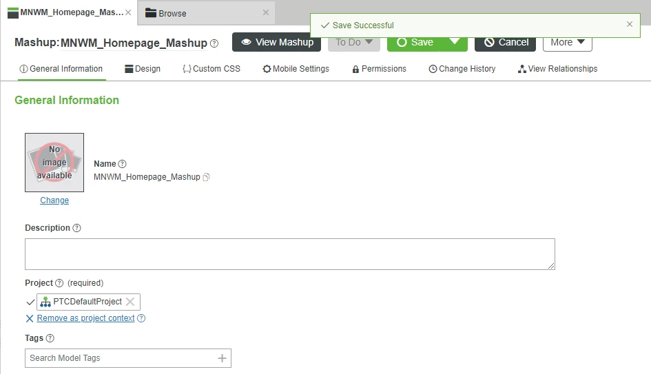

- In Foundation, click Browse > Visualization > Mashups.
- At the top-left, click +New.
- Leave the defaults and click OK.
- In the Name field, type MNWM_Homepage_Mashup.
- If Project is not already set, search for and select PTCDefaultProject.
- At the top, click Save.

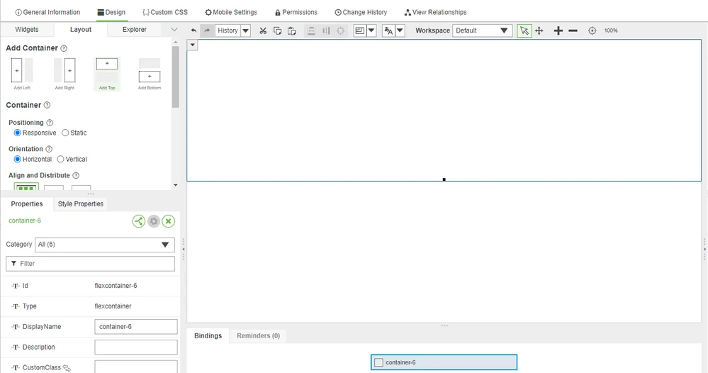

We know we'll want our company's name, i.e. LightCo, and probably an image, login, or something else below. So let's subdivide the Mashup into a smaller top part for the name and a bigger bottom section for future functionality.

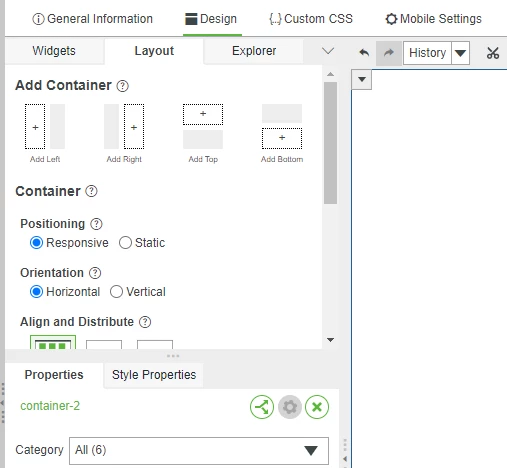

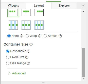

- In the top-left, ensure that the Layout tab is active.
- Click Add Top.

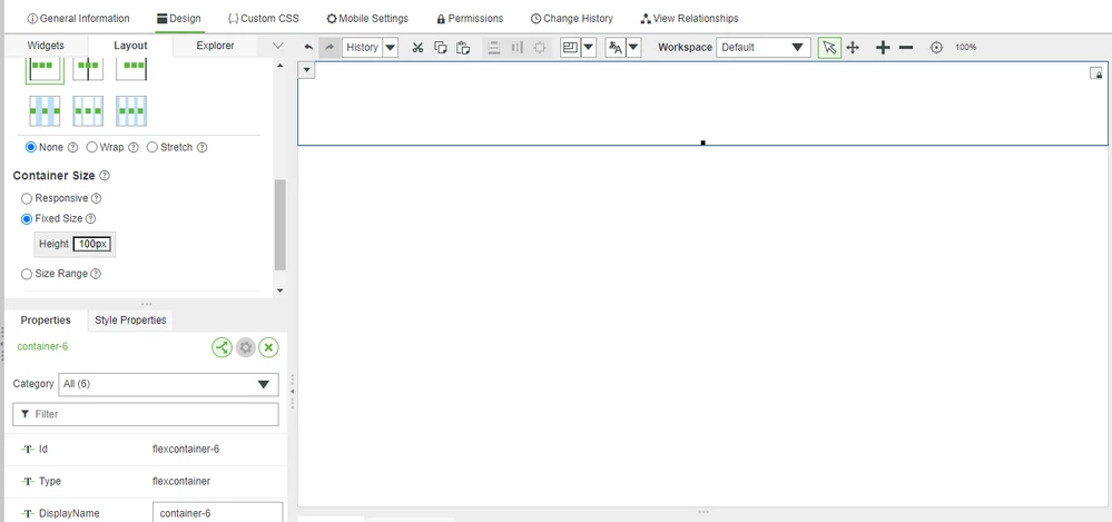

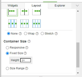

- Scroll down in the Layout tab to reveal Container Size.
- With the top-section of the Canvas selected, click Fixed Size.
- In the Height field, type 100 and hit your keyboard's Tab key to apply the change.
- Click Save.

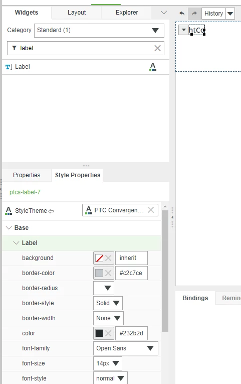

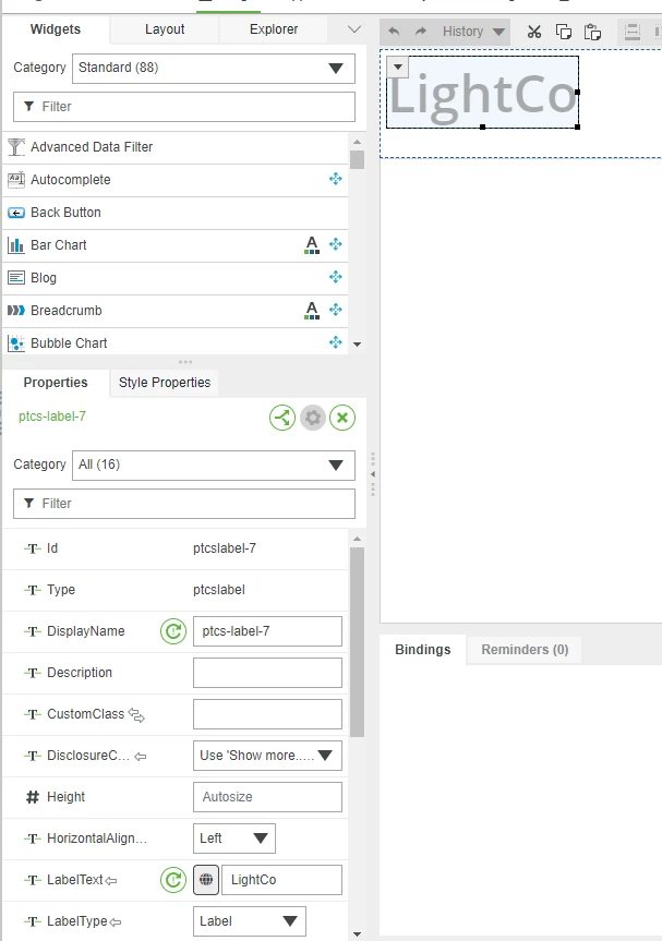

In the top section, we'll add a Label Widget for our company's name.

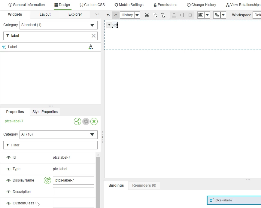

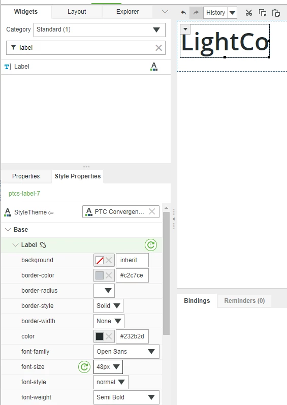

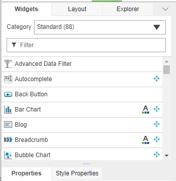

- At the top-left, click the Widgets tab.

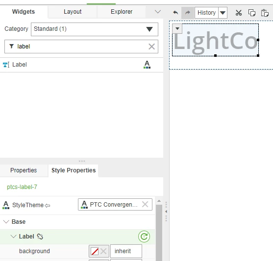

- Drag-and-drop a Label Widget onto the top section of the Canvas.

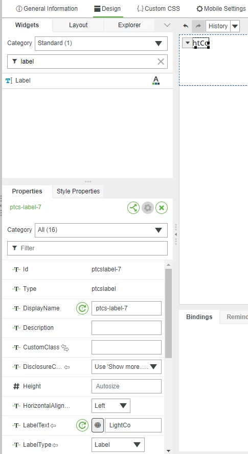

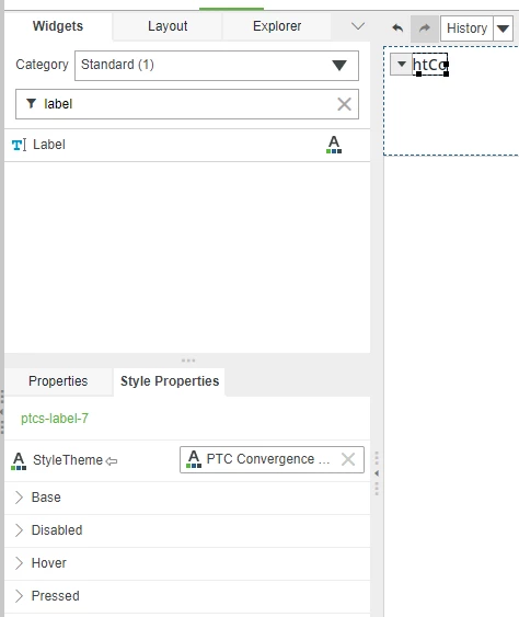

- With the Label Widget selected, in the bottom-left Properties tab, change LabelText to LightCo and hit your keyboard's Tab key to apply it.
- With the Label Widget still selected, in the bottom-left, click the Style Properties tab.
- Under Style Properties, expand Base > Label.
- Change font-size to 48px.
- Click Save.

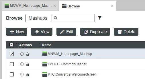

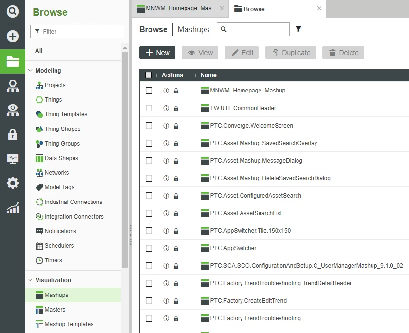

- Return to Browse > Mashups.
- To the left of MNWM_Homepage_Mashup, click the checkbox.
- At the top, click Duplicate.

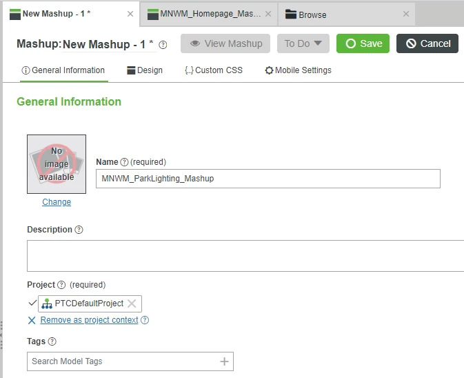

- In the Name field, type MNWM_ParkLighting_Mashup.

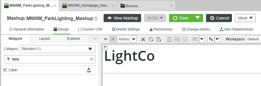

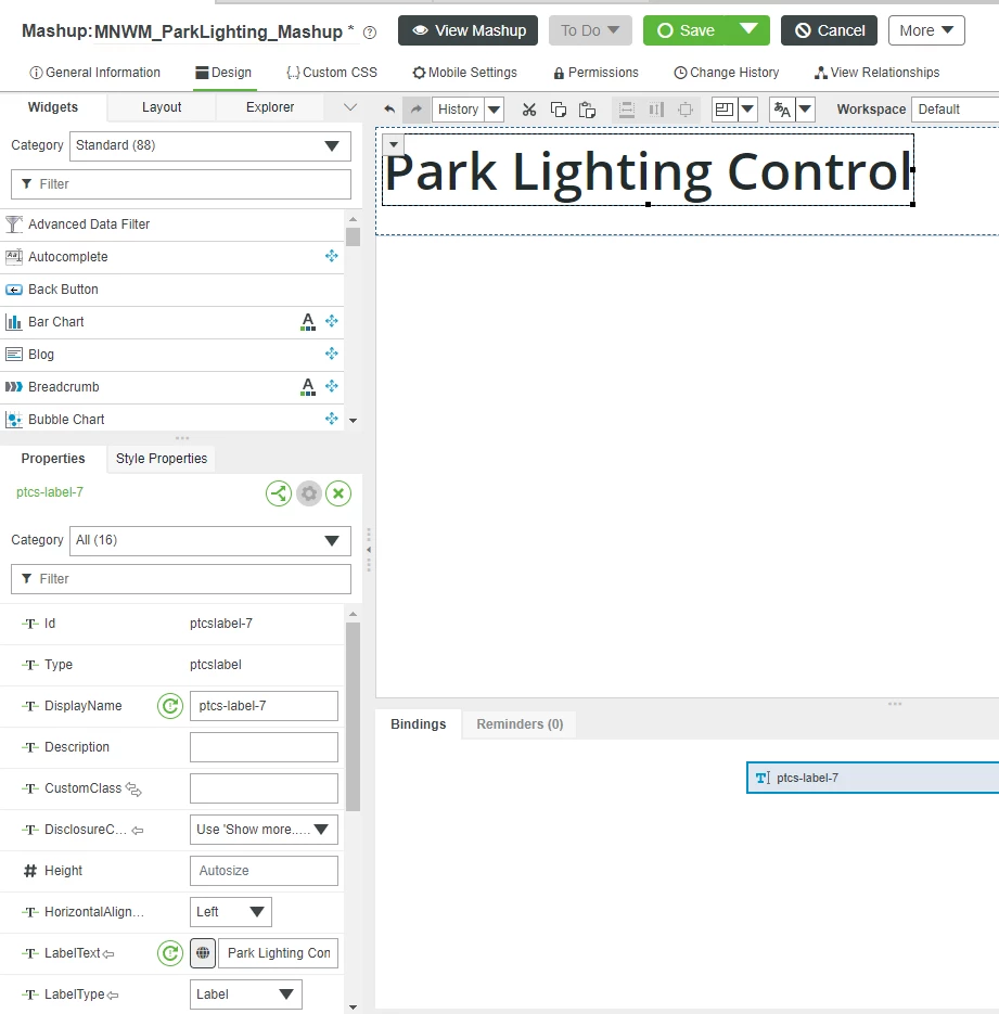

Change Label Title
Since we used Duplicate to clone the homepage, we see the same header/page Layout which we previously designed. That Layout can be useful for separating page-titles from functionality, so let's keep it.
But we also see the LightCo LabelText we previously created. Since this is the Park Lighting Control page, we need to change it.
- In the top section of the Canvas, click the Label Widget to select it.
- In the bottom-left, return to the Properties tab.
- In the LabelText field, replace the current text with Park Lighting Control, and hit your keyboard's Tab key to apply the change.

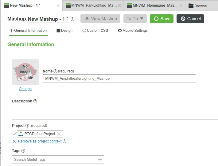

- In the Name field, type MNWM_AmphitheaterLighting_Mashup.

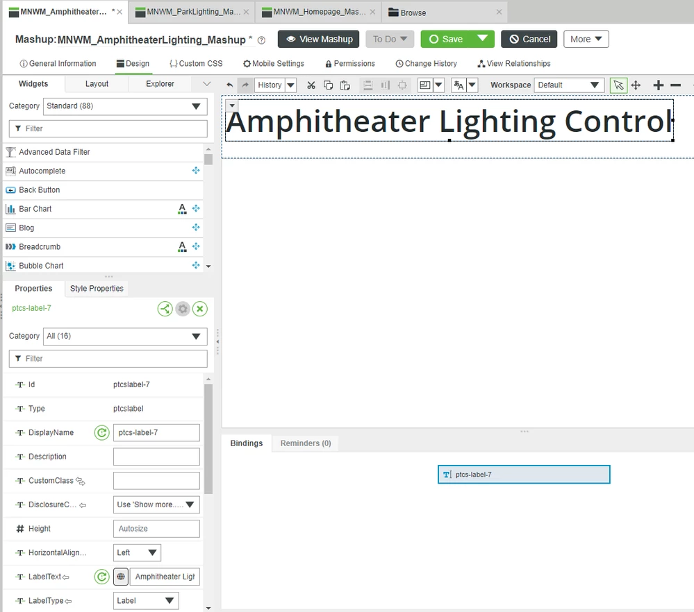

Change LabelText
Just as we did with the Park Lighting Control LabelText, we now want to change this duplicate to read Amphitheater Lighting Control.
- In the bottom-left, return to the Properties tab (if you're not already there).
- In the LabelText field, replace the current text with Amphitheater Lighting Control, and hit your keyboard's Tab key to apply the change.
- Click Save.

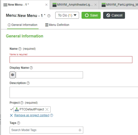

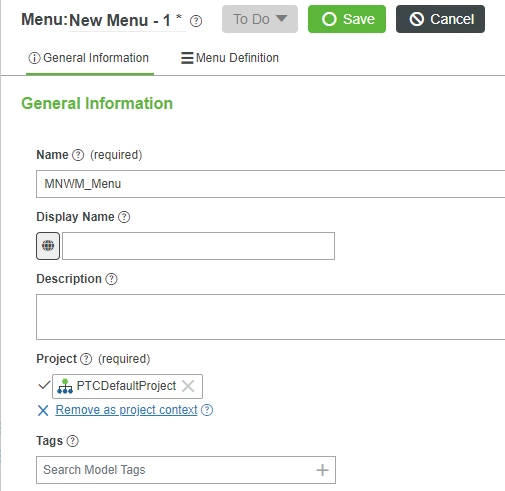

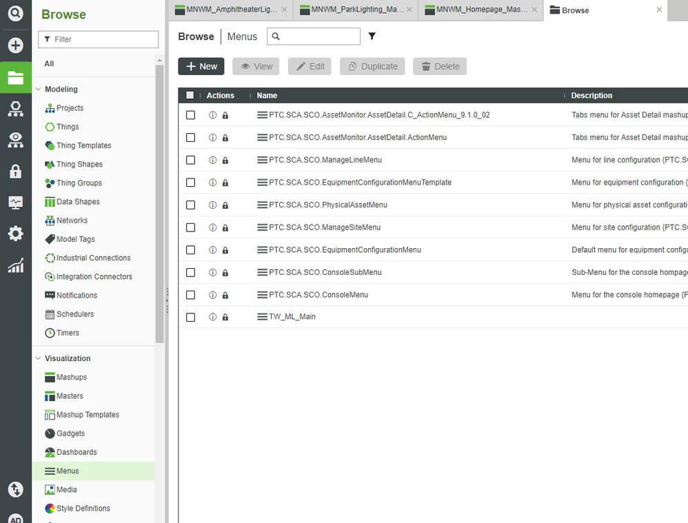

- Navigate to Browse > Visualization > Menus.
- Click +New.

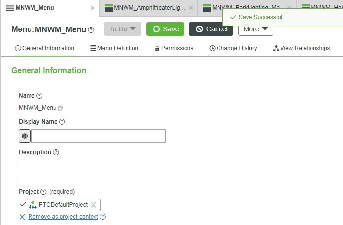

- In the Name field, type MNWM_Menu.

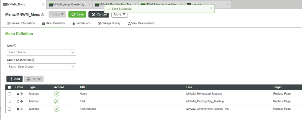

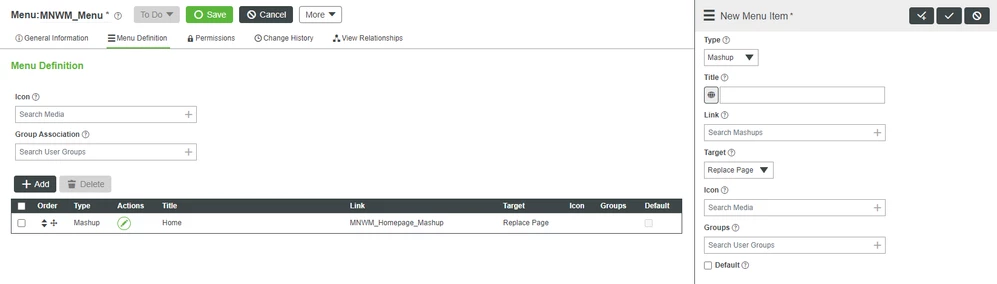

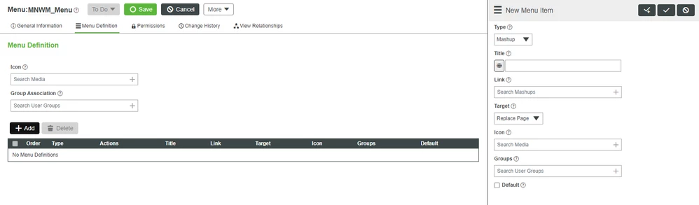

Menu Definitions
Now that we have created the Menu Entity, we can add Menu Definitions with links to all the previously-created pages.

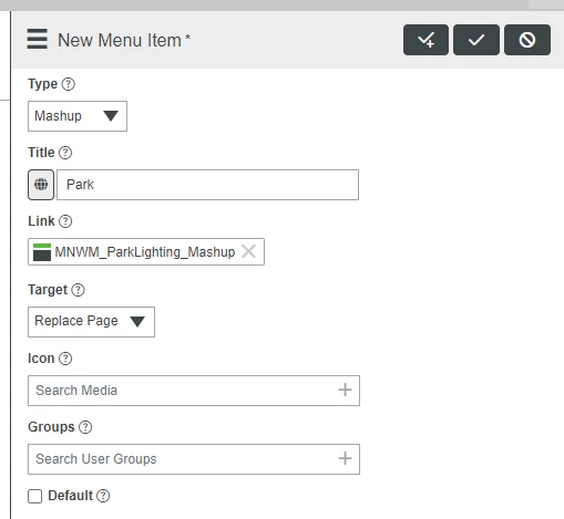

- At the top, click Menu Definition.
- Click +Add.

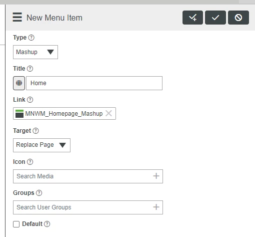

- On the right-side slide-out, in the Title field, type Home.
- In the Link field, search for and select MNWM_Homepage_Mashup.
- In the top-right, click the "check with a plus" button for Done and Add.
- In the Title field, type Park.
- In the Link field, search for and select MNWM_ParkLighting_Mashup.

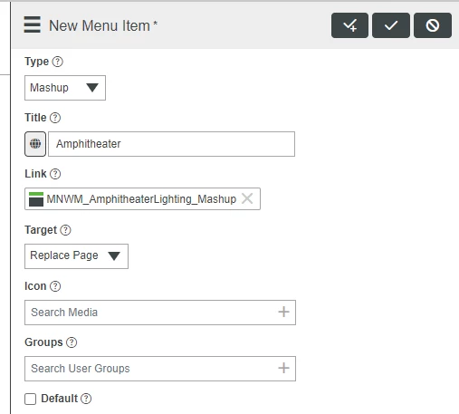

- In the Title field, type Amphitheater.
- In the Link field, search for and select MNWM_AmphitheaterLighting_Mashup.
- At the top-right, click the "check" button for Done.
