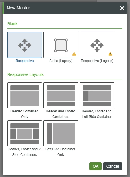

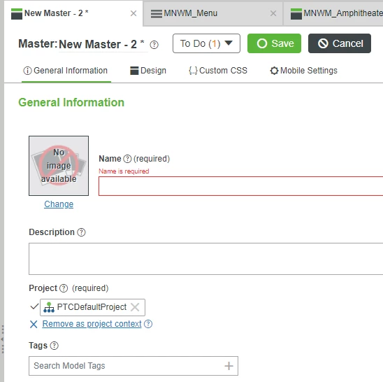

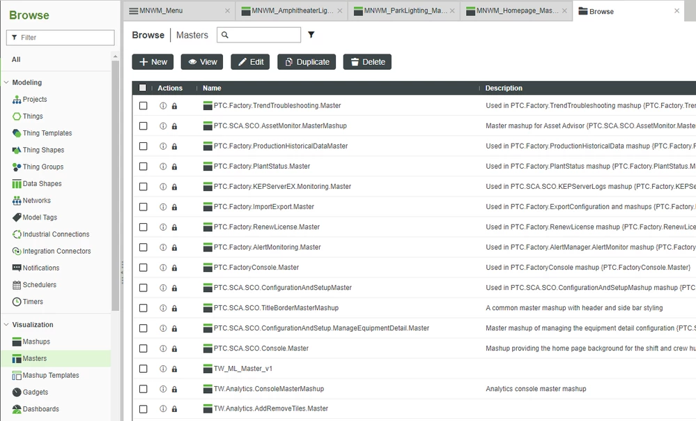

  1.  Navigate to Browse > Visualization > Masters.
  2.  Click +New.
  3.  Leave the defaults and click OK.

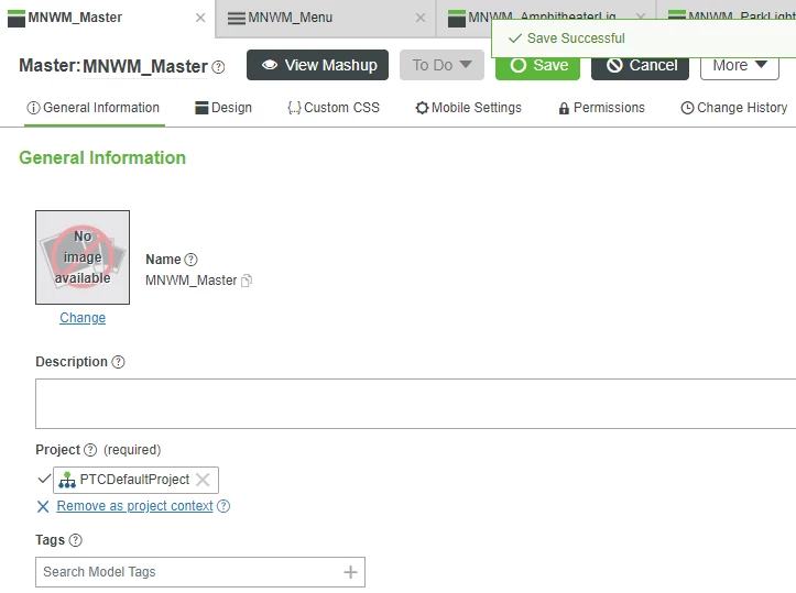

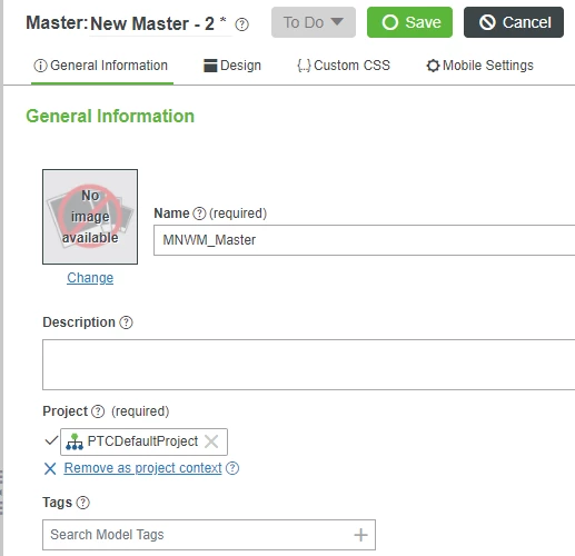

  4.  In the Name field, type MNWM_Master.
  5. If Project is not already set, search for and select PTCDefaultProject.
  6.  At the top, click Save.

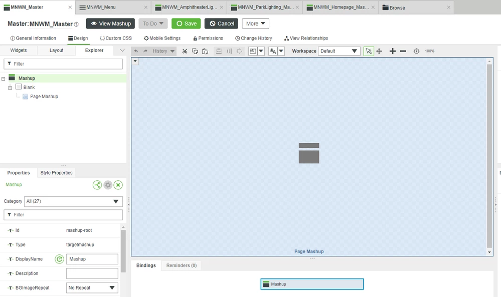

  7.  At the top, click Design.

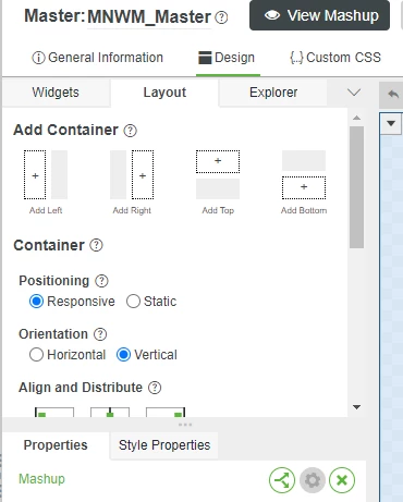

Add Header
Now that we've created the Master Entity, we need to add space for the Menu Widget.

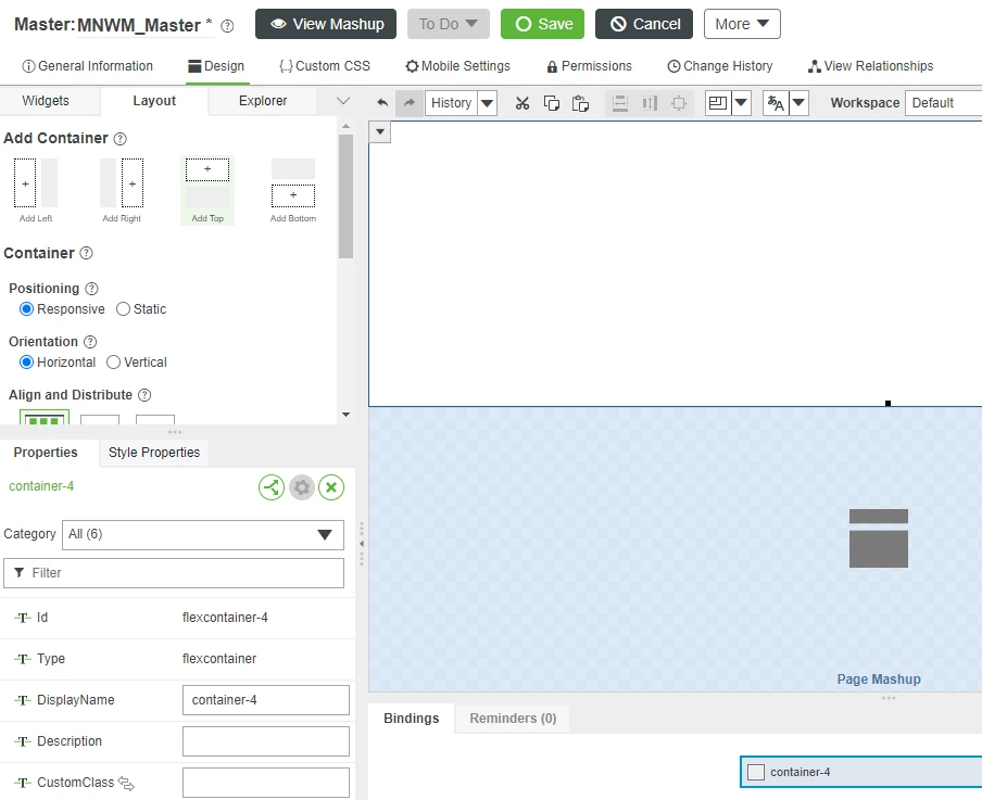

  1. At the top-left, click the Layout tab.
  2.  Click Add Top.

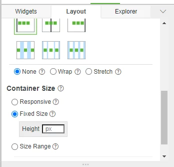

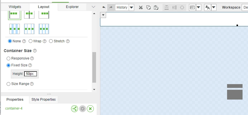

  3. With the new top-section still selected, scroll down in the Layout tab, and select Container Size > Fixed Size.
  4. In the new Height field, type 50, then hit your keyboard's Tab key to apply the change.
  5.  At the top, click Save.

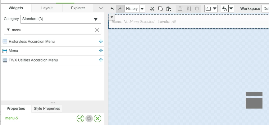

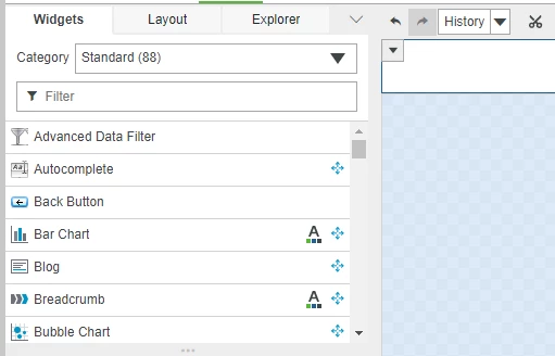

  1. In the top-left, click the Widgets tab.

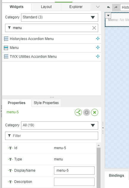

  2. Drag-and-drop a Menu Widget onto the top Canvas section.

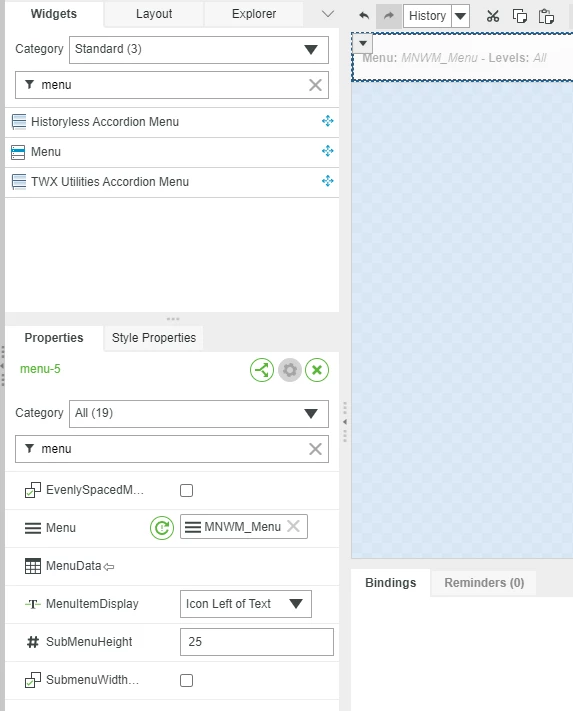

  3. Ensure the Menu Widget is still selected, as well as the Properties tab in the bottom-left.

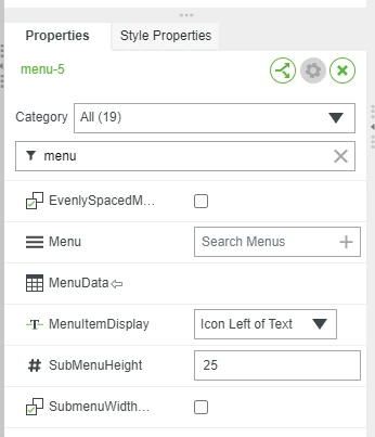

  4. In the Filter field, type menu.
  5. For the Menu Property, search for and select MNWM_Menu.

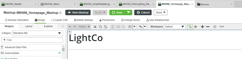

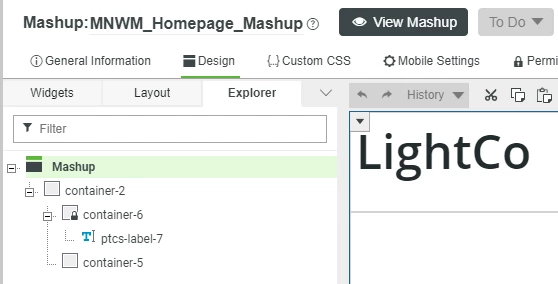

  1.   Return to MNWM_Homepage_Mashup.

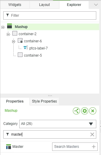

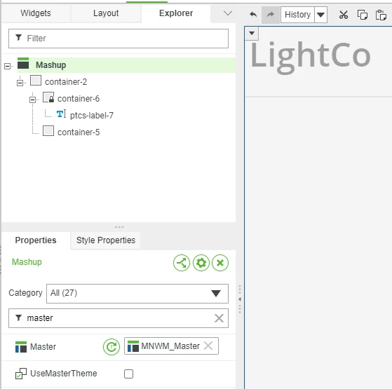

  2.  In the top-left, click the Explorer tab.
  3. Ensure that Mashup is selected.
  4. On the bottom-left Properties tab, in the Filter field, type master.
  5. For the Master Property, search for and select MNWM_Master.
  7. At the top, click View Mashup.

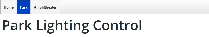

  8. Click Park.

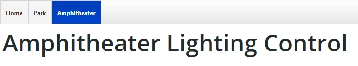

  9. Click Amphitheater.
Note that you may wish to set MNWM_Master for the other pages of your application, just in case anyone were to navigate directly there via URL. But simply setting it on the homepage is enough for us to see that Menu navigation is functioning correctly.
