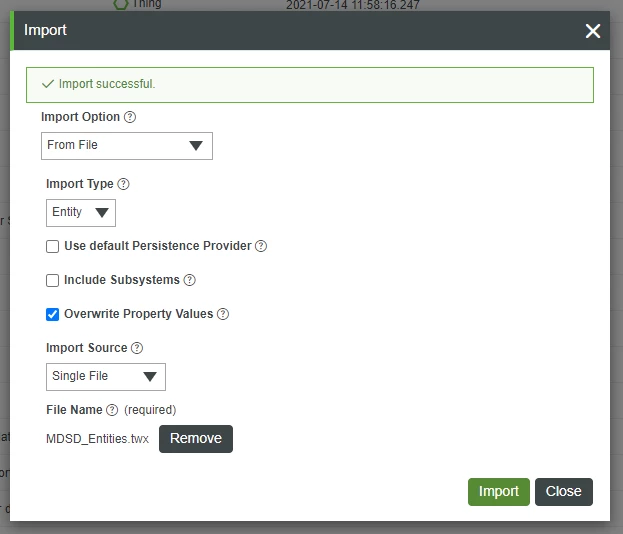

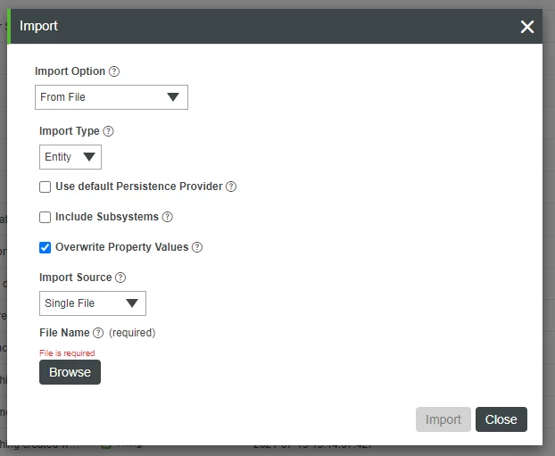

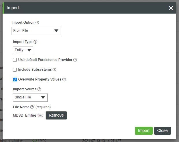

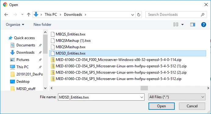

  1. Download and unzip the MDSD_Entities.zip file attached to this article.

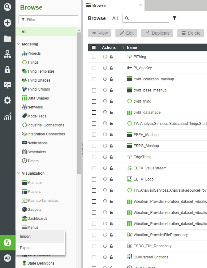

  2. In the bottom-left of Foundation Composer, click Import/Export.
  3. Click Import.
  4. On the Import pop-up, click Browse.
  5. Navigate to the download location and select the MDSD_Entities.twx file.
  6. Click Open.
  7. Click Import.
  8. Click Close.

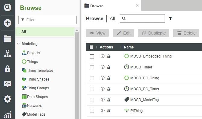

Note how there are now several MDSD Entities. These represent Things connected to different parts of the MRI which are communicating to Foundation via the EMS Agent (as per the previous guides in this Learning Path).

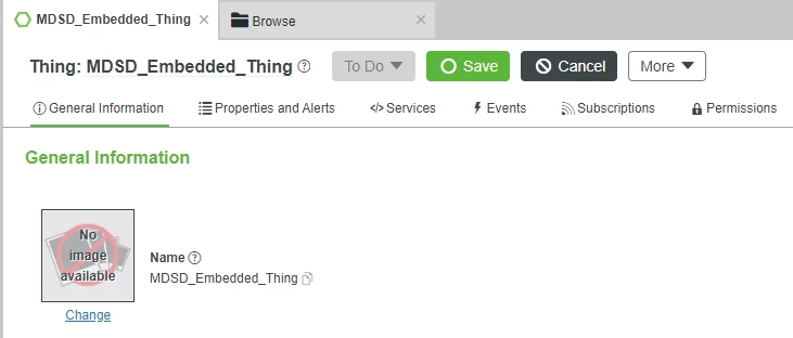

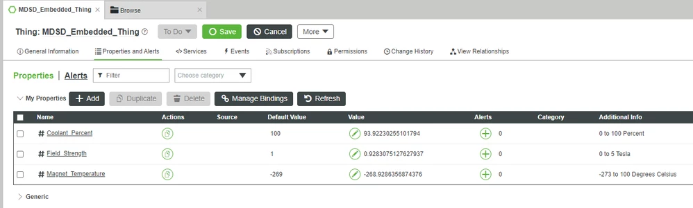

  1. Click MDSD_Embedded_Thing.
  2. Click Properties and Alerts.
So the embedded microcontroller has sensors which are tracking the following:
 Property                           Units                       Description
Coolant PercentPercentAmount of coolant left to refrigerate the super-conducting magnets
Field StrengthTeslaStrength of the magnetic field
Magnet TemperatureDegrees CelsiusTemperature of the magnets

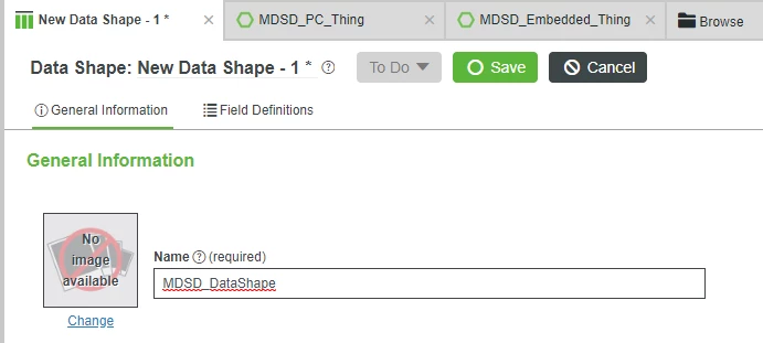

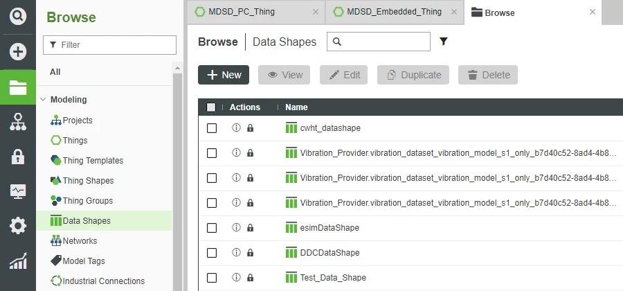

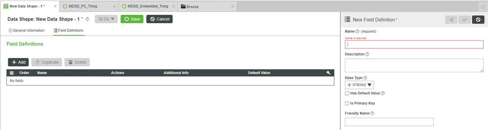

  1. Click Browse > Modeling > Data Shapes.
  2. Click + New.
  3. In the Name field, type MDSD_DataShape.
  4. If Project is not already set, search for and select PTCDefaultProject.

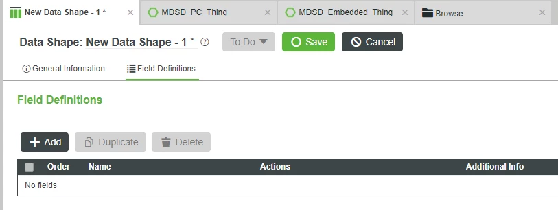

  5. At the top, click Field Definitions.
  6. Click + Add.

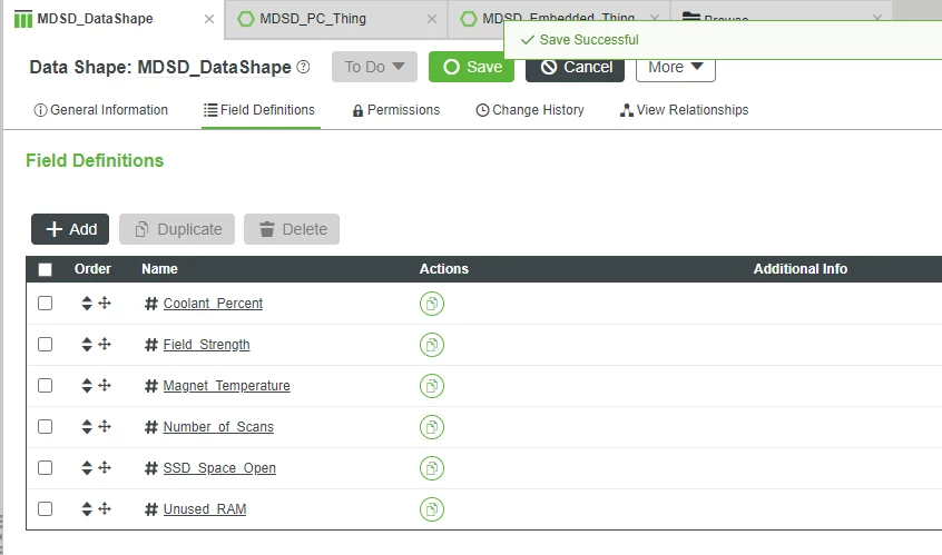

We now want to add Field Definitions to the Data Shape which map the information that we want to collate between the various sub-systems.
We'll start with the Embedded Microcontroller Properties.

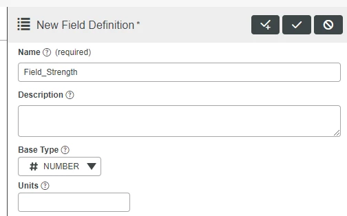

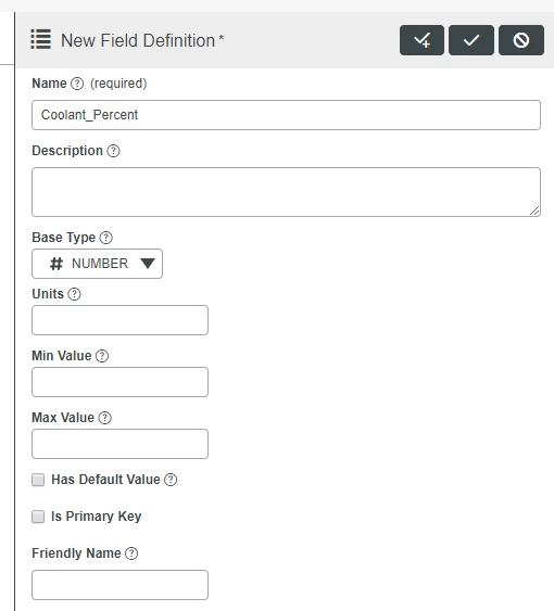

  1. On the far-right in the Name field, type Coolant_Percent.
  2. Change the Base Type to Number.
  3. At the top-right, click the "Check with a +" for Done and Add.
  4. In the Name field, type Field_Strength.
  5. Change the Base Type to Number.
  6. Click the "Check with a +" for Done and Add.

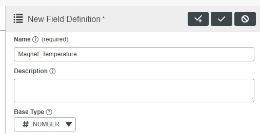

  7. In the Name field, type Magnet_Temperature.
  8. Change the Base Type to Number.
  9. Click the "Check" button for Done.
  10. At the top, click Save.
PC Definitions
Additional Definitions can be added at anytime as other sub-systems are included.
We'll now include the PC Properties.

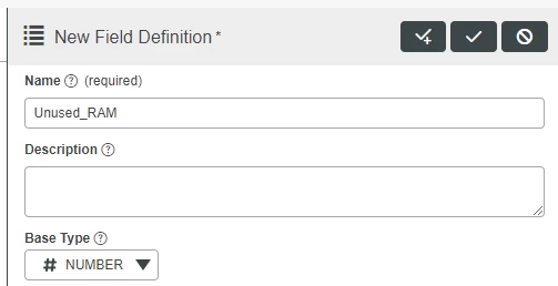

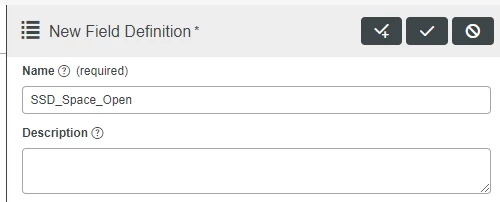

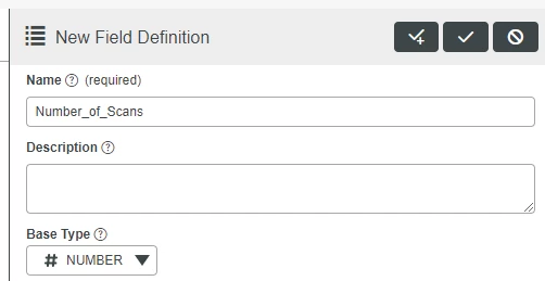

  1. Click + Add.
  2. In the Name field, type Number_of_Scans.
  3. Change the Base Type to Number.
  4. Click the "Check with a +" for Done and Add.
  5. In the Name field, type SSD_Space_Open.
  6. Change the Base Type to Number.
  7. Click the "Check with a +" for Done and Add.
  8. In the Name field, type Unused_RAM.
  9. Change the Base Type to Number.
  10. Click the "Check" button for Done.
  11. At the top, click Save.

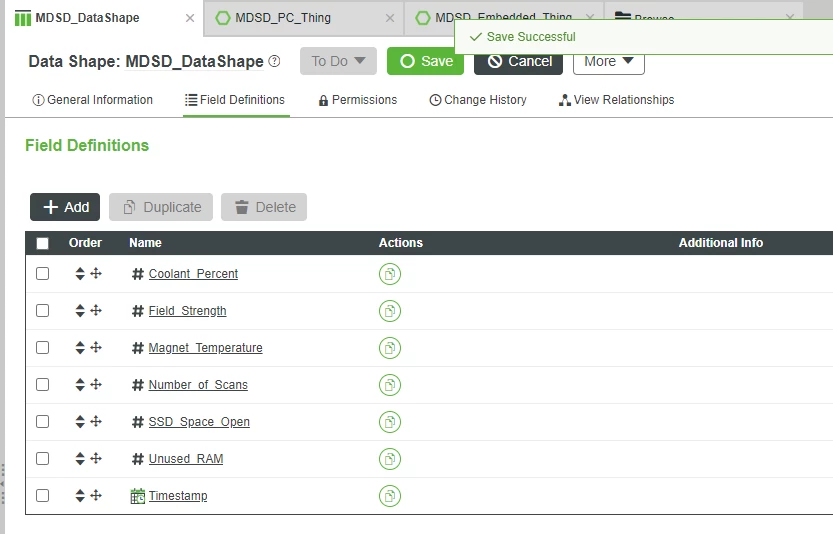

Timestamp

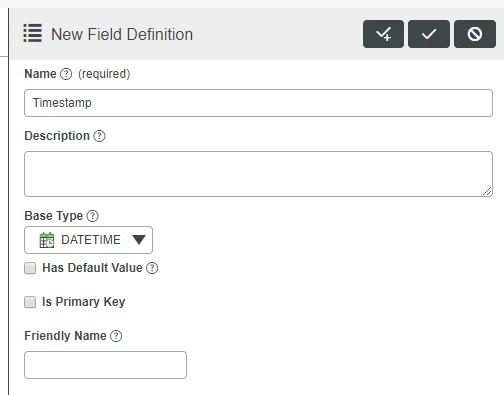

It might also be benificial to include a Timestamp of when the values of both the embedded microcontroller and PC were added.
  1. Click + Add.
  2. In the Name field, type Timestamp.
  3. Change the Base Type to DATETIME.
  4. Click the Check button for Done.
  5. Click Save.
