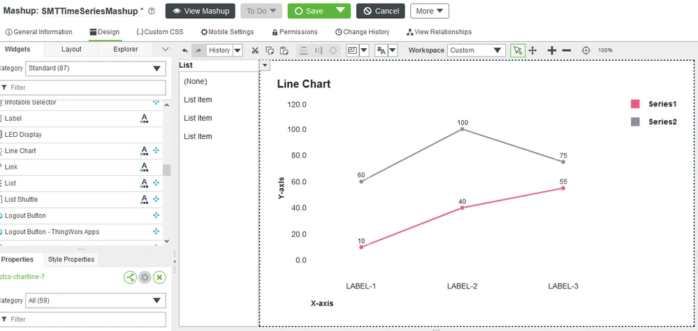

Setup New Mashup
  1. Create a Mashup that is Responsive and name it SMTTimeSeriesMashup.
  2. Click the Layout tab and add a column to the canvas.
  3. Drag and drop a List Widget onto the left column of the layout.
  4. Drag-and-drop a Line Chart Widget onto the other column of the layout.

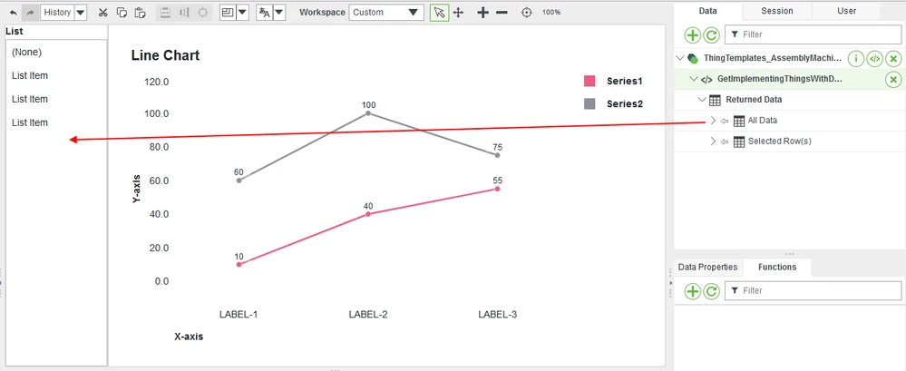

Configure List Widget
  1. Add the GetImplementingThingsWithData Service of the AssemblyMachineTemplate Thing Template as a data source in the Mashup. Ensure the checkbox for Execute on Load is checked.
  2. Drag-and-drop GetImplementingThingsWithData > Returned Data > All Data to the List Widget.
  3. On the Select Binding Target pop-up, select Data.
  4. With the List widget selected, for the DisplayField property dropdown, select name.
  5. In the ValueField property dropdown, select name.

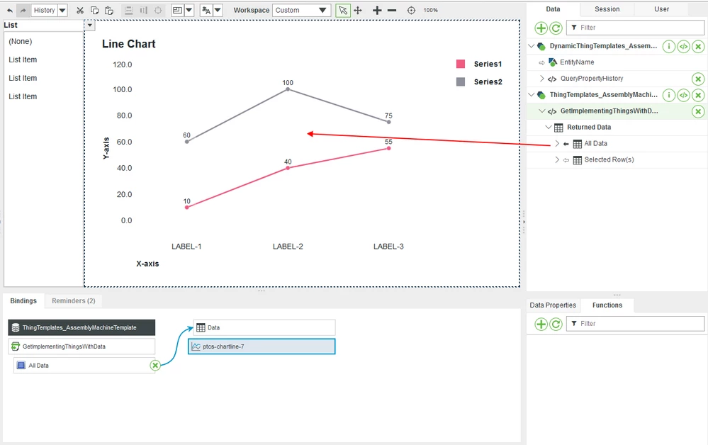

  1. Add the Dynamic QueryPropertyHistory Service of the AssemblyMachineTemplate Thing Template as a data source in the Mashup. Ensure the checkbox for Execute on Load is checked.
  2. Drag-and-drop QueryPropertyHistory > Returned Data > All Data to the Time Series Chart Widget.
  4. For the XAxisField property dropdown, select timestamp.
  5. For the DataField1 property dropdown, select IdleTime OR MotherboardsCompleted.

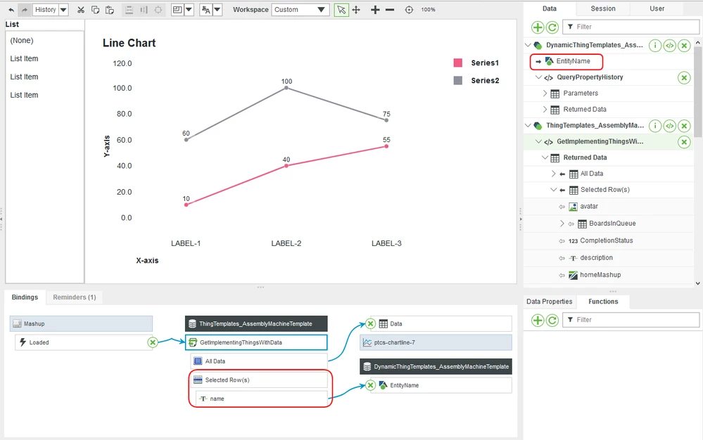

Connect Widgets
  1. Drag-and-drop the GetImplementingThingsWithData > Returned Data > Selected Row(s) > name property to the EntityName parameter for the Dynamic AssemblyMachineTemplate data source.
  2. Select the GetImplementingThingsWithData service, then drag-and-drop the SelectedRowChanged event onto QueryPropertyHistory.
  3. Click Save.
  4. After the save is complete, click View Mashup.
You are now able to see what the idle time is for each assemble machine over the span of its use.
