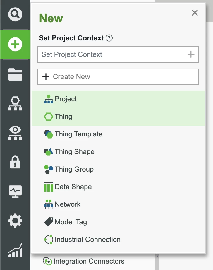

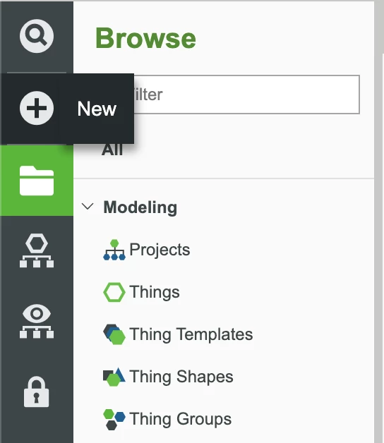

1.  In the ThingWorx Composer, click the + New button in the top left.
2. In the dropdown list, click Thing.

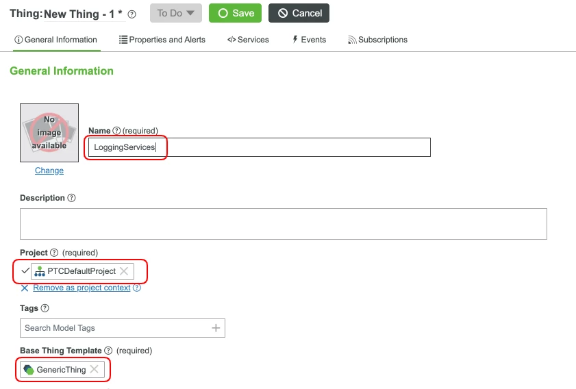

3. In the Name field, give our agency name, such as  LoggingServices.
4. In the Base Thing Template field, select GenericThing.
5. Select a Project, such as PTCDefaultProject. Set this as the default context if you wish.
6. Click Save.

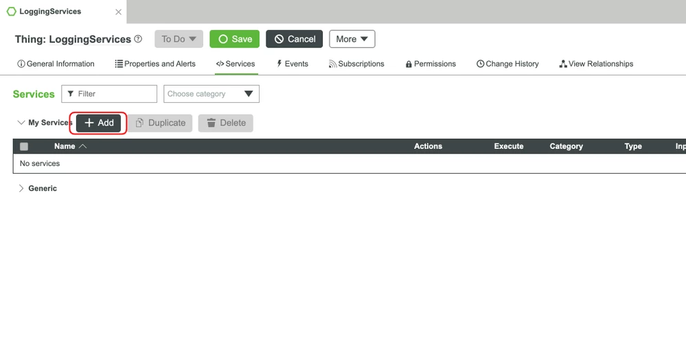

1. Click the Services tab.
2. Click the Add button to create a new JavaScript service.

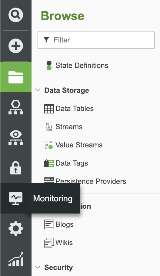

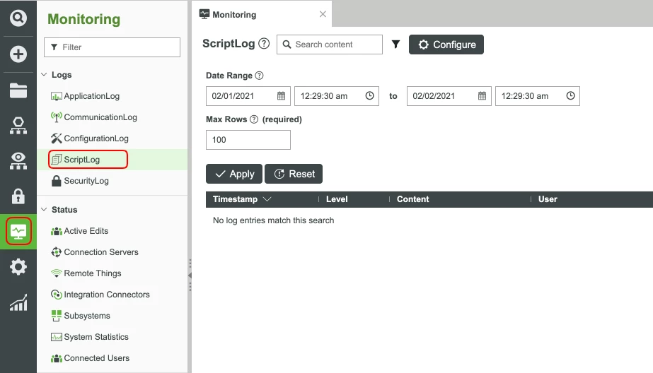

Let’s go to the Monitoring section of the ThingWorx Composer and view the results from the server we triggered earlier.
1.     Click on the Monitoring section on the left-hand side of the Composer.
2.     Click on ScriptLog. Based on your role on this team, this might be the log that you view the most.
3.     You should be able to see or find the logs we recently generated from executing our new service.

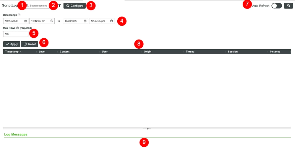

The logging views in Composer will generally show you the last 24-hour period. This can be helpful if you know something ran within the last day. Based on the amount of logging your system performs, that can be way too large a window. Let’s start playing with the filters and searches.
#Function
1The search text box allows you to search for specific words in the log based on your time window. Once you have entered the word, hit the **ENTER/RETURN key on your keyboard.
2The filter button provides a menu that provides more features to filter the logs. See below.
3The configure button provides a pop-up that allows you to filter incoming log statements based on a certain logging level. See below.
4The date range will default to the last 24 hours but can be updated to a wider or smaller window. You will need to click the Apply button when ready.
5The max rows field provides how many records will come back in the view. The search will continue until it hits this number, or your date range is met. You can shorten this field for faster searching or increase it up to 1000 to showcase more information. You will need to click the Apply button when ready.
6Apply and Reset buttons. Apply will run the search you currently have on the screen. Reset will reset the date range and max rows ONLY.
7Auto Refresh allows for the logs to continue rolling in based on your current filters. Think of this as a specified **tail command on a server log.
8This grid provides the actual logging information. The information provided here can be used to also help filter what you’re looking for. If you see specific thread has the data you need, use the filter menu (2) to filter based on that thread. You can also click on these items to view the log statement clearer.
9This log message field provides the message from the grid (8) entry clicked on.

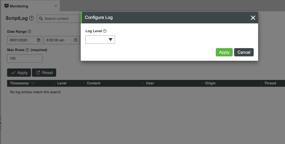

The Configure Pop-up
The configure pop-up helps with logging going forward. If you only want to see debug level information or you’d like to see everything down to the trace messages, configure it here and you’ll see the change as new messages come in.
