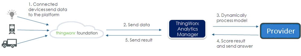

It is important to understand how Analytics Manager interacts with the ThingWorx platform.
Build Model

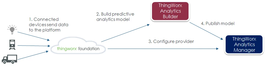

In an IoT implementation, multiple remote Edge devices feed information into the ThingWorx Foundation platform. That information is stored, organized, and operated-upon in accordance with the application's Data Model. Through Foundation, you will upload your dataset to Analytics Builder. Builder will then create an Analytics Model.
Operationalize Model
Analytics Manager tests new data through the use of a Provider, which applies the Model to the data to make a prediction. The Provider generates a predictive result, which is passed back through Manager to ThingWorx Foundation. Once Foundation has the result, you can perform a variety of actions based on the outcome. For instance, you could set up Events/Subscriptions to take immediate and automatic action, as well as alerting stakeholders of an important situation.

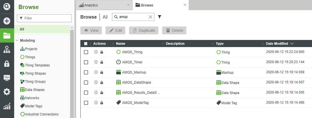

Import Entities
Import the engine simulator into your Analytics Trial Edition server.
- Download and unzip the attached amqs_entities.zip file.

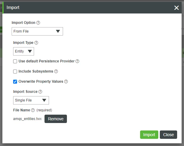

- At the bottom-left of ThingWorx Composer, click Import/Export > Import.
- Keep the default options of From File and Entity, click Browse, and select the amqs_entities.twx file you just downloaded.
- Click Import, wait for the Import Successful message, and click Close.

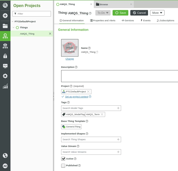

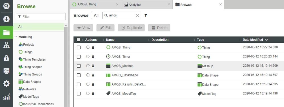

- From Browse > All, select AMQS_Thing from the list.

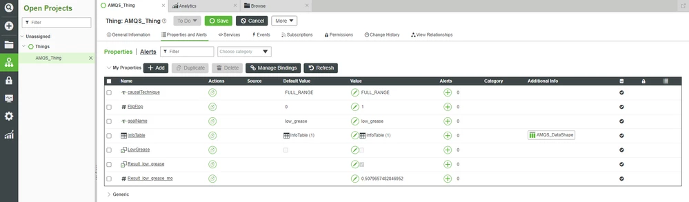

- At the top, click Properties and Alerts to see the core functionality of the simulator.
NOTE: The InfoTable Property is used to store data corresponding to the s1_fb1 through s1_fb5 frequency bands of the vibration sensor on our engine. The values in this Property change every ten seconds through a Subscription to the separate AMQS_Timer Thing. The first set of values are good, in that they do NOT correspond to a low grease condition. The second set of values are bad, in that they DO correspond to a low grease condition. These values will change whenever the ten-second timer fires.

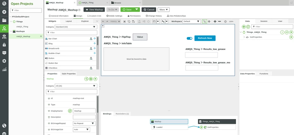

View Mashup

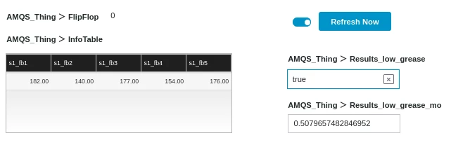

We have created a sample Mashup to make it easier to visualize the data, since analyzing data values in the Thing Properties is cumbersome. Follow these steps to access the Mashup.
- On the ThingWorx Composer Browse > All tab, click AMQS_Mashup.
- At the top, click View Mashup.
Observe the Mashup for at least ten-seconds.
- You'll see the values in the Grid Advanced Widget change from one set to another at each ten-second interval.

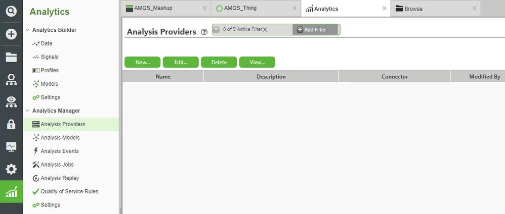

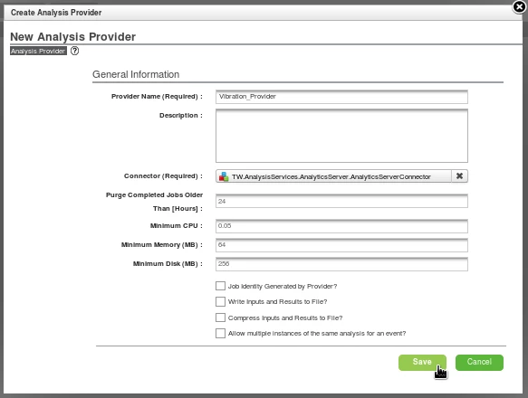

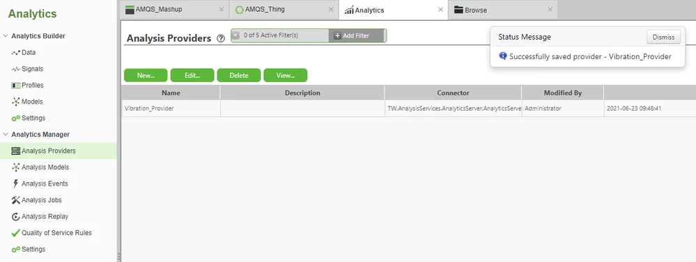

- From the ThingWorx Composer Analytics tab, click ANALYTICS MANAGER > Analysis Providers, New....
- In the Provider Name field, type Vibration_Provider.
- In the Connector field, search for and select TW.AnalysisServices.AnalyticsServer.AnalyticsServerConnector.
4. Leave the rest of the options at default and click Save.

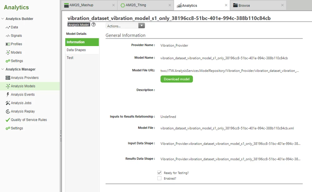

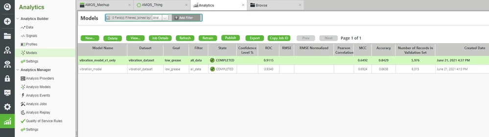

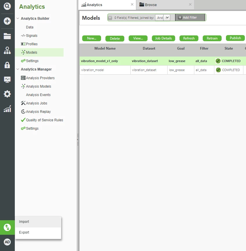

Step 4: Publish Analysis Model
Once you have configured an Analysis Provider, you can publish Models from Analytics Builder to Analytics Manager.
- On the ThingWorx Composer Analytics tab, click ANALYTICS BUILDER > Models.

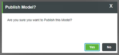

- Select vibration_model_s1_only and click Publish.
- On the Publish Model pop-up, click Yes.

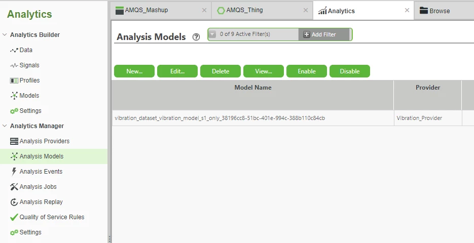

- A new browser tab will open with the Analytics Manager's Analysis Models menu.
4. Close that new browser tab, and instead click Analytics Manager > Analysis Models in the ThingWorx Composer Analytics navigation.
- This is the same interface as the auto-opened tab which you closed.

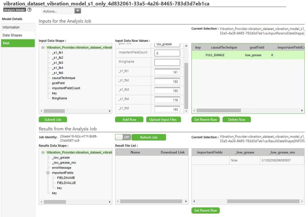

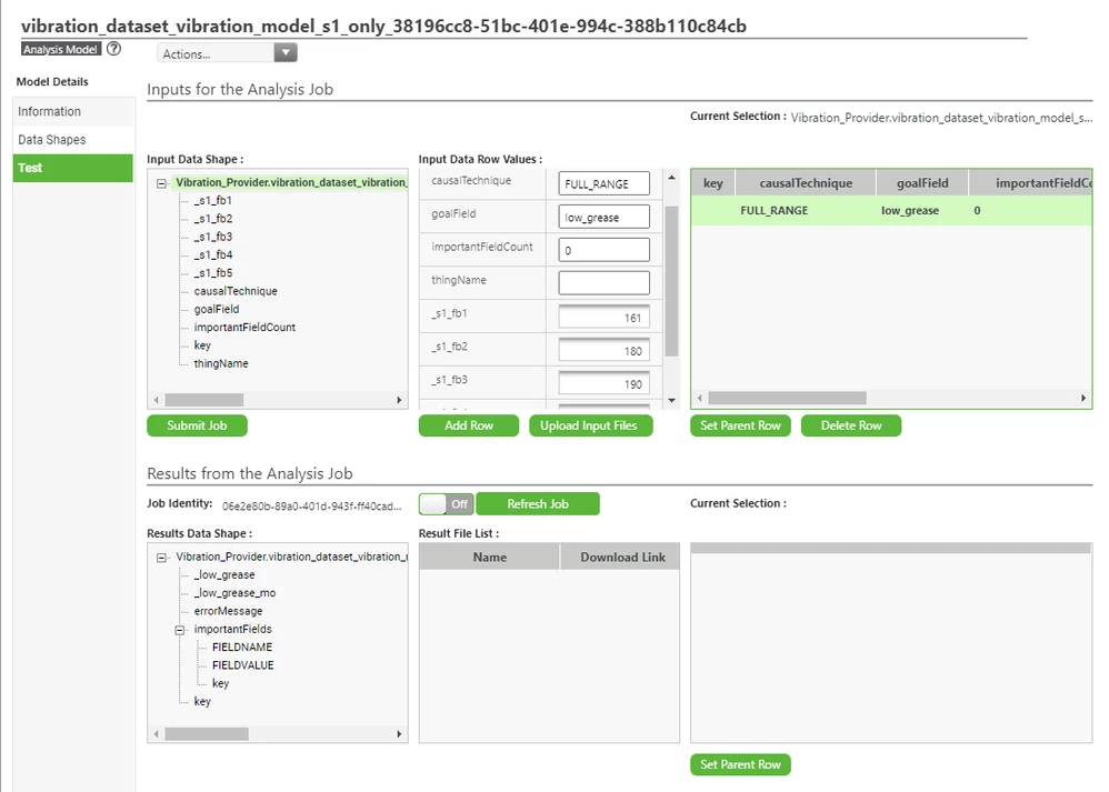

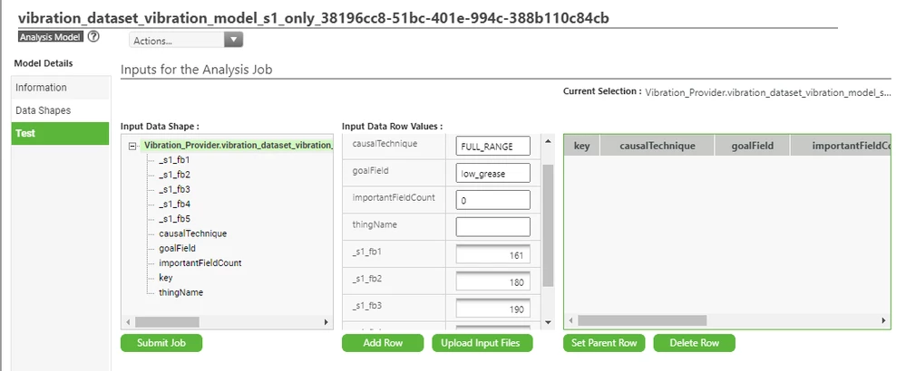

False Test

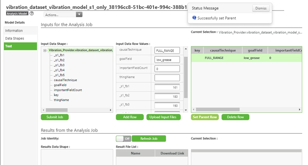

It is recommended to test the published Model with manually-entered sample data prior to enabling it for automatic analysis. For this example, we will use entry 20,400 from the vibration dataset. If the Model is working correctly, then it will return a no low grease condition.
- In Analysis Models, select the model you just published and click View.
- Click Test.
- In the causalTechnique field, type FULL_RANGE.
- In the goalField field, type low_grease.
- For _s1_fb1 through _s1_fb5, enter the following values:
Data Row Name | Data Row Value |
_s1_fb1 | 161 |
_s1_fb2 | 180 |
_s1_fb3 | 190 |
_s1_fb4 | 176 |
_s1_fb5 | 193 |

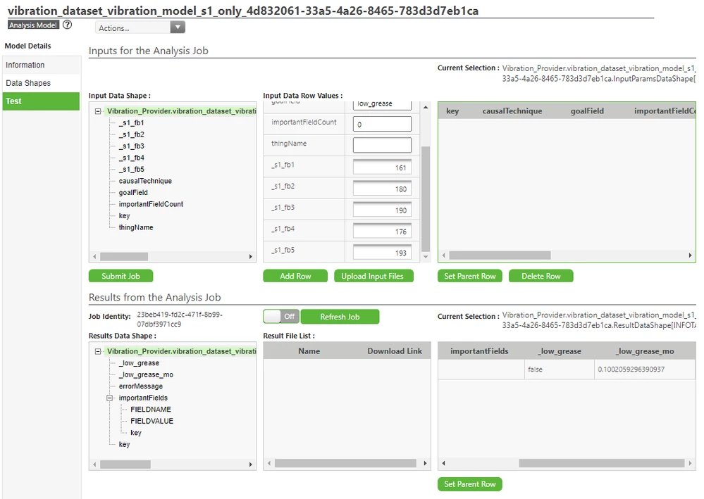

6. Click Add Row.
7. Select the newly-added row in the top-right, then click Set Parent Row.
8. Click Submit Job.
9. Select the top entry in the bottom-left Results Data Shape field.
10. Click Refresh Job.
- Note that _low_grease is false and and _low_grease_mo is well below 0.5 (the threashold for a true prediction).
You have now successfully submitted your first Analytics Manager job and received a result from ThingPredictor. ThingPredictor took the published Model, used the no low grease data as input, and provided a correct analysis of false to our prediction.

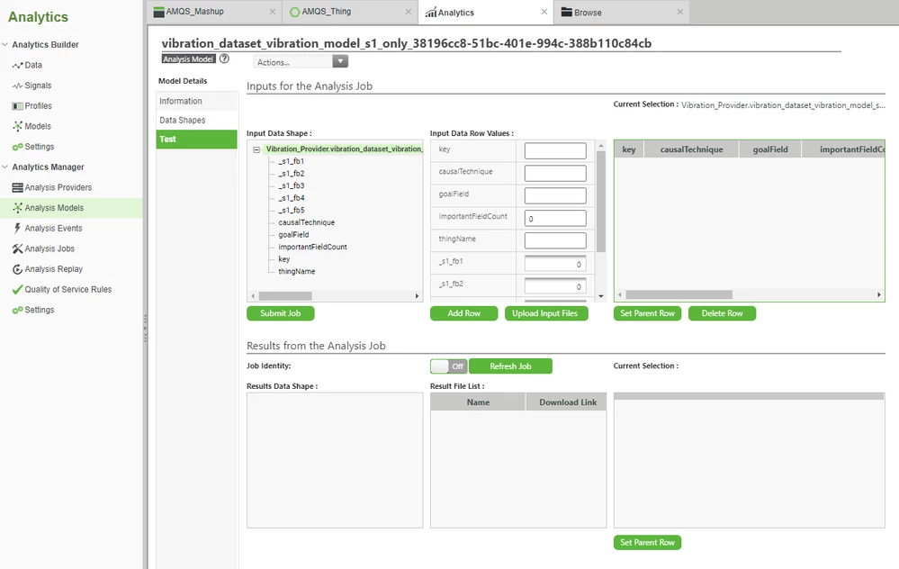

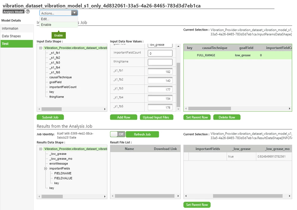

True Test

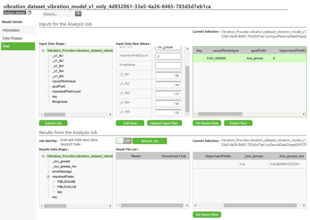

Now, let's test a true condition where our engine grease IS LOW, and confirm that Analytics Manager returns a correct prediction.
- In the top-right, select the false data row we've already entered and click Delete Row.
- For _s1_fb1 through _s1_fb5, change to the following values:
_s1_fb1 | 182 |
_s1_fb2 | 140 |
_s1_fb3 | 177 |
_s1_fb4 | 154 |
_s1_fb5 | 176 |
3. Select the top entry in the bottom-left Results Data Shape field.
4. Click Refresh Job.
- Note that _low_grease is true and and _low_grease_mo is above 0.5.
5. Click Submit Job.
6. Select the top entry in the bottom-left Results Data Shape field.
7. Click Refresh Job.
You've now manually submitted yet another job and received a predictive score.
Just like in the dataset Entry 20,600, Analytics Manager predicts that the second s1_fb1 through s1_fb5 vibration frequencies correspond to a low grease condition which needs to be addressed before the engine suffers catastrophic failure.

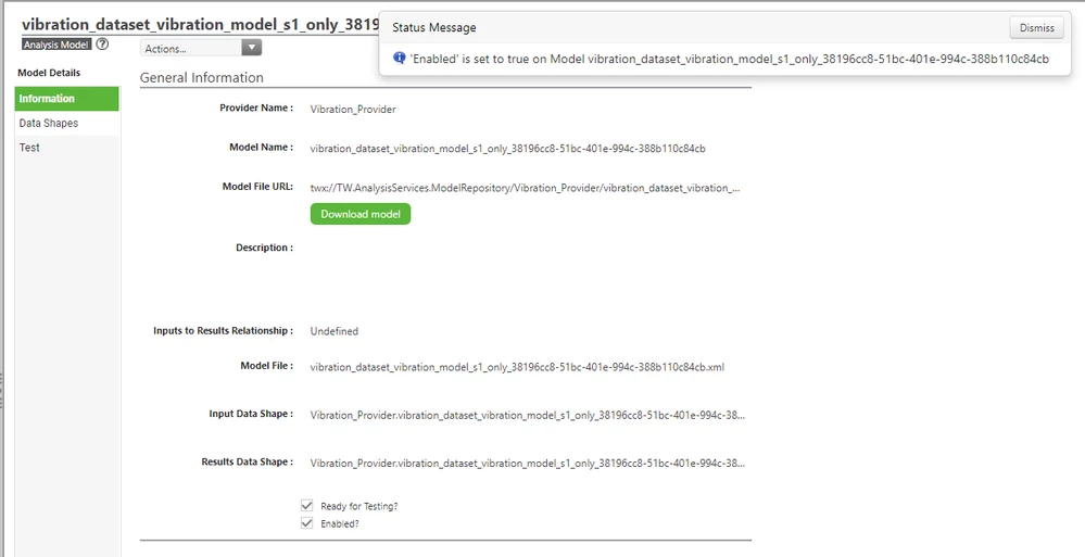

Enable Model
Since both false and true predictions made by the Model seem to match our dataset, let's now enable the Model so that it can be used for automatic predictions in the future.
- In the top-left, expand the Actions... drop-down box.
- Select Enable.
