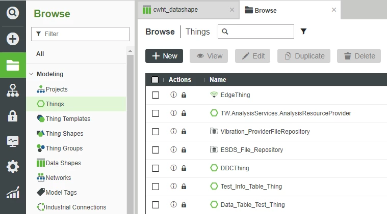

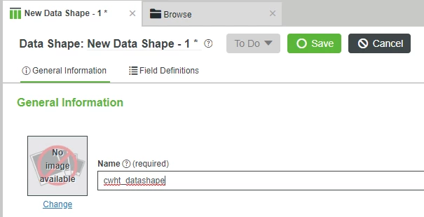

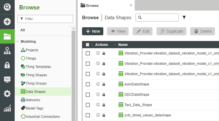

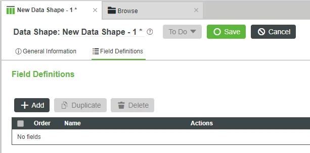

  1. In the ThingWorx Composer Browse tab, click Modeling > Data Shapes, + New
       2.  In the Name field, enter cwht_datashape.
    3. If Project is not already set, search for and select PTCDefaultProject.

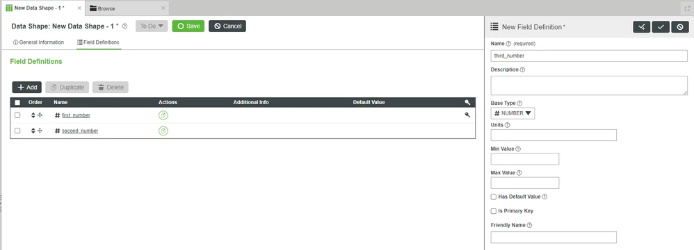

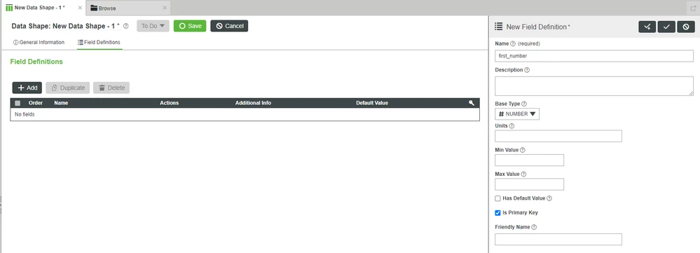

    4. At the top, click Field Definitions
First Definition:
       1. Click + Add to open the New Field Definition slide-out.
       2. In the Name field, enter first_number.
       3. Change the Base Type to NUMBER.
       4. Check the Is Primary Key box.
  • All Datashapes must have a single Primary Key, and the first Field is as acceptable as any other for our purposes here.
       5. At the top-right, click the "Check with a +" button for Done and Add.

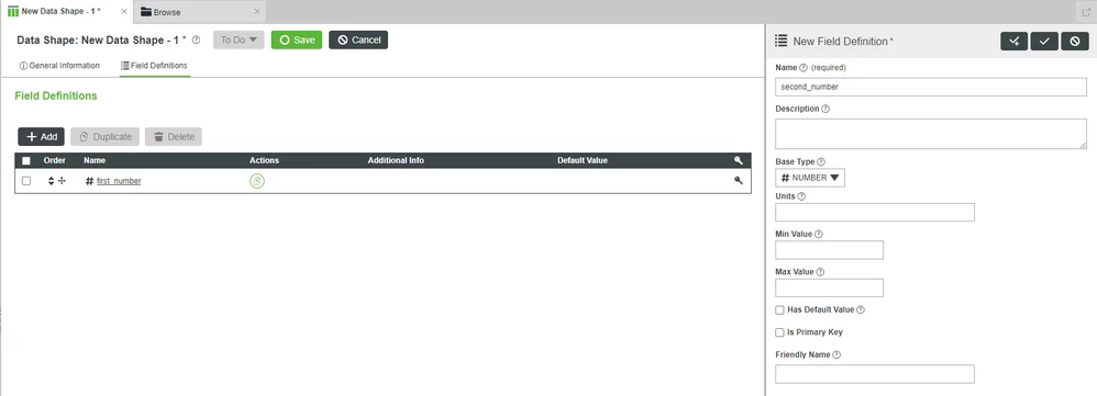

Second Definition:
  1. In the Name field, enter second_number.
      2. Change the Base Type to NUMBER.
      3. At the top-right, click the "Check with a +" button for Done and Add.

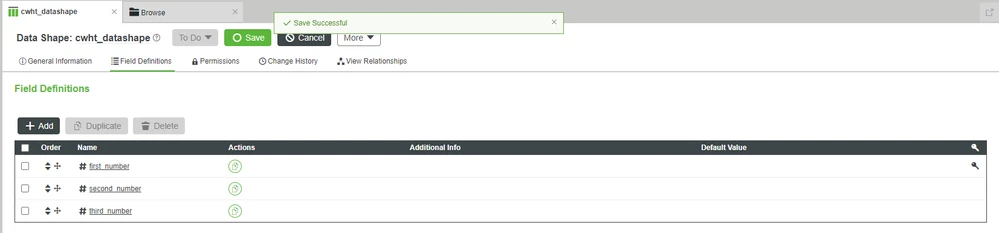

Third Definition:
  1. In the Name field, enter third_number.
      3. At the top-right, click the "Check" button for Done
      4. At the top, click Save.

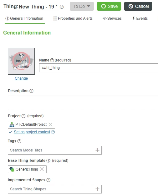

  1. On the ThingWorx Composer Browse tab, click Modeling > Things, + New.
      2. In the Name field, enter cwht_thing.
      4. Select GenericThing in the Base Thing Template field

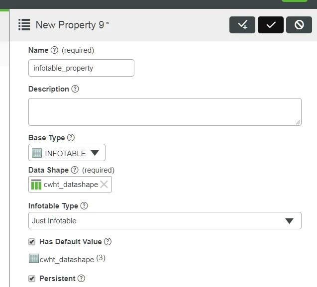

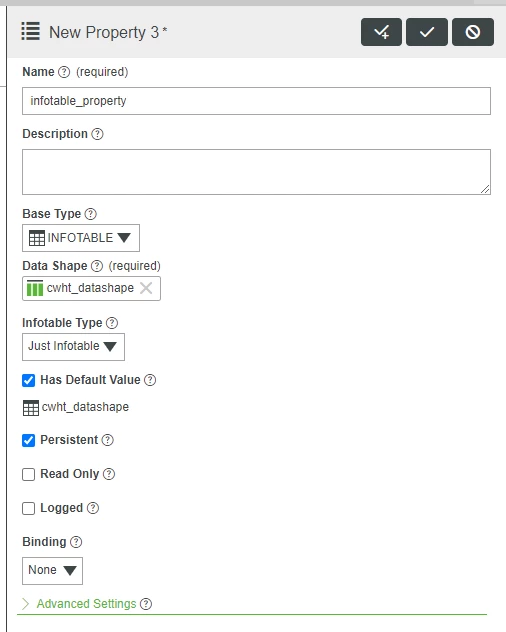

Add InfoTable Property

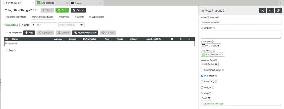

      1. At the top, click Properties and Alerts.
     2. Click the + Add button to open the New Property slide-out.
     3. In the Name field, enter infotable_property.
     4. Change the Base Type to INFOTABLE.
     5. In the Data Shape field, select cwht_datashape.
     6. Check the Persistent checkbox.

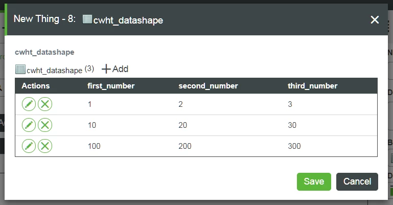

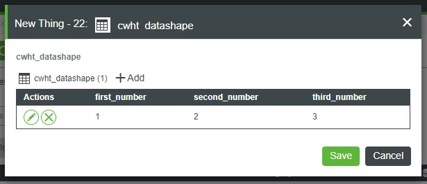

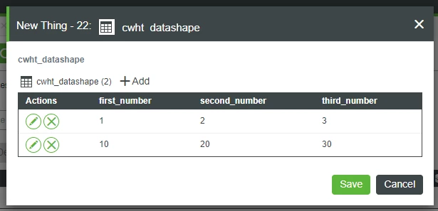

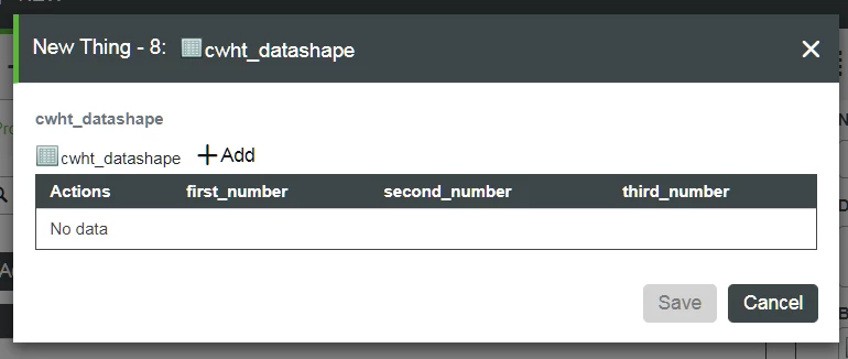

First Default
  1. Check the Has Default Value checkbox.
    • A cwht_datashape icon will appear underneath.

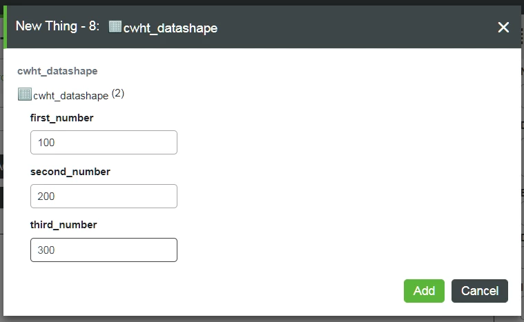

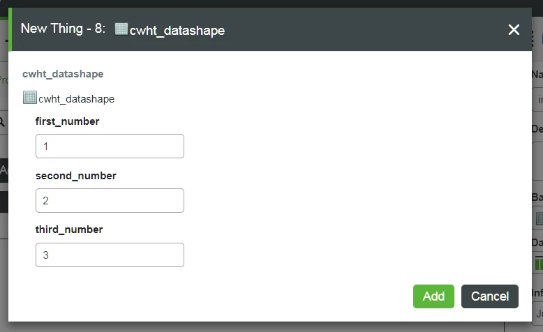

     2. Under Has Default Value, click the cwht_datashape button to open the pop-up menu which  sets the default values
      3. Click the + Add icon.
      4. Enter values in each number field, such as 1, 2, and 3.
     5. At the bottom-right, click the green Add button.

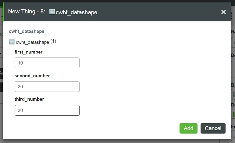

Second Default
  1. Click the + Add icon.
      2. Enter values in each number field, such as 10, 20, and 30
     3. At the bottom-right, click the green Add button
Third Default
      2. Enter values in each number field, such as 100, 200, and 300
     3. At the bottom-right, click the greenAddbutton
    4At the bottom-right, click Save to close the pop-up menu

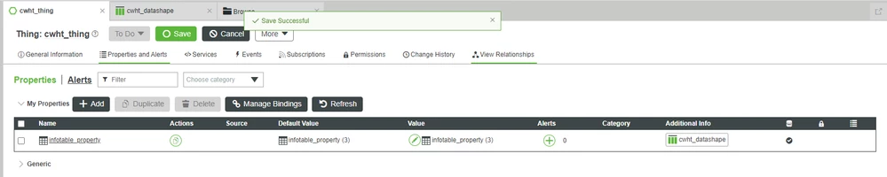

    5. At the top-right, click the "Check" button for Done.
    6. At the top, click Save
