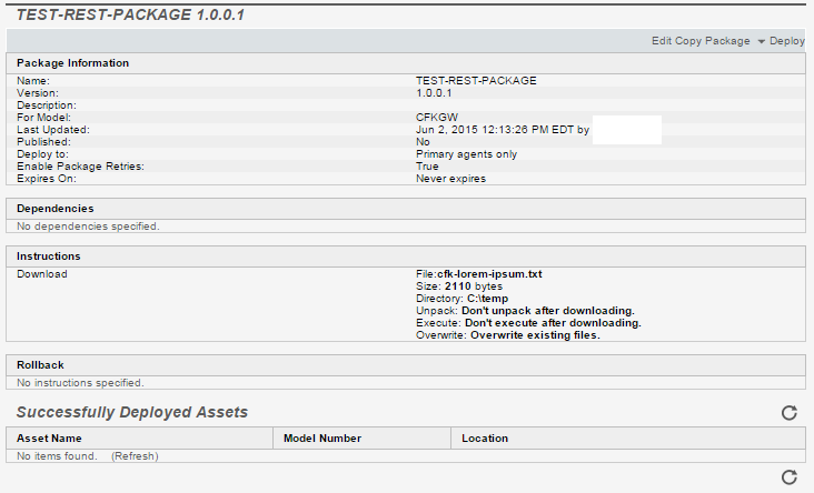

And PROOF!
softwarepackage-screenshot.pngI hope this helps you in your projects, and helps demystify the Axeda Platform REST API a little for you.

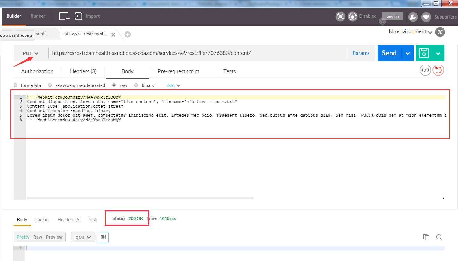

    September 22, 2015
    I am following your instructions,
    1. I have created FileUploadSession successfully
    2. Now try to upload file content, it block me - HTTP 200 returned but no message returned..
    So I don't know what happened and is there something wrong.
    Below is my request body,

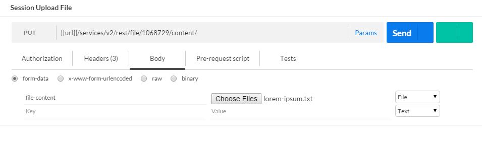

    ckaminski5-Regular MemberAuthor
    September 22, 2015
    On the body tab, instead of raw, pick "form-data".
    Then choose the example file, and give it the key "file-content" and set the type to "File".
    -Chris Kaminski

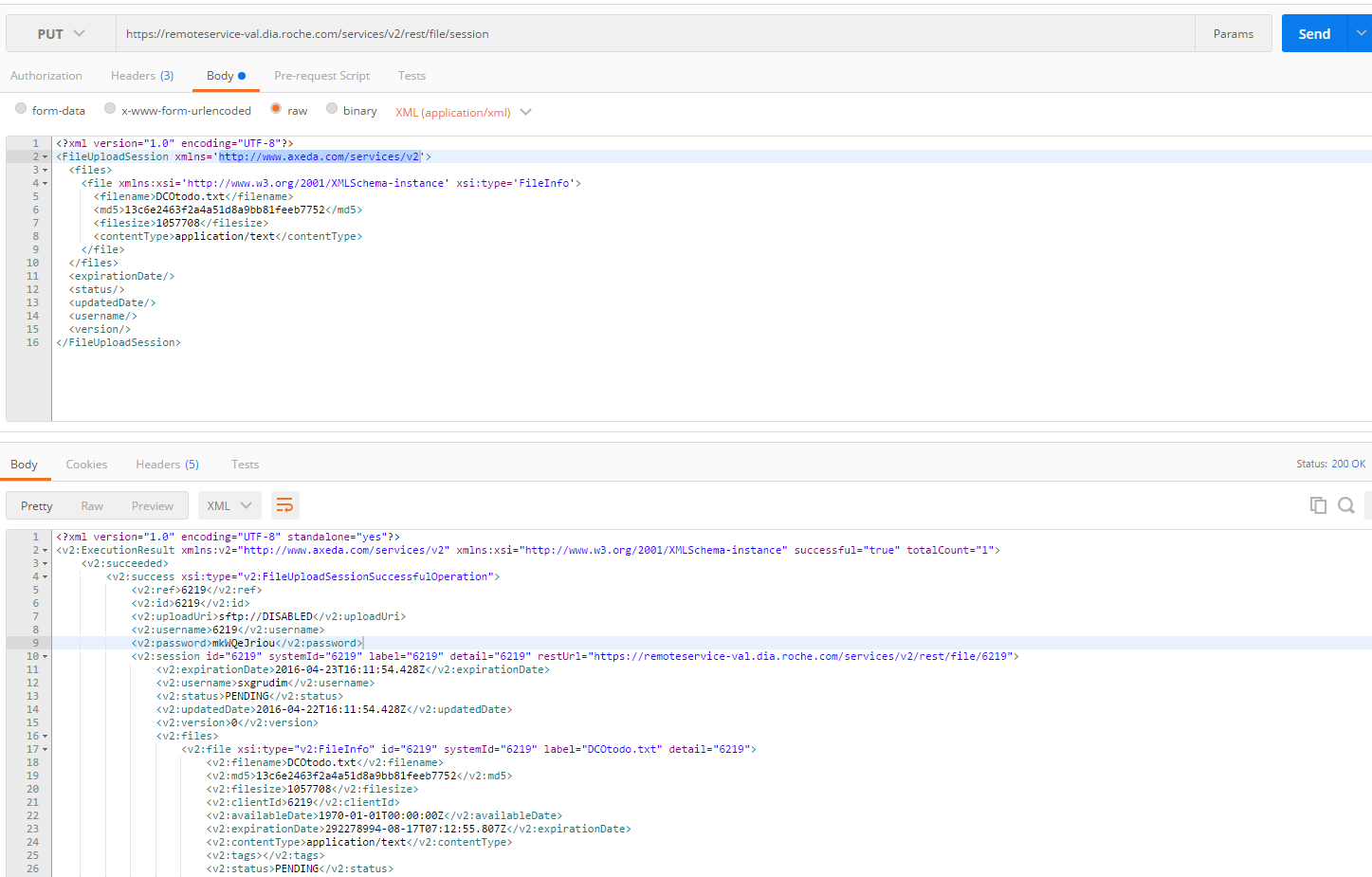

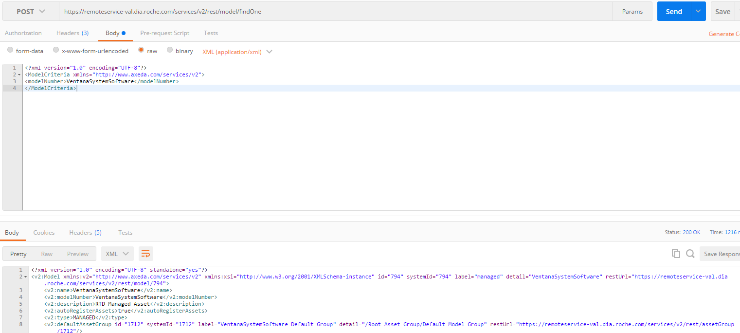

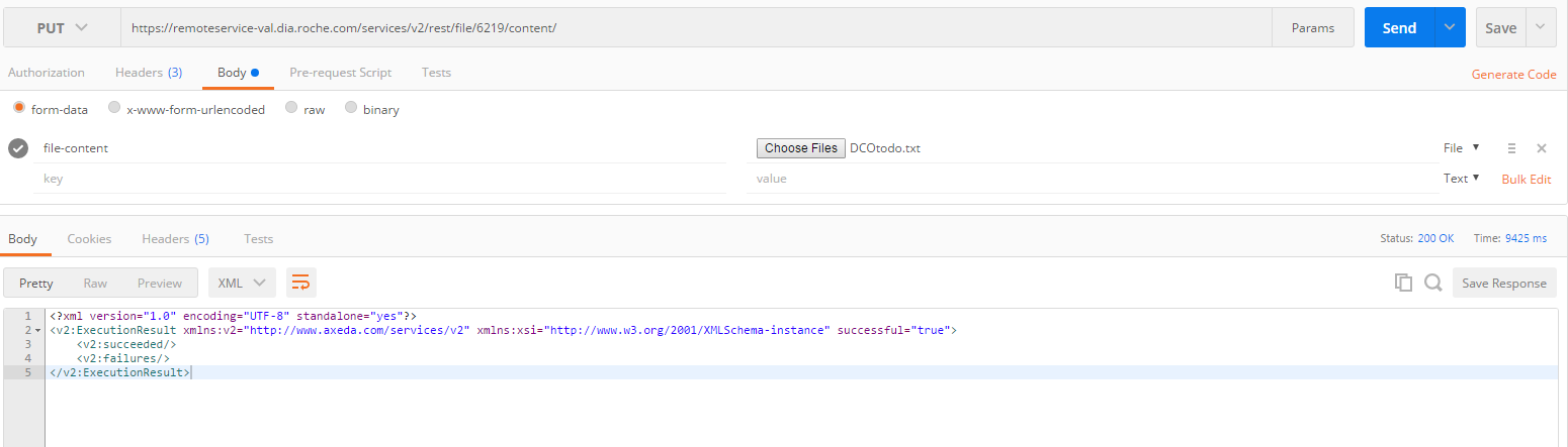

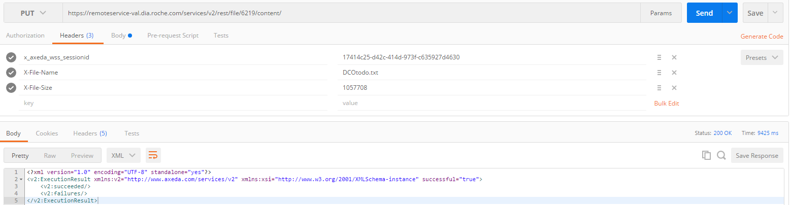

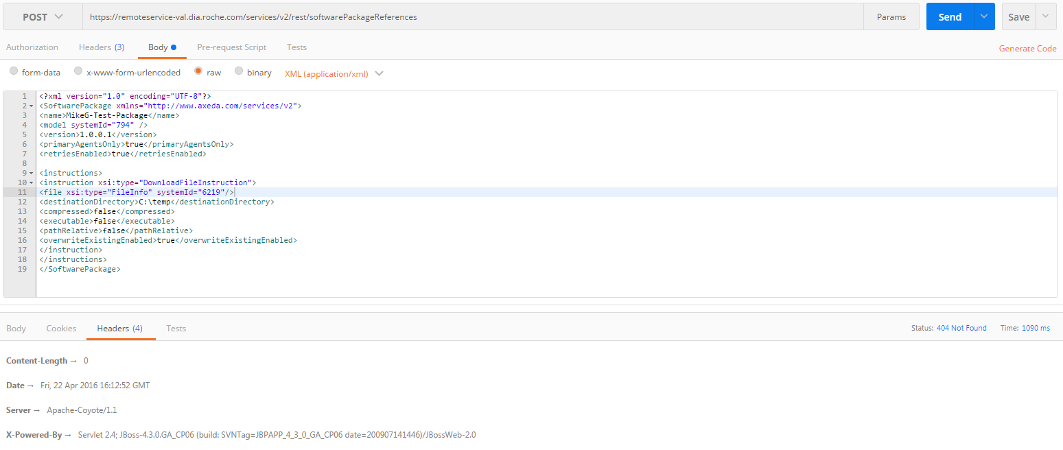

    Hi Chris - I see this older thread has been marked as Resolved but I'm hoping you'll be able to assist me.  If I need to open a case with PTC please let me know and I will do so.  I'm trying to create a package using this exact example you gave.  Step 1, 2, 3 are fine. I can get a session Id, my model Id, and File Upload session id (6219 in my example):
    Step 4: I think I am uploading the contents of the file successfully because if I purposely use the wrong MD5 I get an error.  I also tried different file sizes.  The larger file takes a bit longer. So I think the file is uploading ok.  However, the response is not complete, like in your example:
    Again, I'm not sure step 4 is completely successful, but I'll move on to step 5.  I get a 404 error, resource not found.
    Clearly I'm doing something wrong but I can't figure it out.  I'm confident the model id is 794 (screenshot below from step 2).  Will you please provide me with some guidance?
    Thanks, Mike Grudinschi
    April 28, 2016
    Mike:
       Sorry for the delay.  Can you open up a support case on the Portal?  We can coordinate testing or a Webex to review this.
    -Chris
