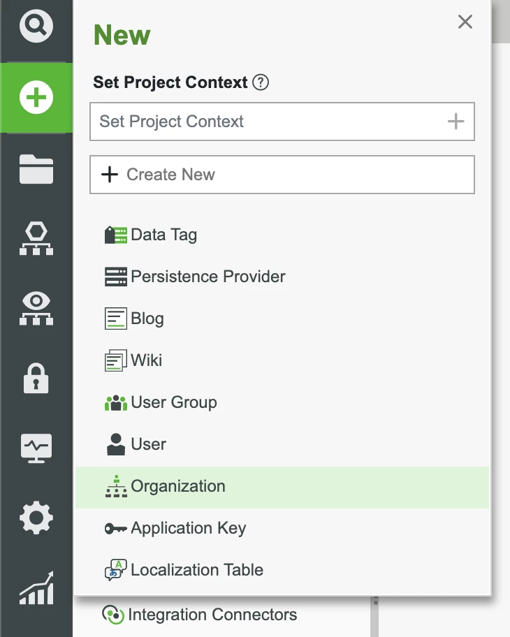

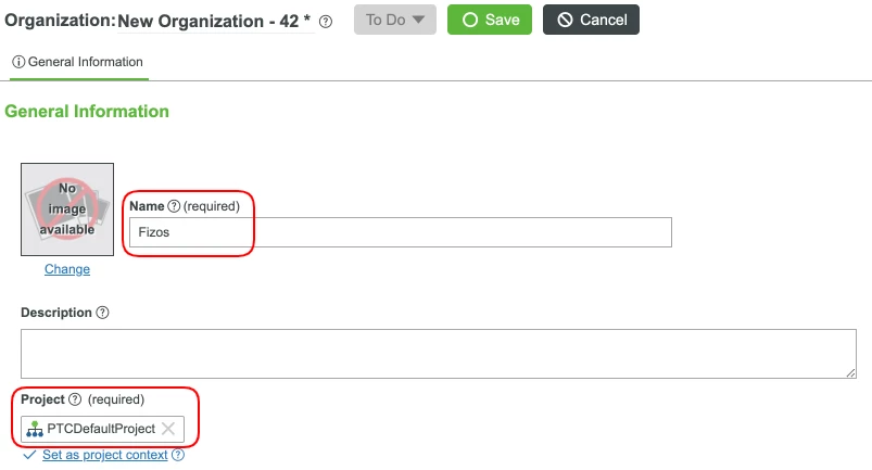

  1. In the ThingWorx Composer, click the + New at the top of the screen.
  2. Select Organization in the dropdown.
  3. Name your Organization Fizos.
  4. Set the Project field (ie, PTCDefaultProject).
  5. Click Save

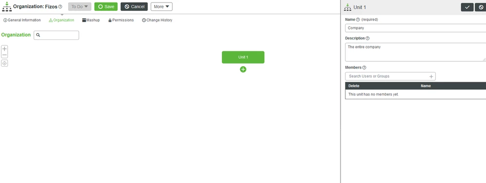

  6. Select the Organization tab to see the hierarchy.
  7. Select Unit 1 in the middle of the canvas.
  8. Update the Name field to Company and save your changes.

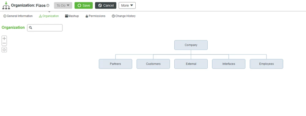

Create Additional Organization Units
Now let's add a node for Employees, Interfaces(APIs), Partners, Customers, Guests, and other groups we might consider important.
  1. Click the green + under the structure you would like to expand.
  2. Name your Organization unit Employees.
  3. Click Save. We won't add groups as yet. We will do that in the following sections.
Repeat the steps to create the full top level units. It should look similar to the following:
We now have the starting structures for Fizos. Next, we will need to add security groups and more units.

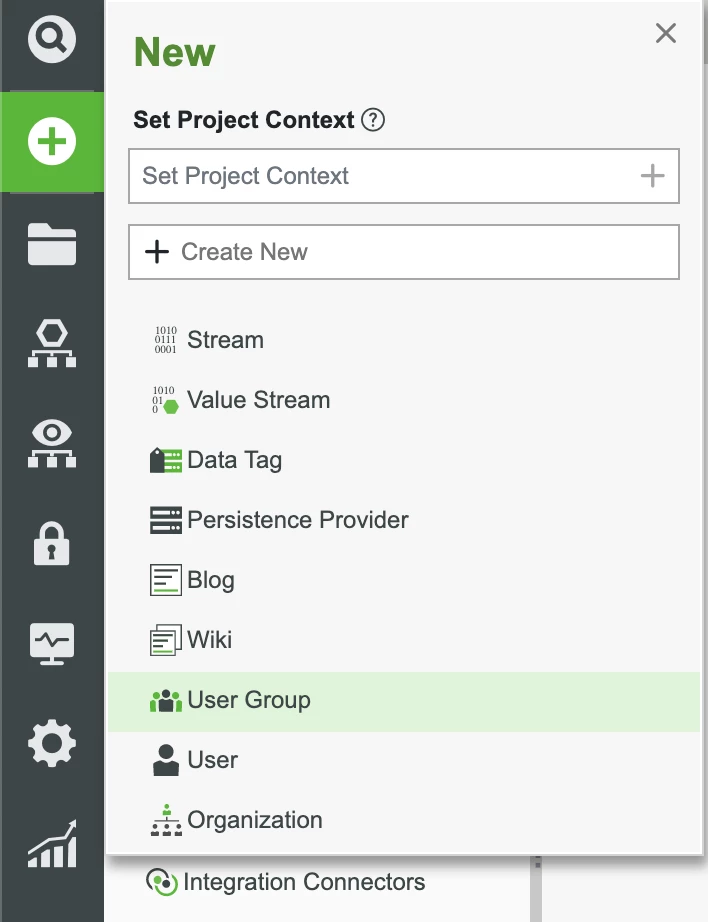

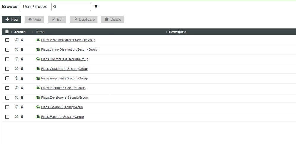

  2. Select User Group in the dropdown.
  3. Name your group Fizos.Partners.SecurityGroup.
  4. Set the Project field with an existing Project (ie, PTCDefaultProject).
  5. Click Save.
Repeat these steps to create more user groups for each of the top level units we created in the last section (Customers, External, Interfaces, Employees). We can also add in some groups from the companies we listed as customers and partners earlier in this learning path. Below is an example of all the groups I created for this example:
NOTE: Individual user permissions will override group user permissions. In other words, if you initially add a user to a group so they inherit the permissions of the group, you will still be able to customize permissions for an individual user in that group as needed.

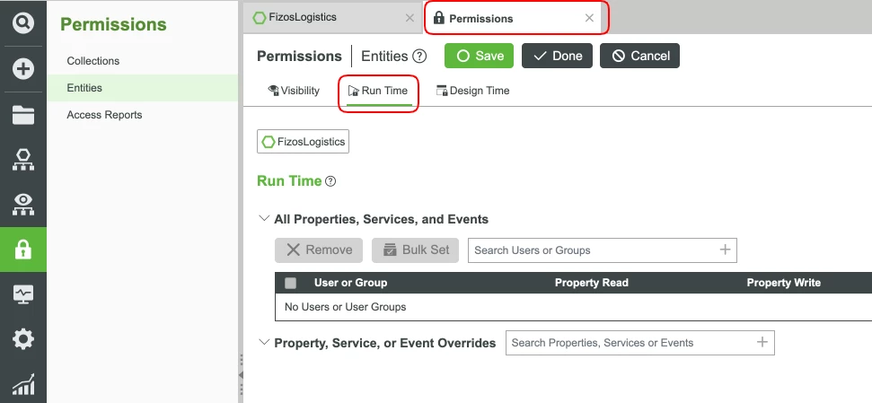

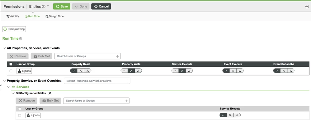

Add Permissions for an Entity
  1. Once an entity has been selected for editing, select the Permissions tab.
  2. Based on what you would like to edit, select the Design Time or Run Time tab.
The All Properties, Services, and Events section provides blanket security to all of these features for a group or user. The Property, Service, or Event Overrides section is used for any overrides that need to be made for specific features.
In the example blow, the User a.jones has the ability to read properties, fire events, and subscribe to events. The User does not have the ability to update a property or execute a Service. In the second section, a.jones is allowed to call the GetConfigurationTable Service (even though he was restricted from doing so in the other section).
To set a permission, filter and select a User/User Group. When their name is in the table, click the Permission Type you would like for this Entity. Default permissions are added to the User or User Group you filtered and selected. This will be full access permissions unless you've changed one of the fields.

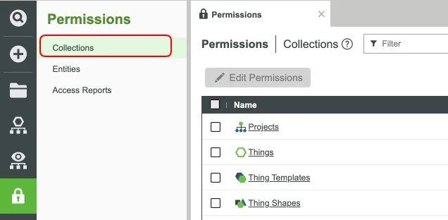

When you would like to set the permissions to an entity in bulk, ie permissions for all Things, you can use the Collections option.
  1. On the left hand side, click the lock.
  2. Click the Collections option under Permissions.
  3. Select the checkbox next to Things.
  4. Click Edit Permissions button.
Now you will see the same interface you used above, except this time, it will be for all Things instead of a singular entity. You can use these permission settings to stop access to all of the entities you would not want an external user being able to see.

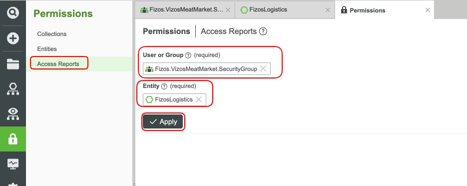

Bulk Permissions Reporting
When you would like to verify the permissions to an entity, ie permissions for all Fizos.Logistics, you can use the Access Report option.
  2. Click the Access Report option under Permissions.
  3. Set the User or User Group. (in this case Fizos.VizosMeatMarket.SecurityGroup)
  4. Set the Entity (in this case Fizos.Logistics)
  5. Click Apply.
You will be able to see what this User Group has access to as it pertains to the Fizos.Logistics Entity. Try other Entities and User Groups.
