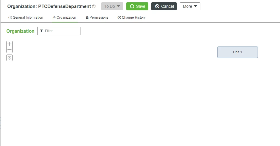

Creating Our Organizations
If you need a refresher on how to create security groups and permissions, take a look back at our Configure Permissions Guide. If you are ready to get started, follow the instructions below:

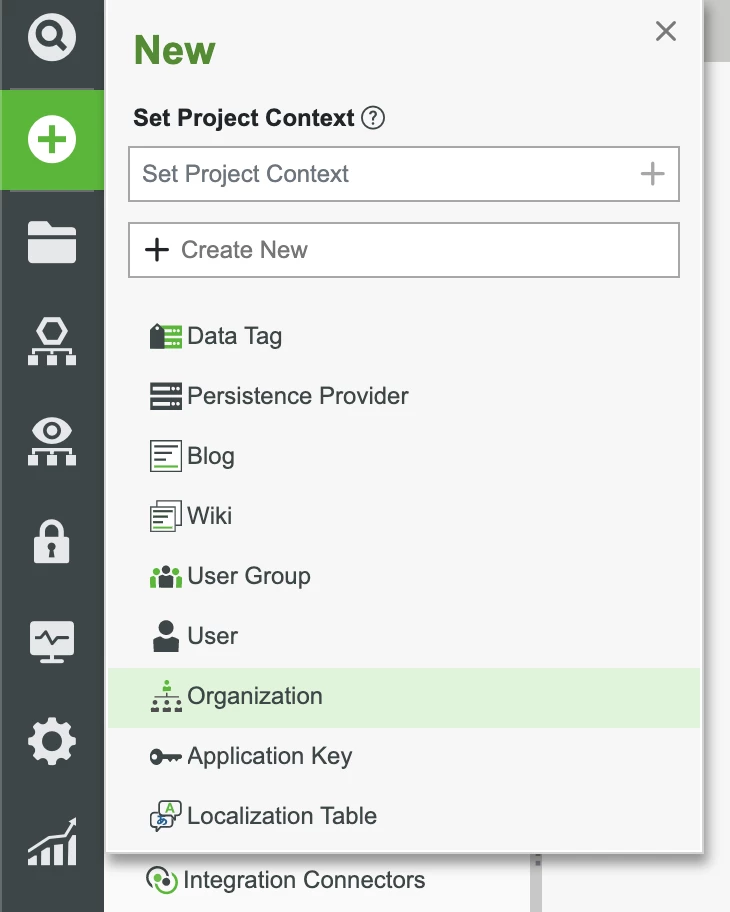

1. In the ThingWorx Composer, click the + New button in the top left.
2. In the dropdown list, click Organizations.
3. In the Name field, give our agency name, such as PTCDefenseDepartment.
4. Set the Project field to an existing Project (ie, PTCDefaultProject) and click Save to save your work.
5. Go to the Organization tab and you will see the beginning of our Organization.

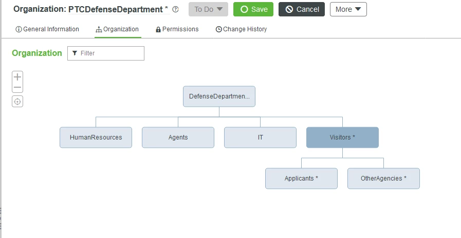

Creating Our Departments
Let us add some departments in our Organizations. We will add a few here but add as many as you like. Just keep in mind, these departments do not need to match every department in the actual Organization. These departments will be used for access to different resources.

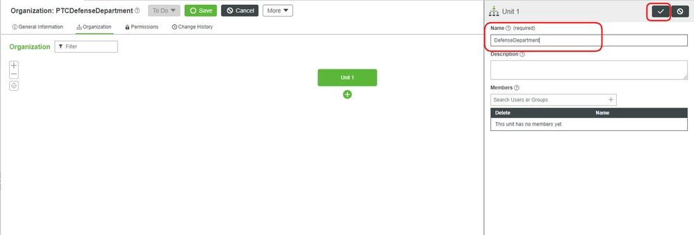

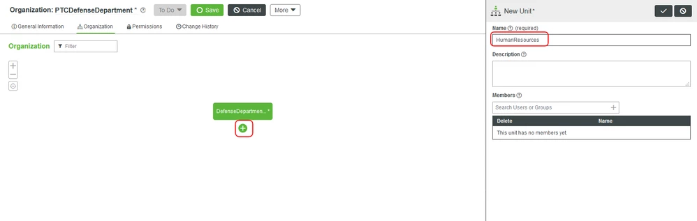

1. Click on the first unit and update the Name field to DefenseDepartment. Click the check mark to save your changes.
NOTE: You can add the spaces if it looks better to you. You will be using these departments throughout this learning path. You can also change these later.
2. Under our first unit (DefenseDepartment), click the green + button. Name this unit HumanResources.
3. Repeat the last step to create three more departments under our DefenseDepartment unit. Name these new units Agents, Visitors, and IT.

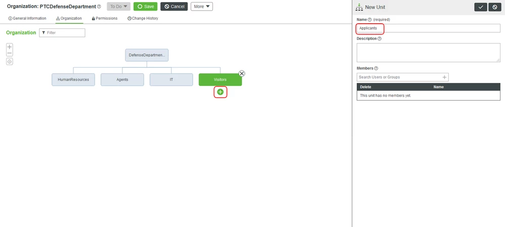

4. Under the Visitors unit, click the green + button to add a unit and name it Applicants.
5. Repeat the last step to add one more unit under the Visitors unit. Name this group OtherAgencies. Your setup should have the following departments.
You now have a complete start to our agency. What does that mean exactly? An Organization allows us to limit resources to only members of that overall Organization or specific unit within that Organization. You will get firsthand experience as we move further in this guide.

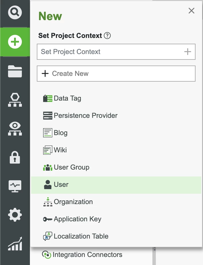

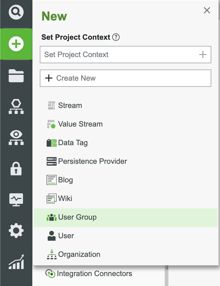

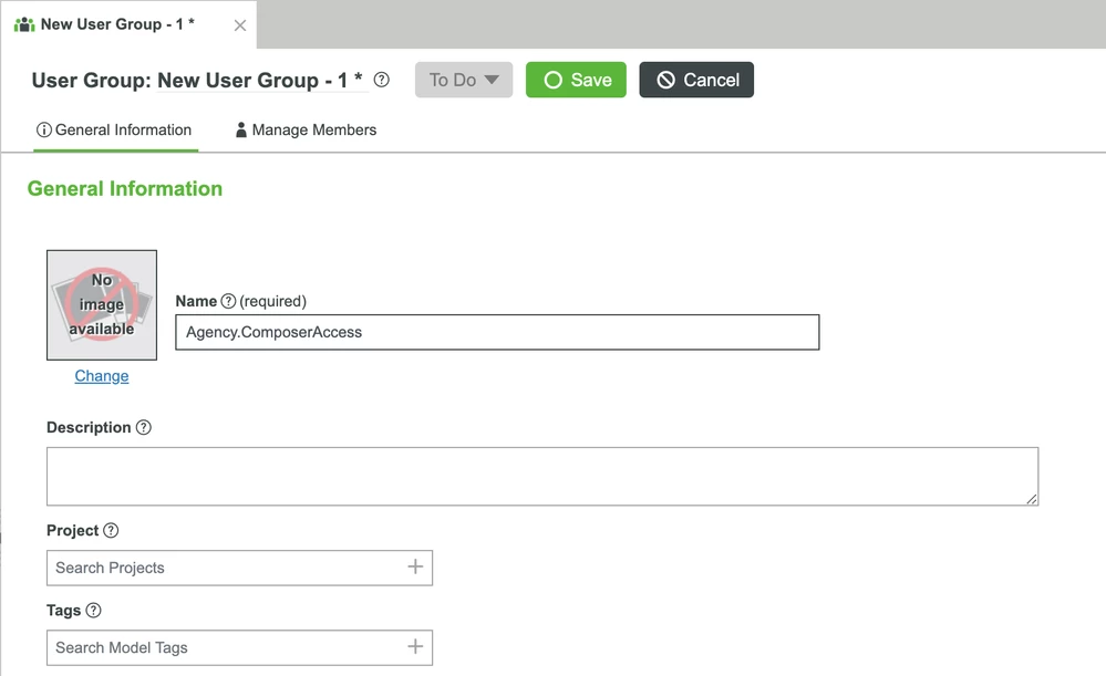

1. In the ThingWorx Composer, click the + New at the top left of the screen.
2. Select User Groups in the dropdown.
3. Name the User Group Agency.ComposerAccess.
4. Set the Project field to an existing Project (ie, PTCDefaultProject) and click Save.
5. Repeat steps 1-4 to create a User Group for each department (Agency.HumanResources, Agency.Agents, Agency.Visitors, Agency.Applicants, Agency.OtherAgencies, and Agency.IT).

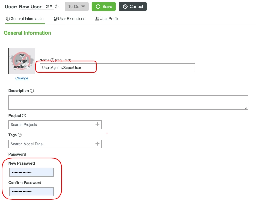

2. Select User in the dropdown.
3. Name the User User.AgencySuperUser and add a password.
5. Repeat steps 1-4 to create a User for each department (User.HumanResources, User.Agents, User.Visitors, User.Applicants, User.OtherAgencies, and User.IT).

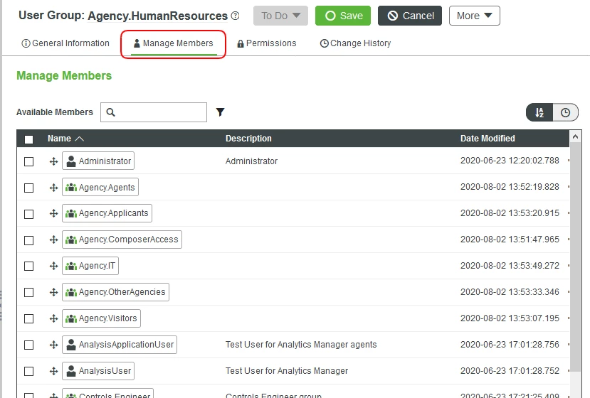

Assign each user to the corresponding User Group using the below instructions.

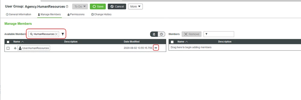

1. Open the Agency.HumanResources User Group.
2. Click on the Manager Members tab.
3. Filter and select the User you want to add in the Available Members section. In this case, User.HumanResources.
4. Click the arrow on that User’s row or drag and drop the User to the Members section.
5. Click Save.
6. Repeat steps 1-5 for each department User Group you created earlier with their corresponding User.

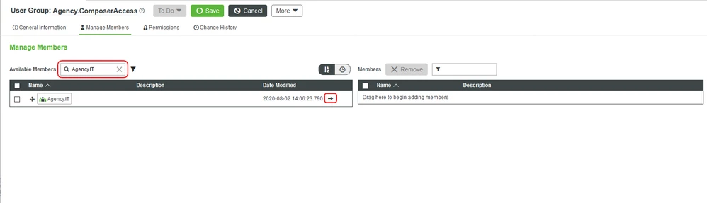

We should have an extra User Group (Agency.ComposerAccess) and an extra User (User.AgencySuperUser). We will utilize these Entities below. For now, only our IT department needs access to the ThingWorx Composer.

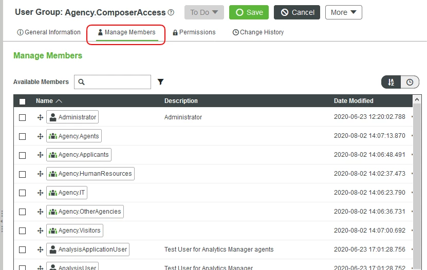

1. Open the Agency.ComposerAccess User Group.
3. Filter and select the User Group you want to add in the Available Members section. In this case, Agency.IT.
4. Click the arrow on that User’s row or drag the User to the Members section.
5. Click Save.

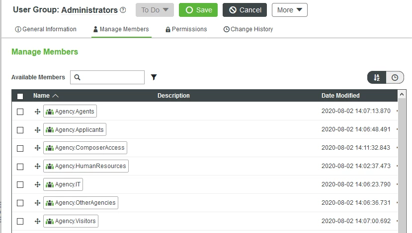

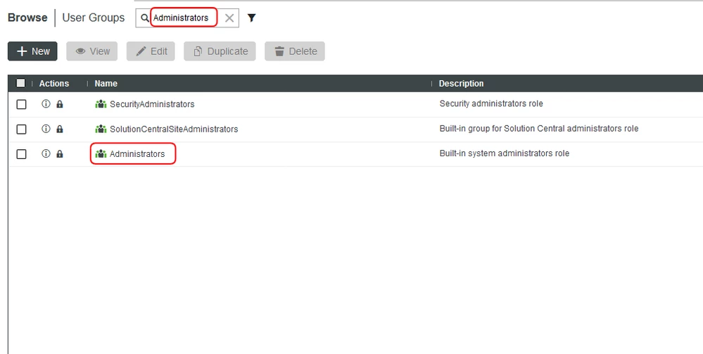

Our super user will need top level access to everything in ThingWorx. To do this, we will add the User to the Administrators User Group.

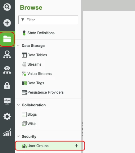

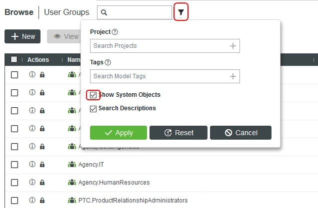

1. On the left-hand side of the ThingWorx Composer, click Browse.
2. Click on User Groups on the left panel.
3. At the top of the screen, click the filter button near the search bar.
4. Check the checkbox for Show System Objects and click Apply.

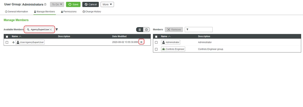

5. Filter and select the Administrators User Group.
6. Click on the Manager Members tab.
7. Filter and select the User you want to add in the Available Members section. In this case, User.AgencySuperUser.
8. Click the arrow on that User’s row or drag the User to the Members section.
9. Click Save.

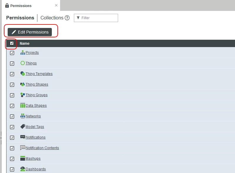

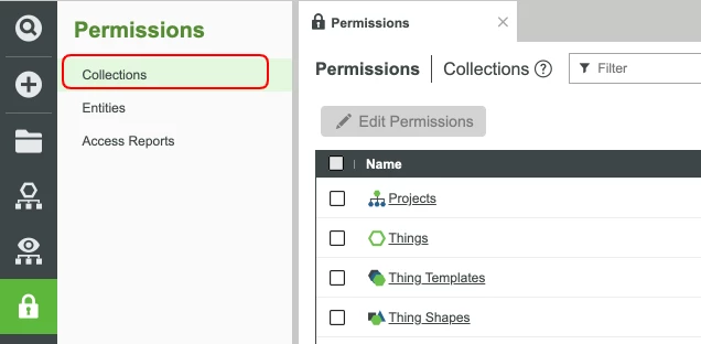

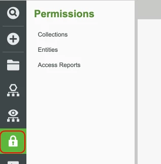

1. On the left panel, select Permissions.
2. Click Collections on the menu that appears.

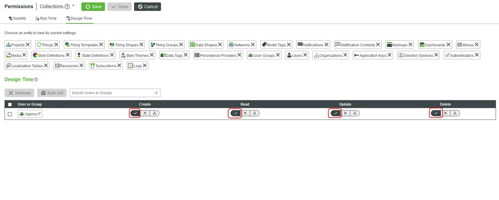

3. Select the checkbox at the top to select all available Entities then click Edit Permissions.

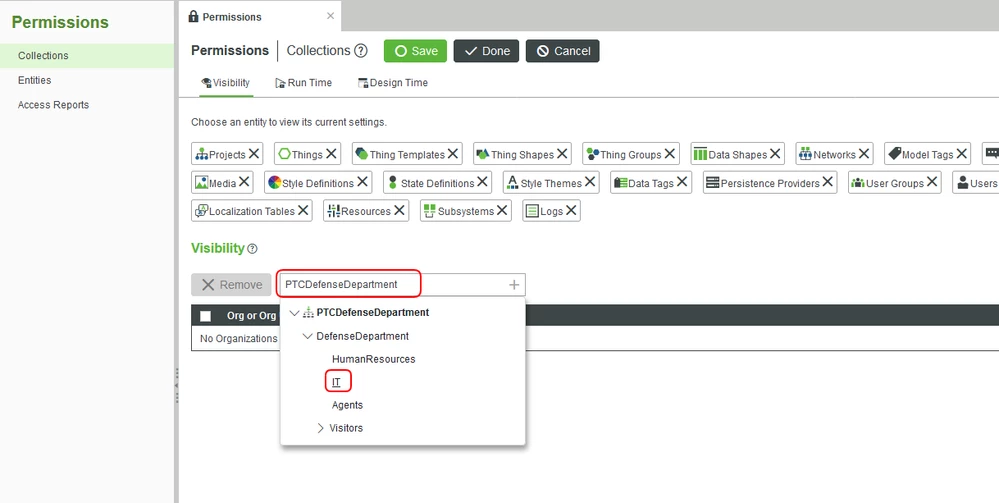

4. On the Visibility tab, click the + button in the Search Organizations filter.
5. Enter PTCDefenseDepartment and click the expand arrows to select the IT department. A more granular Visibility level can be set on the specific Entities when created later in this learning path.

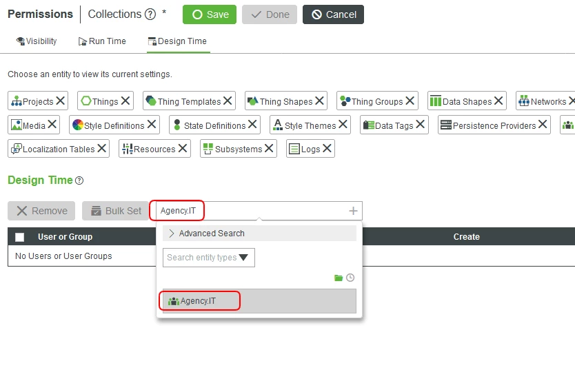

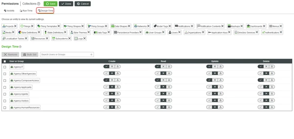

6. Select the Design Time tab.
7. Enter Agency.ComposerAccess in the search bar and select the Agency.ComposerAccess User Group.
8. Select the check marks for Create, Read, Update, and Delete. A more expansive design for a production environment would create more Users and User Groups to have such access.
9. Set the permissions for the other groups we have created to not allow any Create, Read, Update, and Delete permissions for groups outside of Agency.ComposerAccess and Agency.IT. It should look like the below configuration.

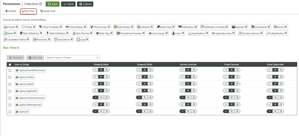

10. Set the same permissions in the Run Time tab for the User Groups we have created.
11. Click Save.
