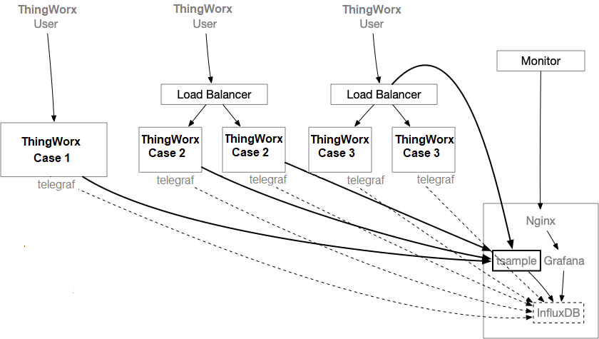

Recommended Deployment Architecture
tsample can be deployed in the same box where ThingWorx Tomcat is running, but it's recommended to deploy it on a separated box to minimize any performance impact caused by the collector. tsample supports export to InfluxDB and/or local file. In this document, it is assumed that InfluxDB will be used for monitoring purpose. Please note that this is not the same instance of InfluxDB being used by ThingWorx (if configured). This article will not cover setting up InfluxDB or NGINX (if necessary), so please configure these before beginning this tutorial.

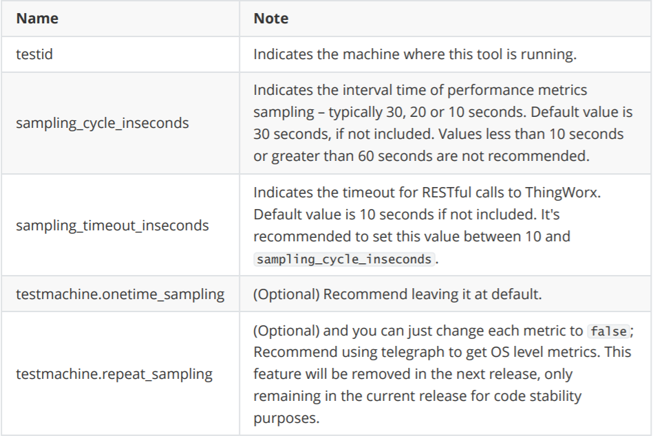

TestMachine section
This is section is required, and it defines where this tool will run.

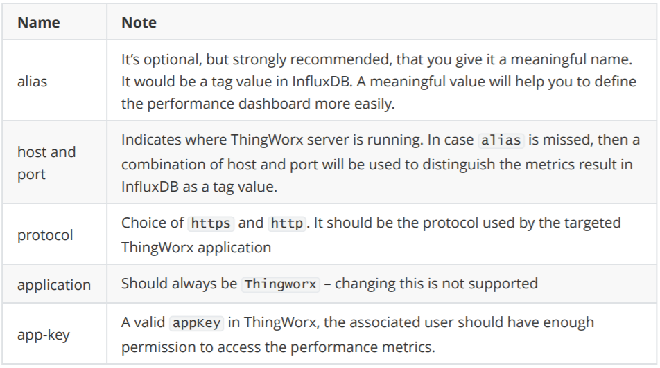

thingworx_servers section
This section is where you define targeted ThingWorx applications. Multiple ThingWorx servers can be defined with the same or different metrics to be collected.

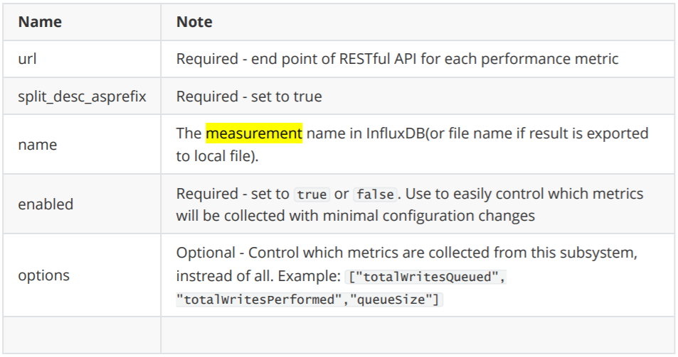

thingworx_servers.metrics sections
Underneath each thingworx_servers section, there are several metrics. In default example,
following metrics have been included:
  • ValueStreamProcessingSubsystem
  • DataTableProcessingSubsystem
  • EventProcessingSubsystem
  • PlatformSubsystem
  • StreamProcessingSubsystem
  • WSCommunicationsSubsystem
  • WSExecutionProcessingSubsystem
  • TunnelSubsystem
  • AlertProcessingSubsystem
  • FederationSubsystem

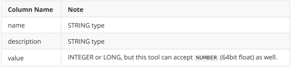

You can add your own customized metrics, as long as the result follows the same Data Shape. The default Data Shape has 3 columns:
If the output Data Shape exceeds this limit, the tool will likely not work properly.

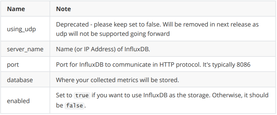

result_export_to_db section
This section defines the target InfluxDB as a sink of collected performance metrics.

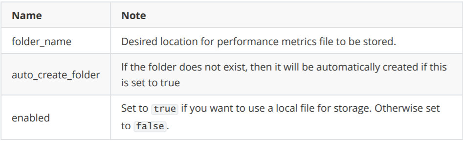

result_export_to_file section
This section defines the target file storage for collected performance metrics.

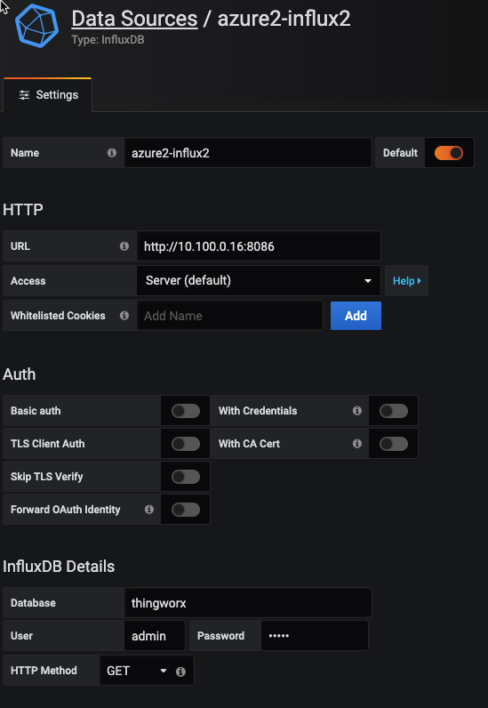

Step 1. Connect Grafana to InfluxDB

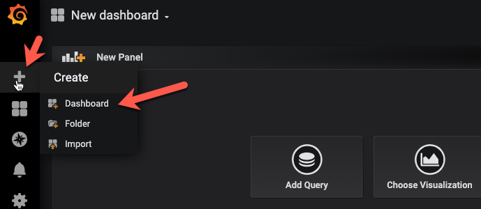

Step 2: Create a New Dashboard

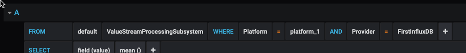

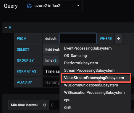

Step 3. Create a New Query
Depending on which metrics you defined to collect in the tsample configuration file, you will see a different choice of measurement in Grafana. Here, we will use ValueStreamProcessingSubsystem as an example.
Step 4. Choose the Right Platform and Storage Provider
Some metrics depend on the database storage provider, like Value Stream and Stream.

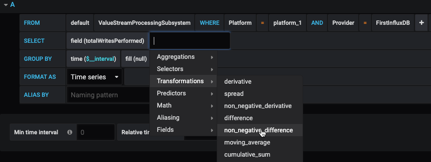

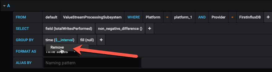

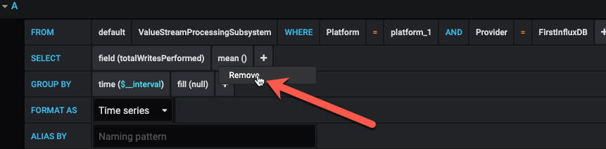

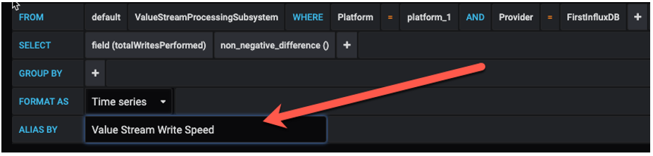

Step 5. Choose the Metrics Figures
Select "remove" to get rid of the default 'mean' calculation.
Select "non_negative_difference" from Transformations. Using this transformation, Grafana can show us the speed of writes.
Then, remove the default GROUP BY "time" clause.
Assign a meaningful alias of this query.

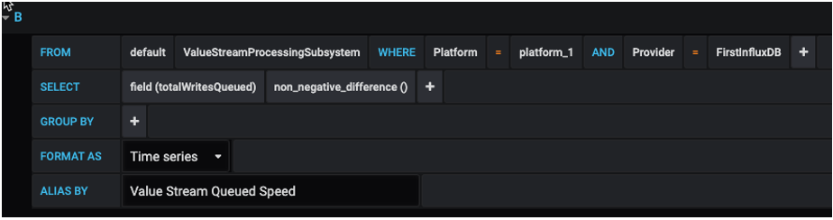

Step 6. Add Another Query
You can add another query as 'Value Stream Queued Speed' by following the same steps.

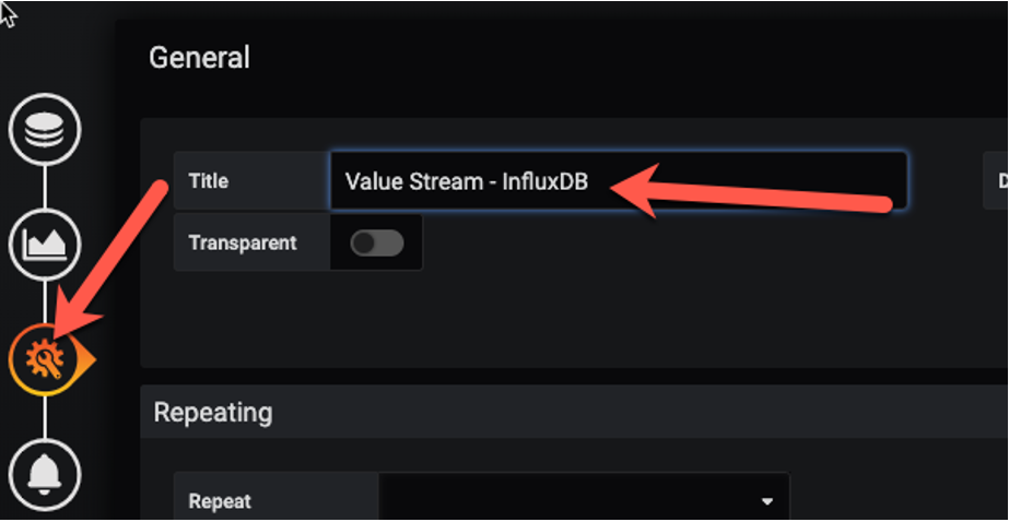

Step 7. Assign a Panel Title

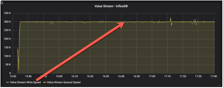

Step 8. Review the Result

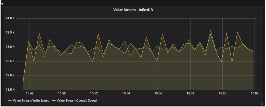

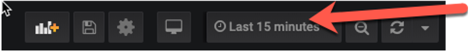

Let's go back to the dashboard page and select "last 15 minutes" or "last 5 minutes" from the top right corner. It should show a result similar to the chart below.

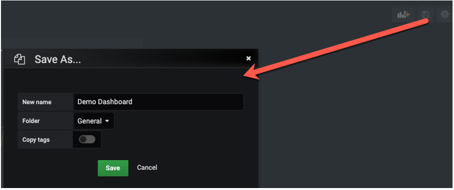

Step 9. Save the Dashboard
Don't forget to save your dashboard before we add more panels.

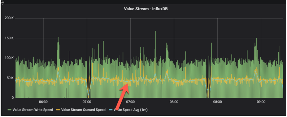

It's difficult to figure out the high-level write speed from the above panel, so let's enhance it.

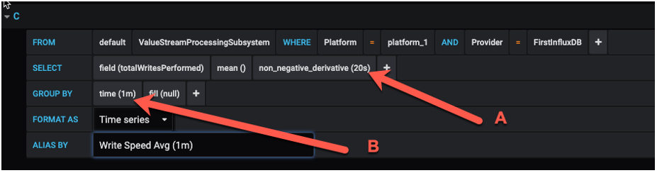

Add a new query with the following configuration:

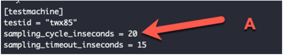

In the above query, there are two additional figures: 20s and 1m... How do you choose? 20s should be the same as sampling_cycle_inseconds in your tsample configuration file. If you choose a different value, then you could end up with misleading results.
Larger values such as "1m" may give you a smoother result, but they could also hide system instability. Going larger than 1m is not recommended in most cases.
With this new query, it's much easier to figure out what the average write speed in current testing is.

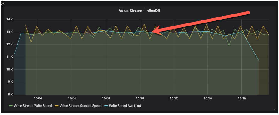

Tips: if your sampling_Cycle_inseconds is 30s, then you may not need this additional query. The following image is a sample at the 30s interval time. You would not need an additional average query to get a smooth write speed.
The next example is a sample at the 10s interval time. Without additional queries, you may not be able to get a meaningful understanding of the write speed.
From the above three examples, it's recommended to configure the sampling interval time at 30s, or anything larger than 20s. You can then choose whether you need additional queries based on the visualization result.

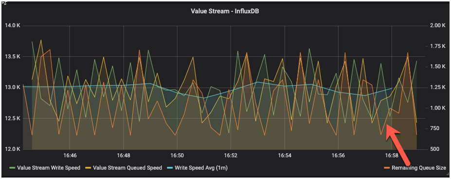

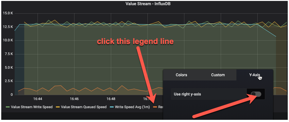

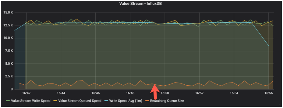

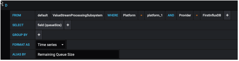

The above charts illustrate the queuing and writing speed. However, it is possible that the Value Stream may perform at a reasonable speed, but the Value Stream queue may be growing and could exceed its capacity. Let's add another query to monitor this:
However, it is difficult to read this chart, since it has a different value range on the y-axis:
Let's move this query to a second y-axis on the right:
This will make the view much easier to see:
The current queue size or remaining queue size will always move up and down; it is healthy as long as it does not continue to grow to a high level.

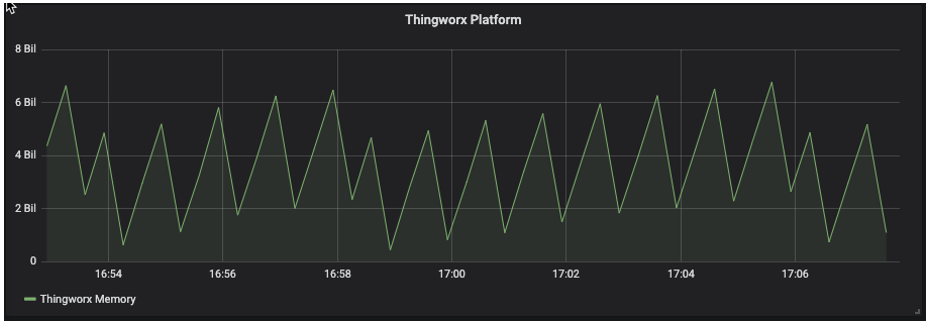

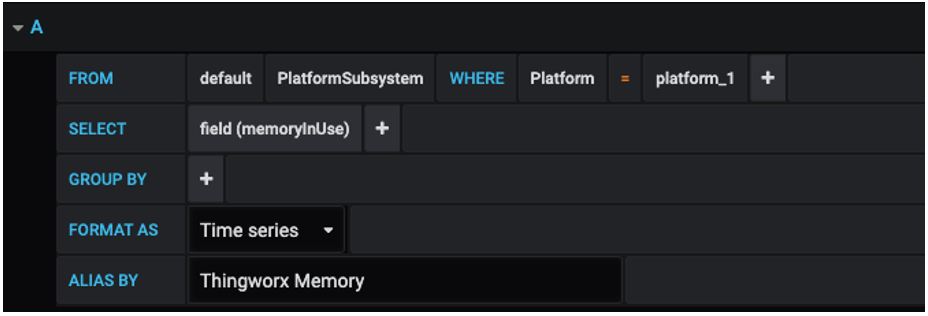

ThingWorx Memory Usage Monitoring
Create a new panel and add a new query:
In a running system, memory usage will always move up and down - at times sharply or quickly - when the system is busy. The system is healthy as long as memory doesn't go up continuously or stay at a maximum for a long period of time.

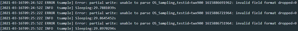

I only have three questions:
1. I am getting an error message, and I am not able to figure out what it means. Running on docker by the way. Can you help me with that?
