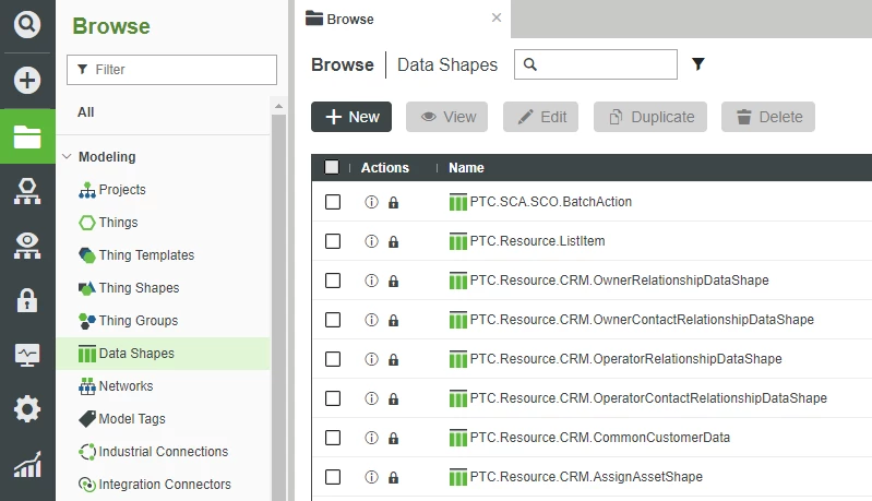

Step 2: Create Data Shape
In this scenario, we'll store the Pareto Chart's data in a Property type called an Info Table.
An Info Table is a spreadsheet-like Property, but in order to define the columns of the table, we first have to define a Data Shape. We'll do that in this step.

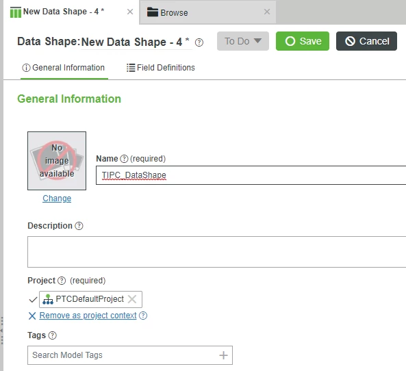

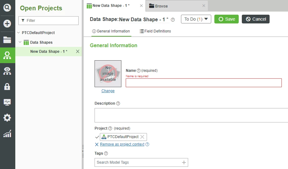

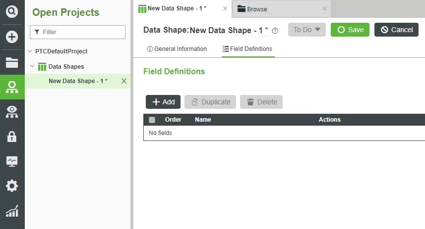

  1. In the left-side navigation, click Browse > Modeling > Data Shapes.
  2. At the top, click + New.
  3. In the Name field, type TIPC_DataShape.
  4. If Project is not already set, search for and select PTCDefaultProject.

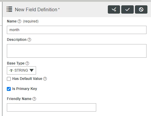

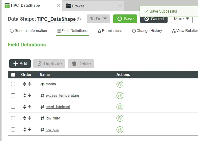

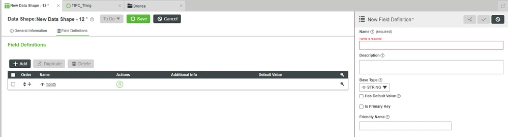

  5. At the top, click Field Definitions.
  6. At the top-left, click + Add.

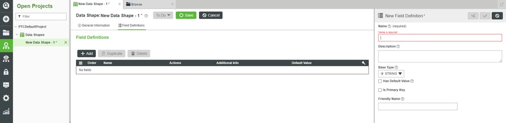

  7. On the right-side slide-out, in the Name field, type month.
    • Note that you want to leave "Base Type" as the default of "STRING".
  8. Check Is Primary Key.
  9. Click the "check with a plus" button for Done and Add.

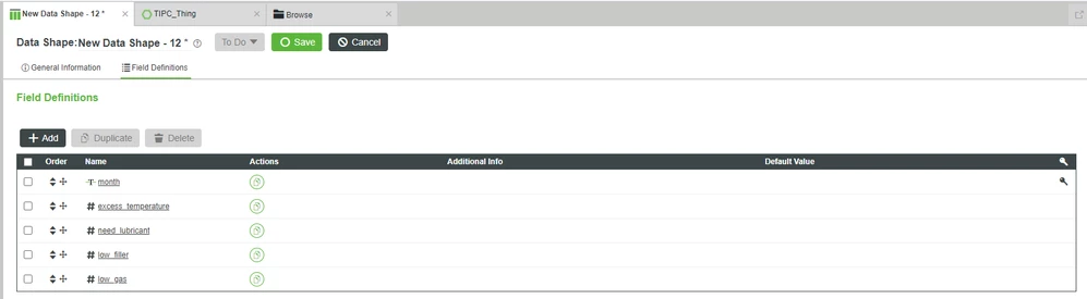

  10. Add each of the following Field Definitions, entering the Name and selecting the Base Type from the drop-down as described in the table:
    • Note that you will NOT enable "Is Primary Key" on any other Field Definitions, as you only need one Primary Key.
    • Note that you will simply click the "check" button for Done after the last entry
      NameBase Type
       excess_temperatureNUMBER
       need_lubricantNUMBER
       low_fillerNUMBER
       low_gasNUMBER
  11. At the top, click Save.

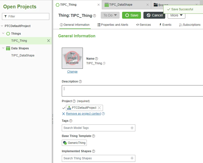

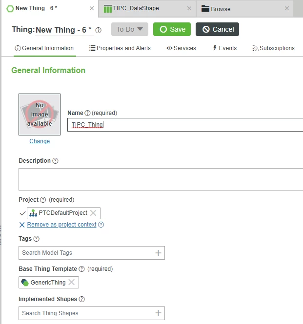

Step 3: Create Thing
Now that we have our Data Shape, we can create a Thing to hold the collected counts of various issues.
As already mentioned, we'll use an Info Table Property, formatted by the previously-created Data Shape, to do so.

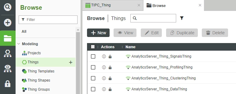

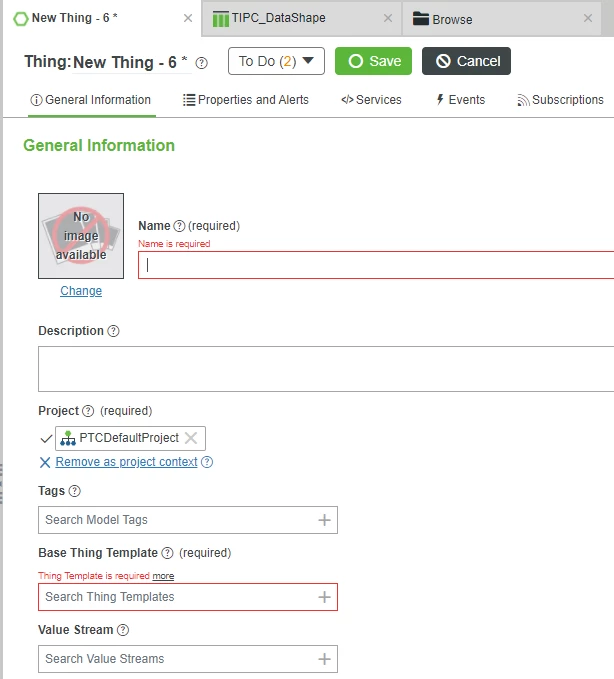

  1. Click Browse > Modeling > Things.
  2. Click + New.
  3. In the Name field, type TIPC_Thing.
  5. In the Base Thing Template field, search for and select GenericThing.
  6. At the top, click Save.

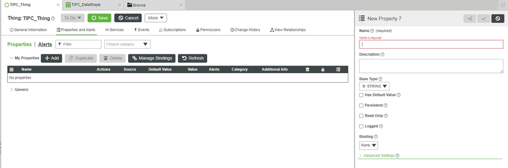

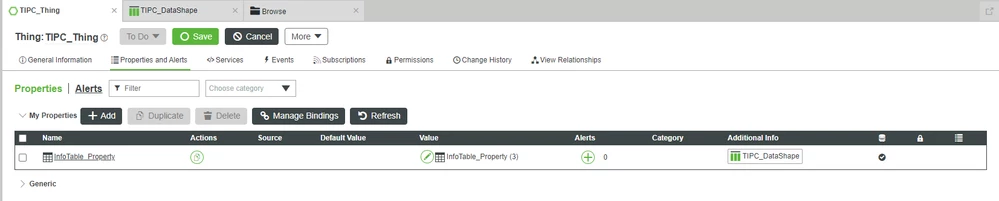

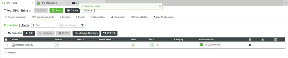

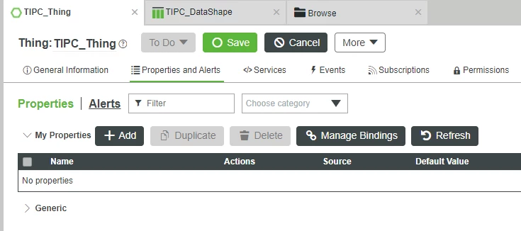

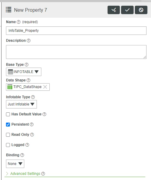

Add Info Table Property

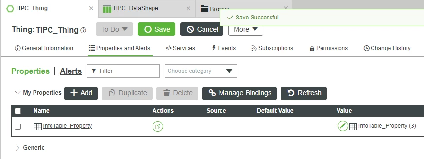

Now that we have our Thing instantiated, we want to both add an Info Table Property, as well as set some Default Values.
  1. At the top, click Properties and Alerts.
  2. Click + Add.
  3. On the right-side slide-out, in the Name field, type InfoTable_Property.
  4. Change Base Type to INFOTABLE.
  5. In the Data Shape field, search for and select TIPC_DataShape.
    • Note that the Data Shape field will not appear until you set Base Type to INFOTABLE.
  6. Check Persistent.
  7. At the top-right, click the "check" button for Done.
  8. At the top, click Save.

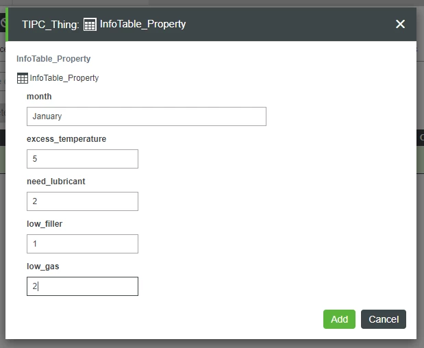

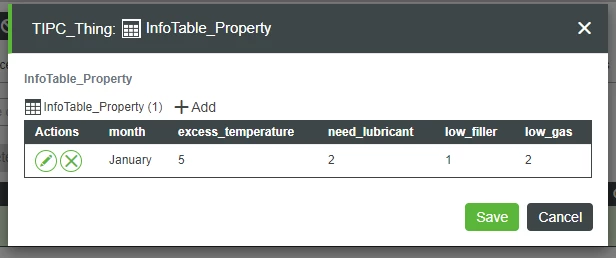

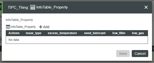

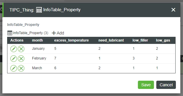

Set Value of Property
Now that we have a place in which to store spreadsheet-like values, we'll do so manually for testing.

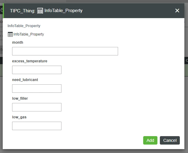

  1. On the InfoTable_Property row, under the Value column, click the "pencil" icon for Set value of property.
  2. On the pop-up, click + Add.
  3. Enter the following values in each field as per the table below:
    Field NameValue
    month January
    excess_temperature5
    need_lubricant2
    low_filler1
    low_gas2
  4. Click Add.
  5. Click + Add again, enter the following values, and finish input by clicking Add, as per above.
    Field NameValue
    monthFebruary
    excess_temperature7
    need_lubricant1
    low_filler3
    low_gas2
6. Click + Add again, enter the following values, and finish input by clicking Add, as per above.
Field NameValue
monthMarch
excess_temperature6
need_lubricant2
low_filler1
low_gas1
7. On the pop-up, click Save.

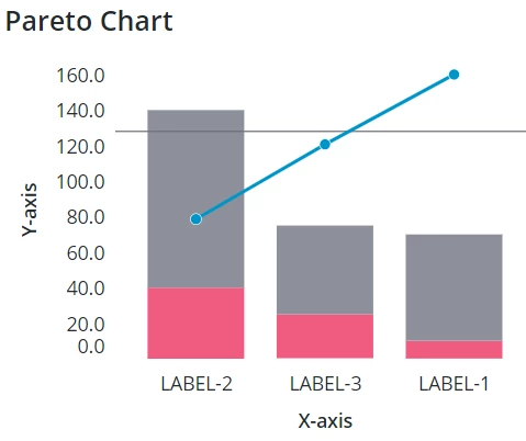

Step 4: Create Mashup
Now that we have our data in-place for testing (and could be connected to automated systems after we finish testing), we need to visualize the data.

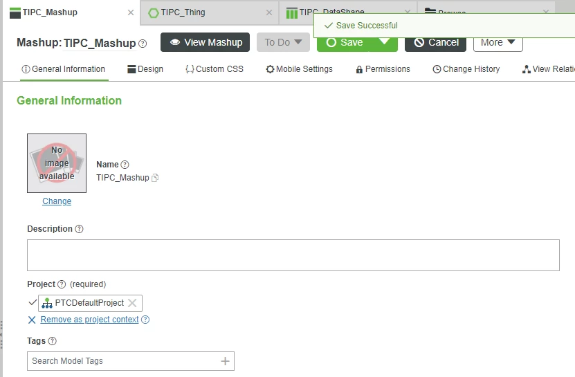

As mentioned, we'll use a Pareto Chart Widget, but first, we need to create a Mashup into which we can place the Widget.

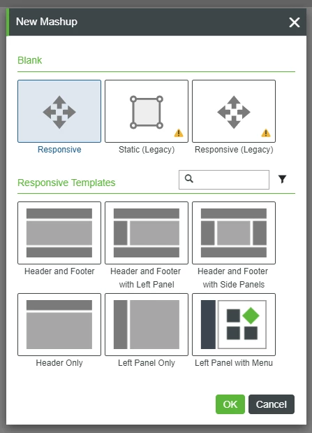

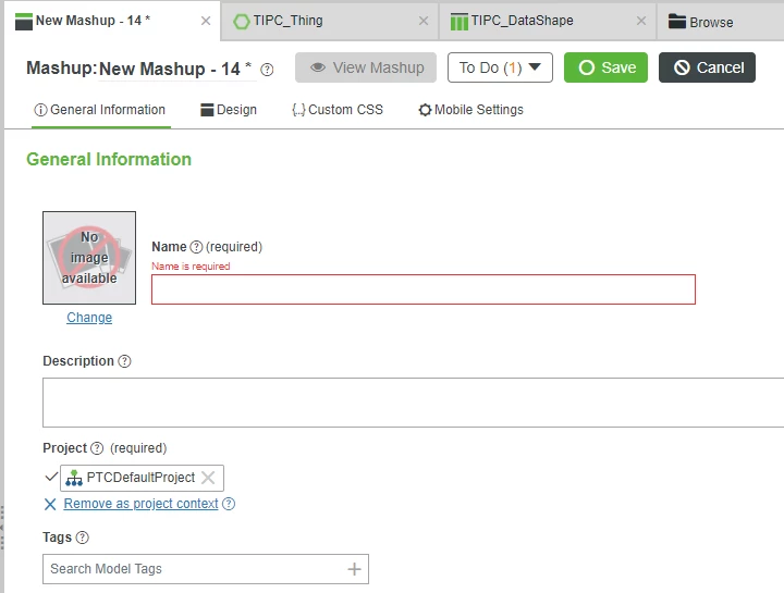

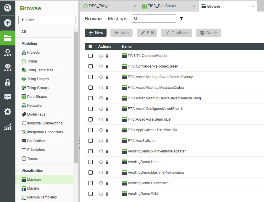

  1. Click Browse > Visualization > Mashups.
  2. Click + New.
  3. Leave the defaults and click OK.

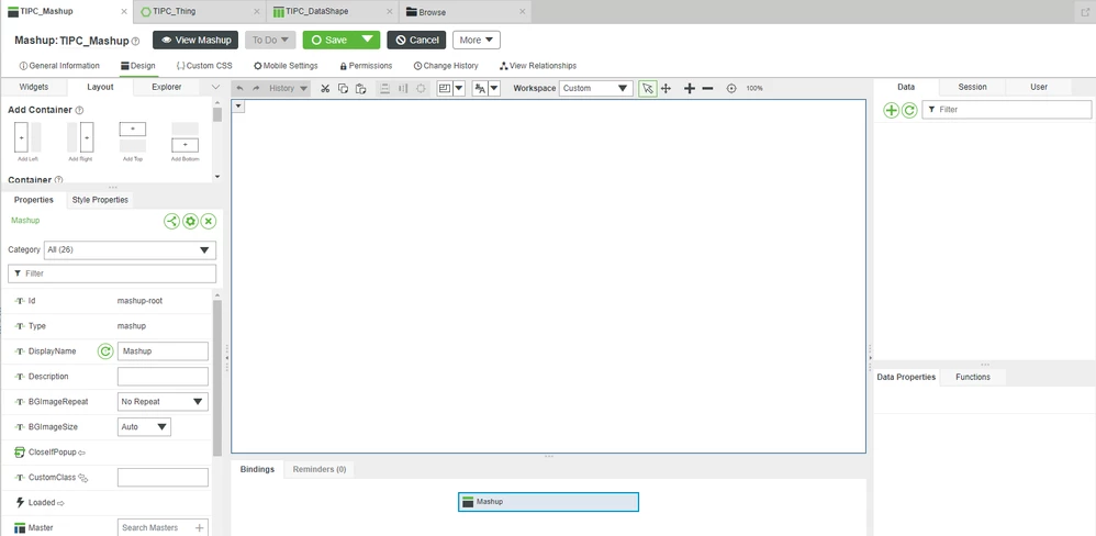

  4. In the Name field, type TIPC_Mashup.
  5. If Project is not already set, search for and select PTCDefaultProject.

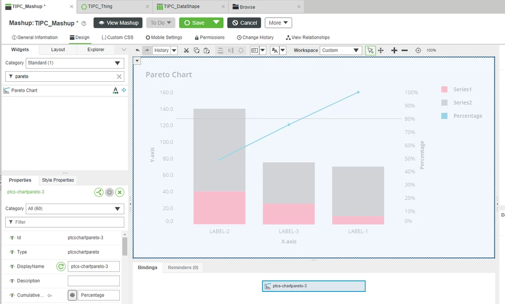

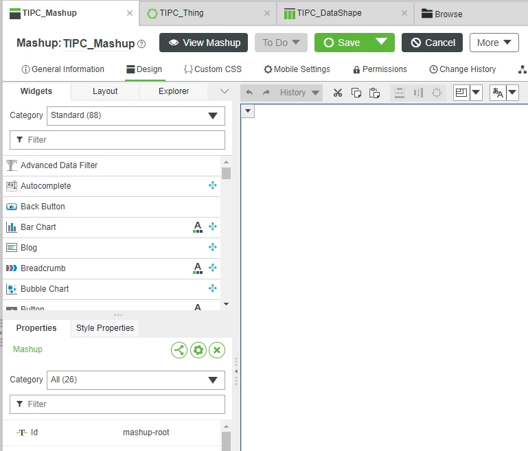

  7. At the top, click Design.
  8. At the top-left, click the Widgets tab.
  9. Drag-and-drop a Pareto Chart Widget onto the central Canvas.
  10. At the top, click Save.
