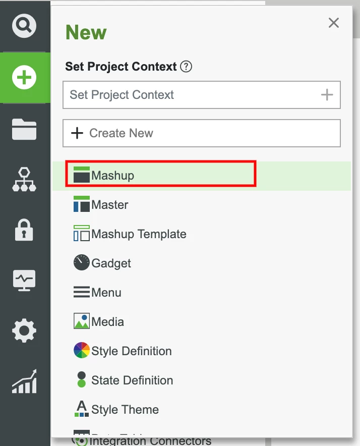

  1. In the ThingWorx Composer, click the + New at the top of the screen.

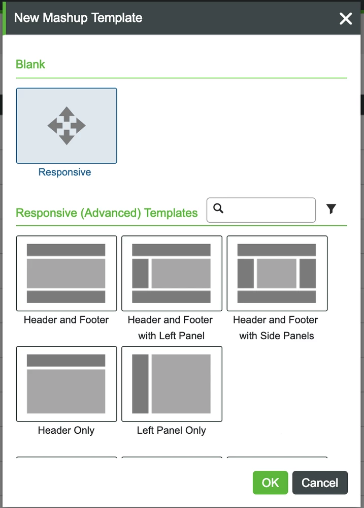

  2. Select Mashup  in the dropdown.
3, Select Responsive for the layout option.
4. Click Ok.

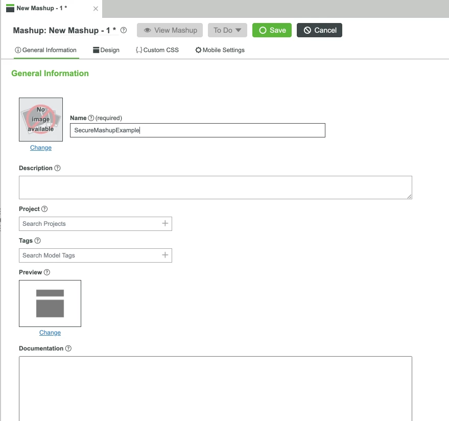

5. Enter a name for the Mashup Template, such as SecureMashupExample.

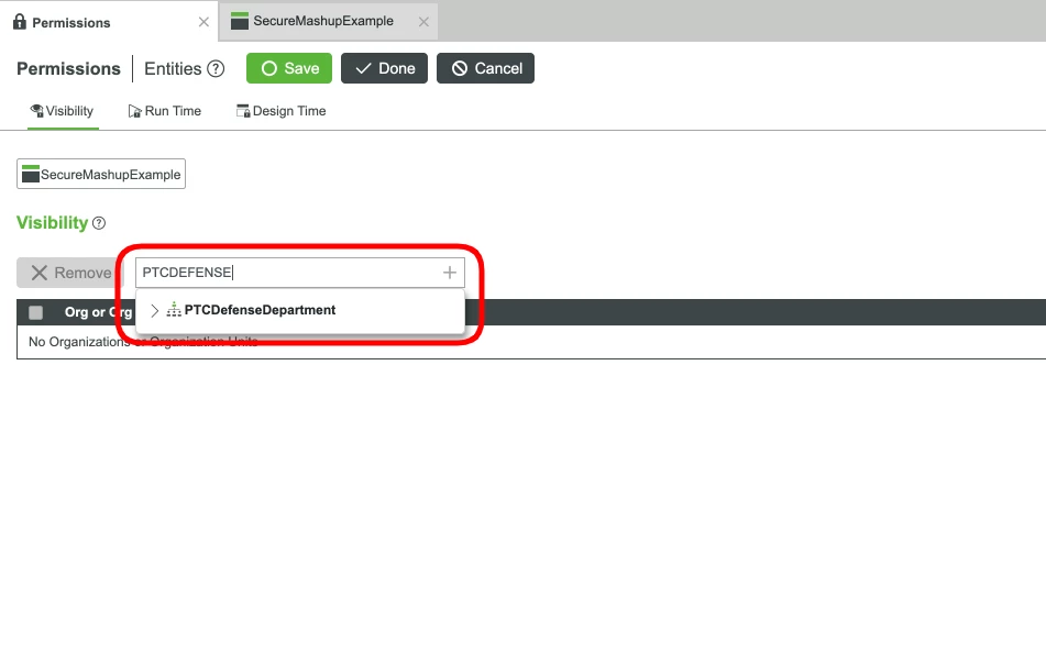

6. Click Save then click the Permissions tab.
7. On the Visibility tab, in the Search Organization text box, begin typing and select PTCDefenseDepartment. This allows anyone in the organization to be able to access this Mashup.

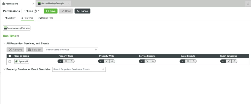

8. On the Runtime tab, in the Search Users and User Groups text box, begin typing and select Agency.IT.
 9. Set all permissions to Allow (check). This allows a User Group to run services during Runtime of your application. Keep in mind, this gives permissions to all parts of the Mashup (Events, Subscriptions, Services, Parameters).

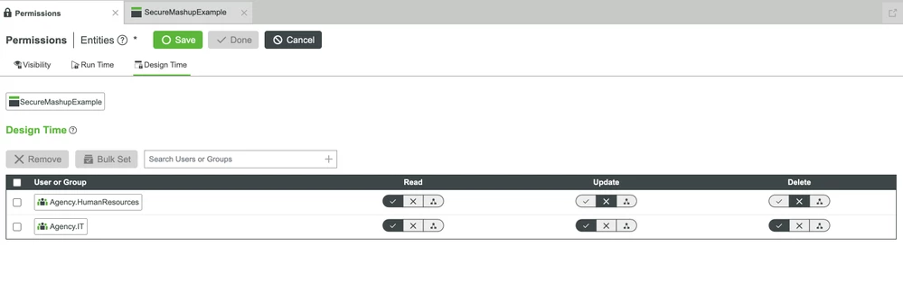

 11. On the Design Time tab, the Search Users and User Groups text box, begin typing and select Agency.IT.
 12. In the Search Users and User Groups text box, begin typing and select Agency.HumanResource.
13. For Agency.IT, set the permissions to allow Read, Update, and Delete. For the Agency.HumanResource User Groups allow Read and deny Update and Delete.

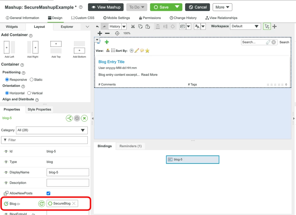

  1. Open the SecureMashupExample Mashup and click on the Design tab.

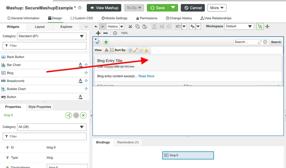

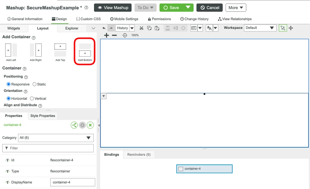

  2. Click the Layout panel in the top left and add a Bottom Container.
  3. In the Widgets panel, drag and drop a Blog Widget to the top container.

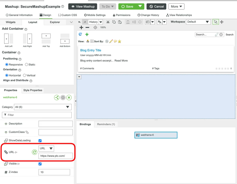

  4. Drag and drop a Web Frame Widget to the bottom container.
  5. Select the Blog Widget in the top container. In the Properties panel, update the Blog property to any existing or new Blog entity (there is a Blog in the provided download).
  6. Select the Web Frame Widget in the bottom container. In the Properties panel, update the URL field to a website you trust. In this case, I'll be using https://www.ptc.com/.
  7. Click Save and View Mashup.

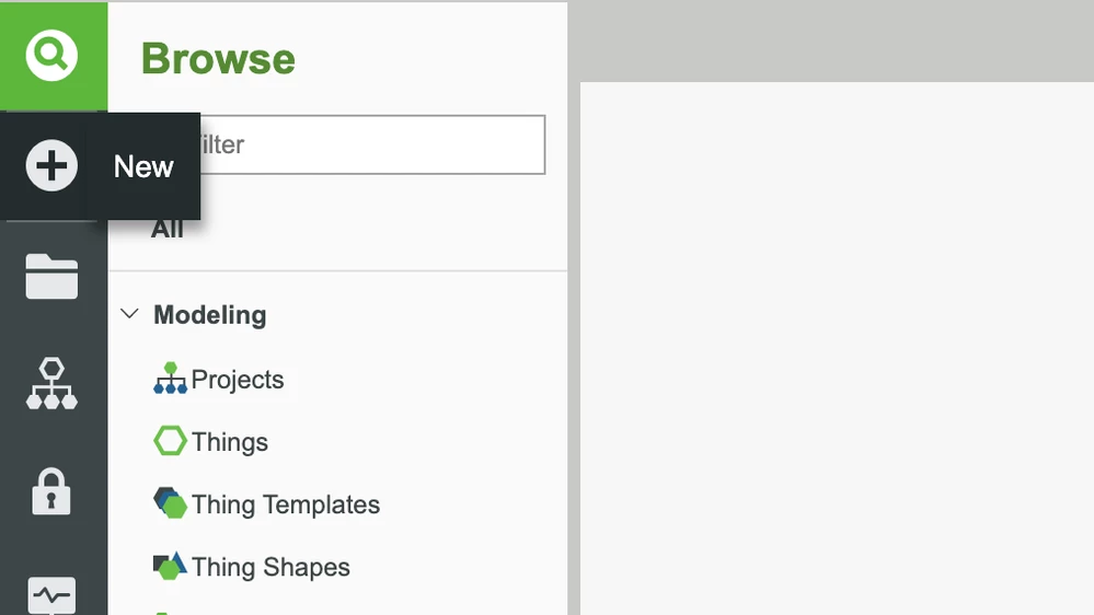

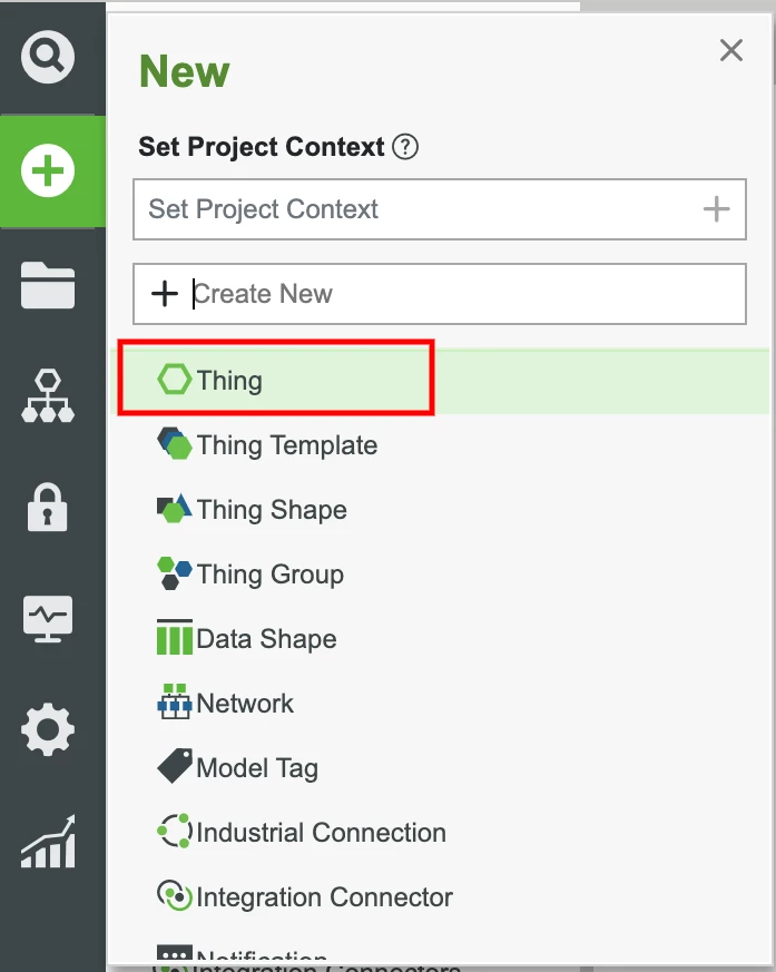

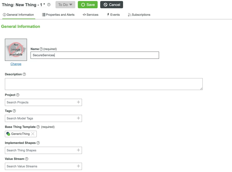

  2. Select Thing in the dropdown.
  3. In the name field, enter SecureServices and select GenerticThing as the Base Thing Template.
  4. Click Save and go to the Services and Alerts tab.

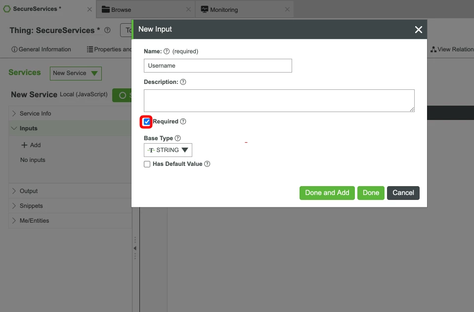

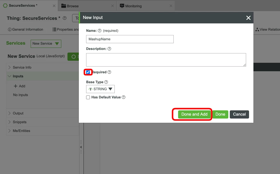

  7. Click the Input section and add a required String parameter named MashupName. Click Done and Add.
  8. Add a second String parameter named Username that is required. Click Done.

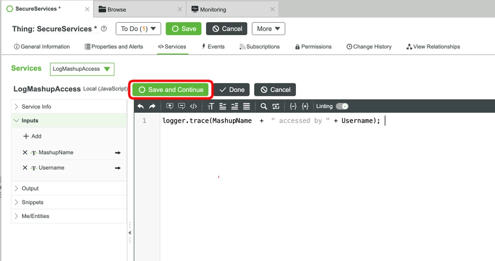

  9. Enter the below lines of code into the canvas. It will be a simple log statement for tracking. We can add a lot more to this method if we liked.
    logger.trace(MashupName  +  " accessed by " + Username);
  10. Click the green Save and Continue button to save your work.

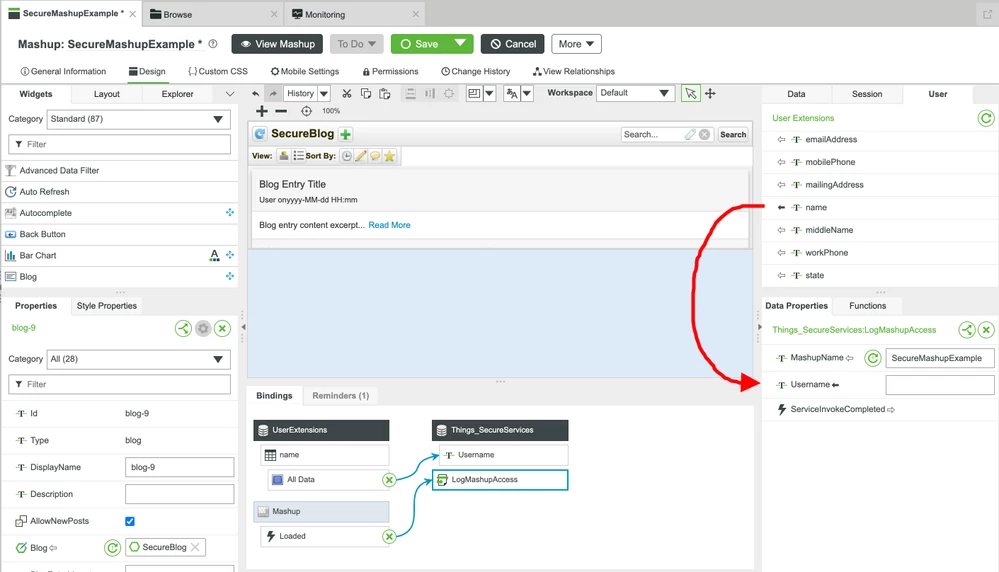

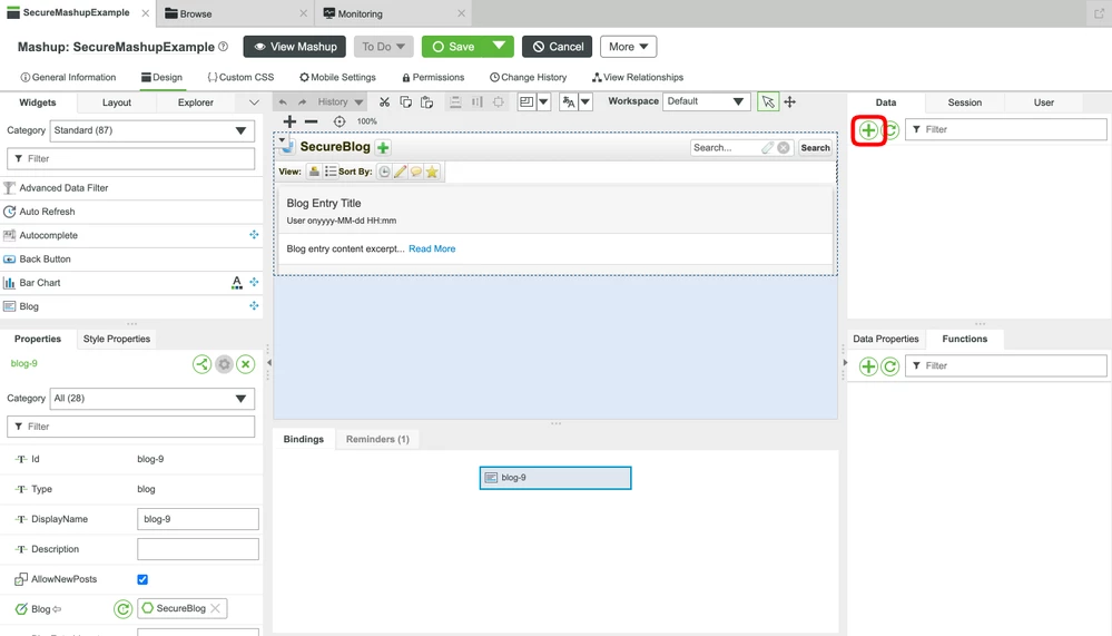

  1. Go back to the SecureMashupExample Mashup.

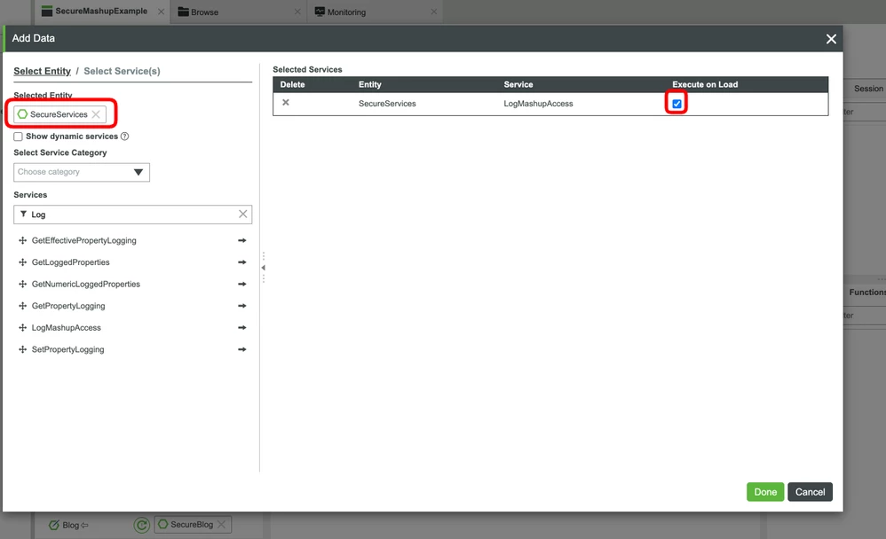

  2. In the Data panel, click the + button to add a service.
  3. Search for our new SecureServices Entity, then add the LogMashupAccess service. Ensure the Execute on Load checkbox is checked.
  4. Click Done.

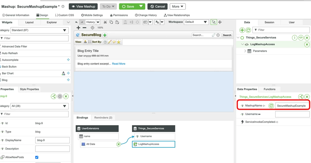

  5. Select the LogMashupAccess service. In the Data Properties panel in the lower right.
  6. In the MashupName text box, enter SecureMashupExample.
  7. Select the User panel in the top right.
  8. Drag and drop the name field to the Username parameter.
9. Click Save.
You now have a Mashup that will log the UI being opened and the user accessing that UI whenever it is opened. Click View Mashup and go to the ScriptLog in order to test. You filter will need to be set to All or at least Trace to see the log statement.

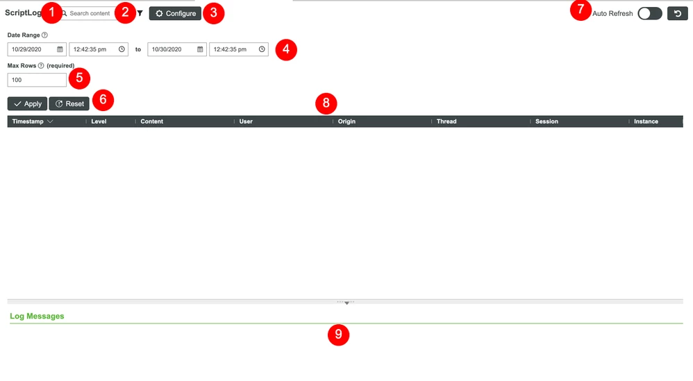

Data logging and filtering is one of your most powerful tools not only in the ThingWorx environment, but in developing solutions. The next section of this learning path will go in depth about what each of these items in a Monitoring screen does. It will also cover tricks to help your search. For now, let's look at how we can view logs and filter them to find what we need.
No. ItemUsage
1 Search Bar Search the log for key words and phrases.
2 Filter Button Provides a list of options to fine tune your search. This menu is very powerful.
3 Log Configurations Select what level of logging you'd like to see.
4 Date Range A date range filter to help limit or set your specific date options.
5 Max Row Count The max number of rows to search for and return. The search will continue until this number is met or your other search filters have been met (ie, date range).
6  Apply/Reset Buttons Apply the changes for your date range and max account or reset these values to their defaults.
7 Refresh/Auto Refresh ButtonsAllow the log to continue based on your filters (if any) without you having to refresh. You can also refresh it on your own.
8 Log Header and List The logs that were found based on your filters or settings.
9 Selected Log View After selecting a log item in the list, it will be shown here.
