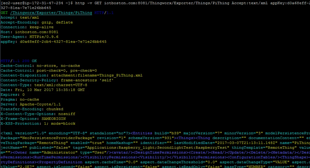

Download Things By Name
The REST API can be used to export a file representation of Things on a ThingWorx Foundation server. The downloaded file can be imported to another ThingWorx server making the Thing available for use.
Required Parameters
- AppKey created by your Foundation server
- Name of the Thing
Request
- Construct the URL. Retrieve the components of a Thing by making an HTTP GET to the endpoint. Substitute <name of Thing> with the actual name of a Thing that exists on the ThingWorx server that wil be downloaded.
<Server IP:port>/Thingworx/Exporter/Things/<name of Thing>
- Send request parameters. No parameters are sent.
- Authenticate the Request. All API requests to the ThingWorx server must be authenticated either with a username and password or with an appKey. For this example we will authenticate by passing the appKey as a URL query string parameter. The parameter appKey is recognized by the ThingWorx server as an authentication credential in requests, it can be passed either as a URL query string parameter .../CreateThing?appKey=64b87... , or as request header appKey: 64b87...
Response
It is possible for the content to be returned in two different formats by sending an Accept header with the request.
| Desired Response Type |
Accept Header Values |
| JSON | application/json |
| XML | text/xml |
| HTML | text/html (or omit Accept Header) |
| CSV | text/csv |
A successful call to download a Thing will return a file in the body of the response suitable for importing into a ThingWorx Foundation server.
HTTPie example:
http -v GET iotboston.com:8081/Thingworx/Exporter/Things/PiThing appKey==d0a68eff-2cb4-4327-81ea-7e71e26bb645 Accept:text/xml

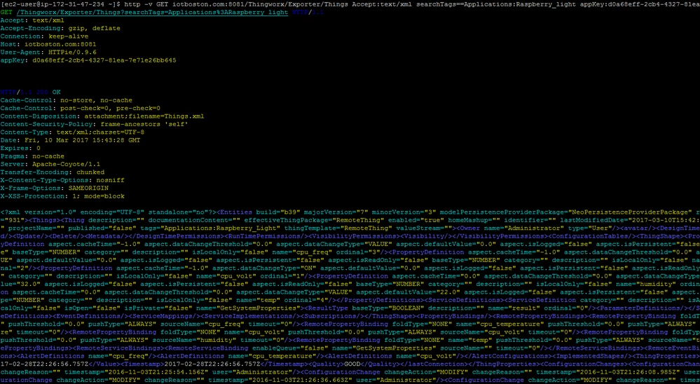

Download Things By Tag
The REST API can be used to export a file representation of Things on a ThingWorx Foundation server. This file can be imported to another ThingWorx server making the Thing available for use.
Required Parameters
- Name of the Tag
Request
<Server IP:port〉/Thingworx/Exporter/Things
- Send request parameters. The Tag name is sent as a request parameter named:
searchTags
Response
| XML | text/xml |
| CSV | text/csv |
HTTPie example:
http -v GET iotboston.com:8081/Thingworx/Exporter/Things searchTags==Applications:Raspberry_light appKey==d0a68eff-2cb4-4327-81ea-7e71e26bb645 Accept:text/xml

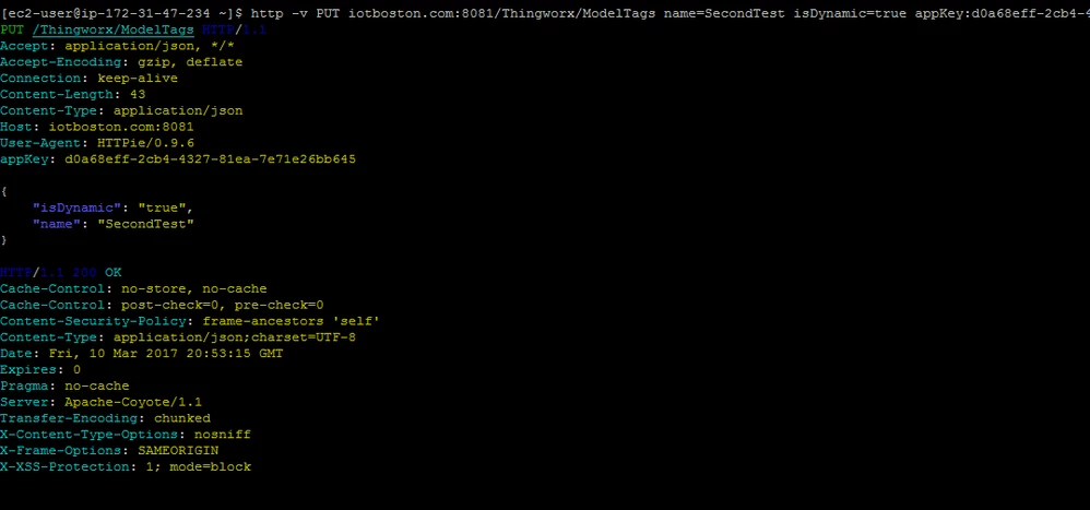

Create New Tag
You can use the REST API to create a new dynamic Tag vocabulary.
Required Parameters
- Name of Tag Vocabulary
Request
- Construct the URL. Create a new Tag Vocabulary by making an HTTP PUT to this endpoint:
〈Server IP:port〉/Thingworx/ModelTags
- Send Request Parameters. The name of the new DataShape and the name of the base DataShape that the new DataShape extends are sent in the body of the POST as a JSON object. For example, the JSON object below will create a new DataShape named SomeTestDataShape using the system template GenericThing.
"name": "SecondTest",
"isDynamic": "true"
- Authenticate Request. All API requests to the ThingWorx server must be authenticated either with a username and password or with an appKey. For this example we will authenticate by passing the appKey as a URL query string parameter. The parameter appKey is recognized by the ThingWorx server as an authentication credential in requests, it can be passed either as a URL query string parameter .../CreateThing?appKey=64b87... , or as request header appKey: 64b87...
Response
A successful call to the ModelTag Service does not return any content in the body of the response, only an HTTP 200 is returned.
HTTPie example:
http -v -j PUT http://52.201.57.6/Thingworx/ModelTags name=SecondTest isDynamic=true appKey==64b879ae-2455-4d8d-b840-5f5541a799ae
Warning for other HTTP clients: Most HTTP clients do not set a Content-Type header by default, without this header set the server will return an error message. The PUT request to the ModelTags endpoint has a JSON body so the header must be set to match the format of the request body. The Content-Type header does not appear in the sample HTTPie call because HTTPie sets the Accept and Content-type request headers to application/json by default. Below is an example cURL call that explicitly sets the Content-Type header to application/json.
curl -v -H "Content-Type: application/json" -X PUT -d '{"name": "SecondTest", "isDynamic":"true"}' http://52.201.57.6/Thingworx/ModelTags?appKey=d0a68eff-2cb4-4327-81ea-7e71e26bb645
