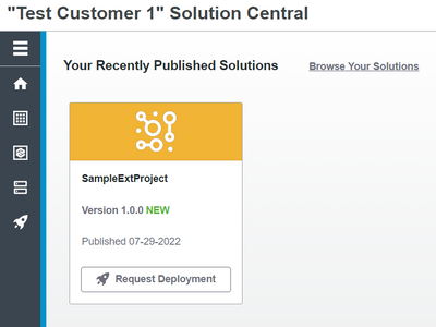

The published by parameter is necessary here, but it does not have to be a valid ThingWorx user for the request to work. If this request is successful, then the solution will show up as published in the SC Portal:

Another large issue that may come up is that requests often fail with a 500 error and without any message. There are often more details in the server logs, which can be reviewed internally by PTC if a support case is opened. Common causes of 500 errors include missing parameter values that are required, including invalid characters in the parameter strings, and using an API URL which is not the correct endpoint for the type of request. Another large cause of 500 errors is providing MD5 or hash values that are not valid (a mismatch will show differently).
Another common error is the 400 error, which happens if any of the code that SC uses to parse the request breaks. A 400 error will also occur if the files are not being opened or uploaded correctly due to some issue with the @ syntax (mentioned above).  Another common 400 error is a mismatch between the provided MD5 value for the zip or SHA file, and the one calculated by Azure ("message: Md5Mismatch"), which can indicate that there has been some corruption in the content of the upload, or simply that the MD5 values aren't being calculated correctly. The files will often say they have 100% uploaded, even if they aren't complete, errors appear in the console, or the size of the file is smaller than it should be if it were a complete upload (an issue with cURL).
Conclusion
Debugging with cURL can be a challenge. Note that adding "-v" to a cURL command provides additional information, such as the number of bytes in each request and a reprint of the parameters to ensure they were read correctly. Even still, it isn't always possible for SC to indicate what the real cause of an issue is. There are many things that can go wrong in this process, but when it goes right, it goes very right. The SC API can be entirely scripted and automated, allowing for seamless inclusion of externally-developed tools into a mature dev ops process.
