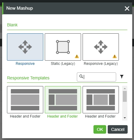

  1. In the top-left of ThingWorx Composer, click the Browse folder icon.
  2. Click VISUALIZATION > Mashups.
  3. Click + New.
  4. Select Responsive, then click OK.
    • A new Mashup tab will open.
  5. In the Name field, enter RWLP_Mashup.
  6. If Project is not already set, click the + in the Project text box and select the PTCDefaultProject.
  7. At the top, click Save.

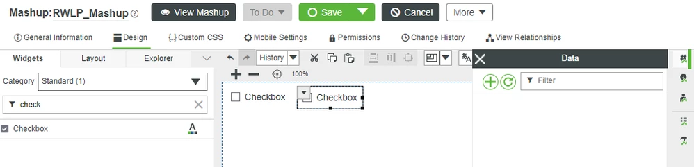

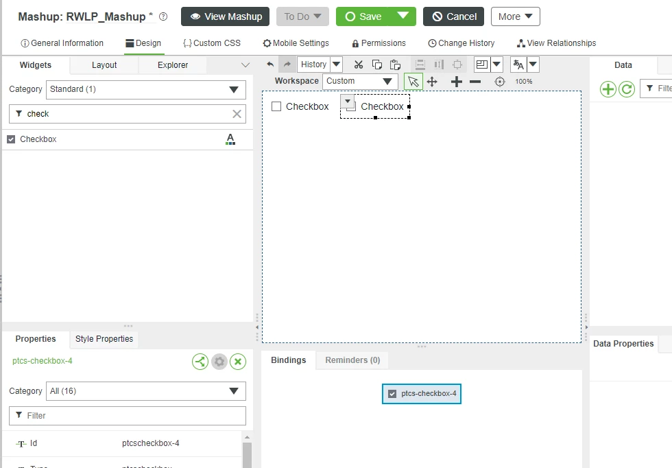

Step 3: Add Widgets
Widgets are drag-and-drop, stand-alone, graphical elements which you can add to your Mashup to represent certain pieces of backend data.

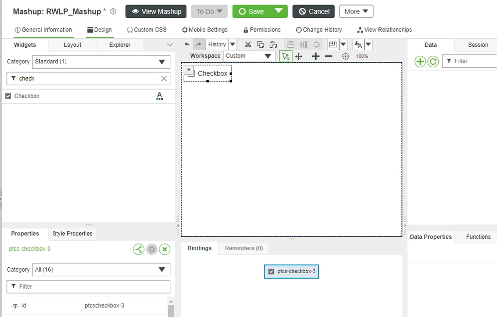

In this step, you will add a pair of Checkboxes to represent the PLC functionality.

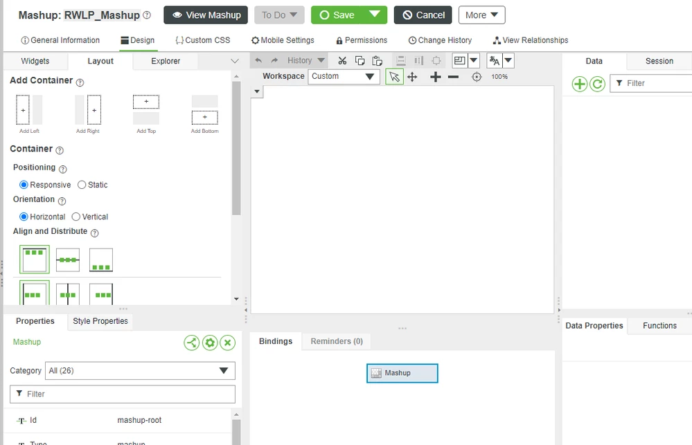

  1. At the top of the RWLP_Mashup tab, click Design.
    • It may take a few moments for the Mashup Builder interface to load.
  2. Click The Widgets tab, then In the Filter field on the left, enter check.
  3. Drag-and-drop a Checkbox widget onto the central Canvas area.
  4. Drag-and-drop a second Checkbox onto the Canvas.
  5. At the top, click Save.

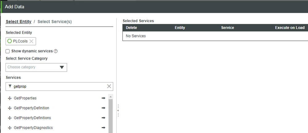

Step 4: Add Data

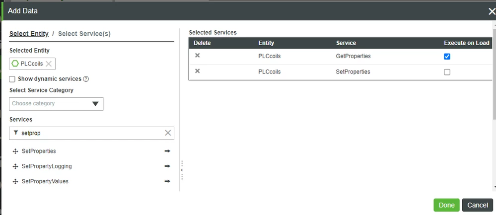

To have the Checkbox Widgets actually interact with the PLC, you need to bind them to the backend data.
To do so, you will make use of a Mashup Data Service from the previously-created PLCcoils Thing.

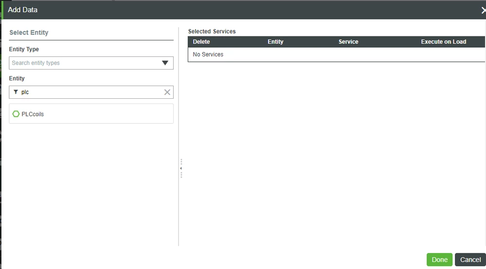

  1. At the top-right, click the Data tab, then click the + symbol.
  2. In the Add Data pop-up window, enter plc in the Entity Filter search box.
  3. Select the PLCcoils Thing.
  4. In the Services Filter search box, search for getprop.
  5. Click the right arrow to select GetProperties.
  6. Check the box for Execute on Load under Selected Services.
    • This causes the Service to be automatically executed upon the Mashup being loaded.
  7. In the Services Filter search box, search for setprop.
  8. Click the right arrow to select SetProperties.
    • Note that you should keep Execute on Load un-checked for this Service, as we do NOT want it to automatically execute on Mashup load.

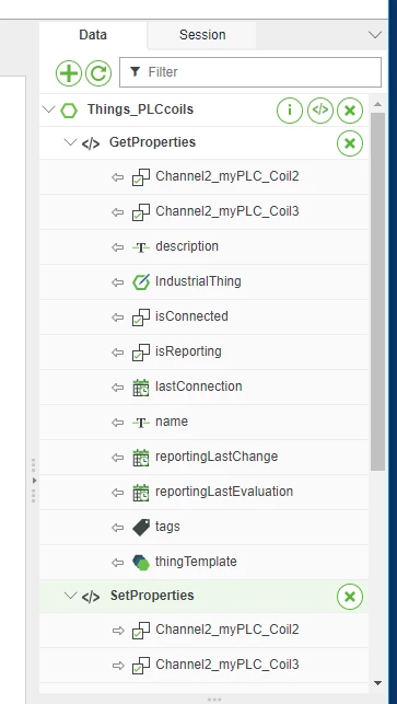

  9. Click Done, then click the > to expand both GetProperties and SetProperties.
  10. At the top, click Save.
