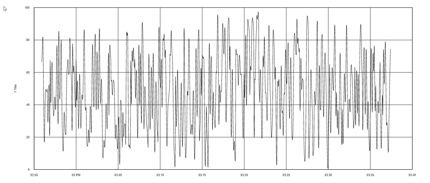

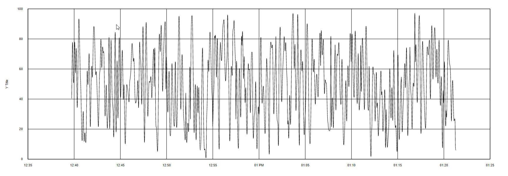

This post is about getting D3 connected as an extension to Thingworx.
There are a number of existing extensions using D3 but I wanted to explore a simple use case to make it easier to get into and bring out 2 additional points
  • Using an infotable as data input
  • Resize
The output looks like the image below

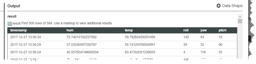

and the data was generated by a Timer based random value generator that set the values on a Thing every minute.
The data into the Widget is from a core service QueryHistory (a wrapped service that uses QueryProperyHistory)

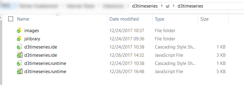

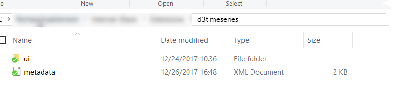

Create a folder called d3timeseries and create a subfolder ui and a add a metadata.xml file to the d3timeseries
From there create the files and folder structure

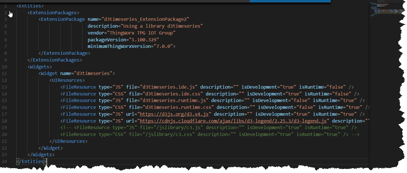

define the metadata.xml using CDN url for
D3 url url="https://d3js.org/d3.v4.js"
legend url = "https://cdnjs.cloudflare.com/ajax/libs/d3-legend/2.25.3/d3-legend.js"

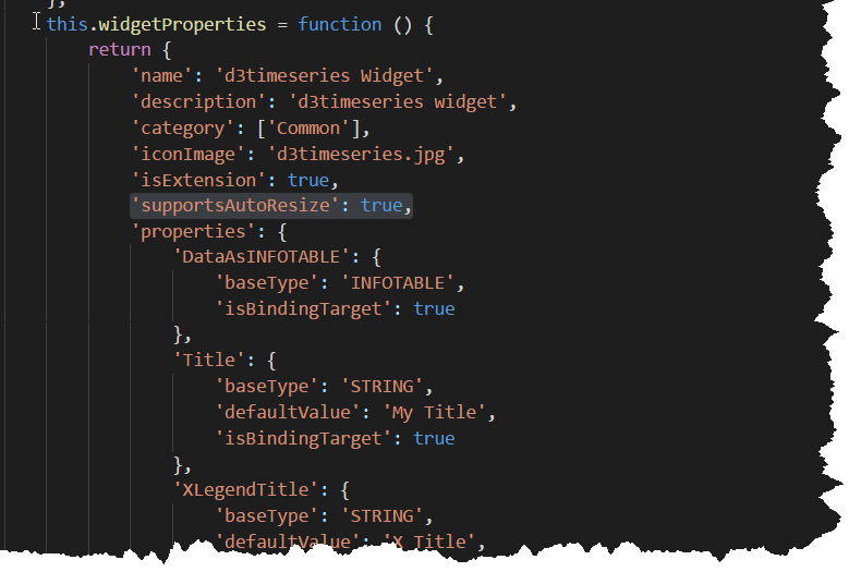

For the initial set of Properties that control the D3 will use
DataAsINFOTABLE (Data coming into d3)
Title
XLegendTitle
YLegendTitle
TopMargin
BottomMargin
LeftMargin
RightMargin
Note: we are not using Width and Height as in previous articles but setting 'supportsAutoResize': true,
Below shows the general structure will use for the d3timeseries.ide.js properties

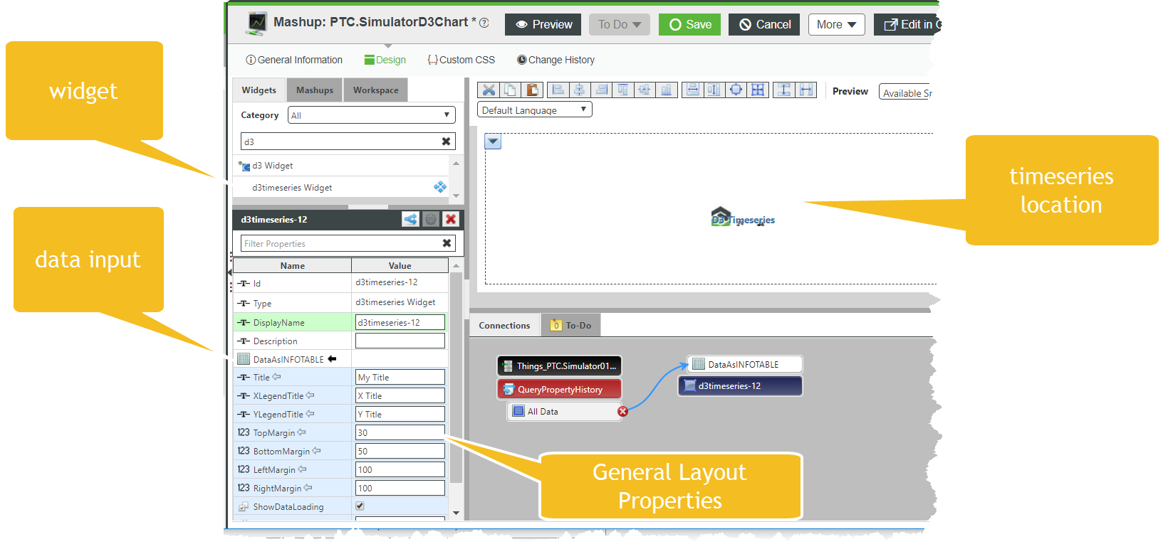

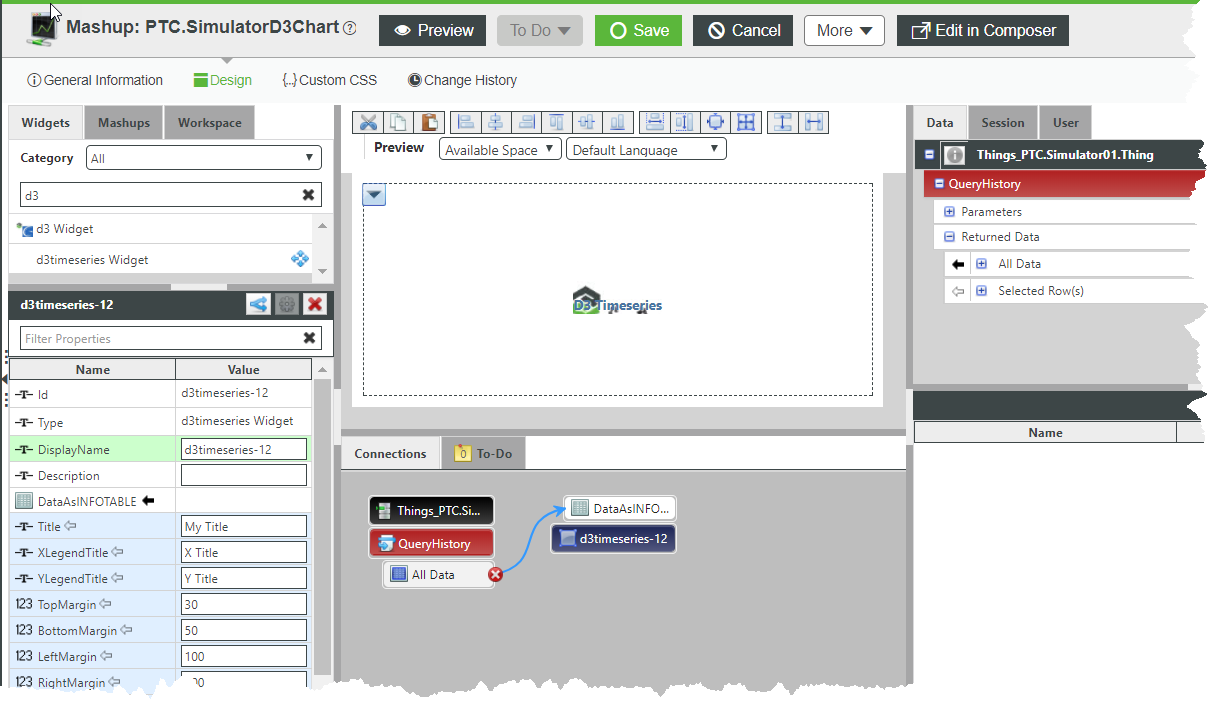

After deploying the extension  (take look at Widget Extensions Introduction to understand the how) we can see its now possible to provide Data input and some layout controls as parameters

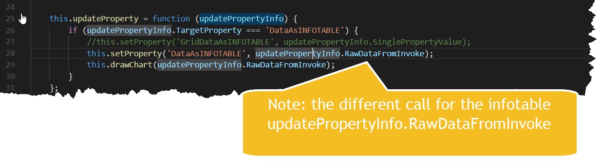

From there we can work in the d3timeseries.runtime.js file to define how to consume and pass data to D3.
There a 4 basic function that need to be defined
  • this.renderHtml
  • this.afterRender

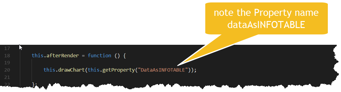

  • this.updateProperty
  • this.resize

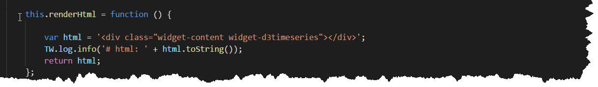

renderHtml

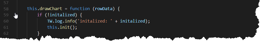

The actual D3 worker is drawChart which I will break down the highlights

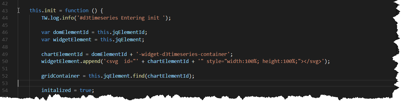

I use an init function to setup where the SVG element will be placed
The init is called inside drawChart

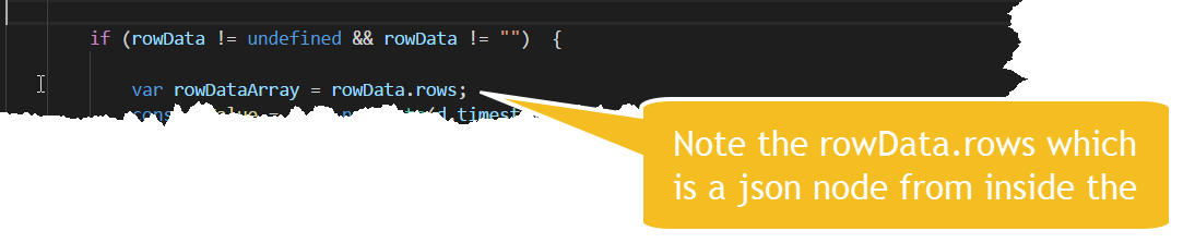

Next inside drawChart the rowData incoming parameter is checked for any content we can consume the expected rows object

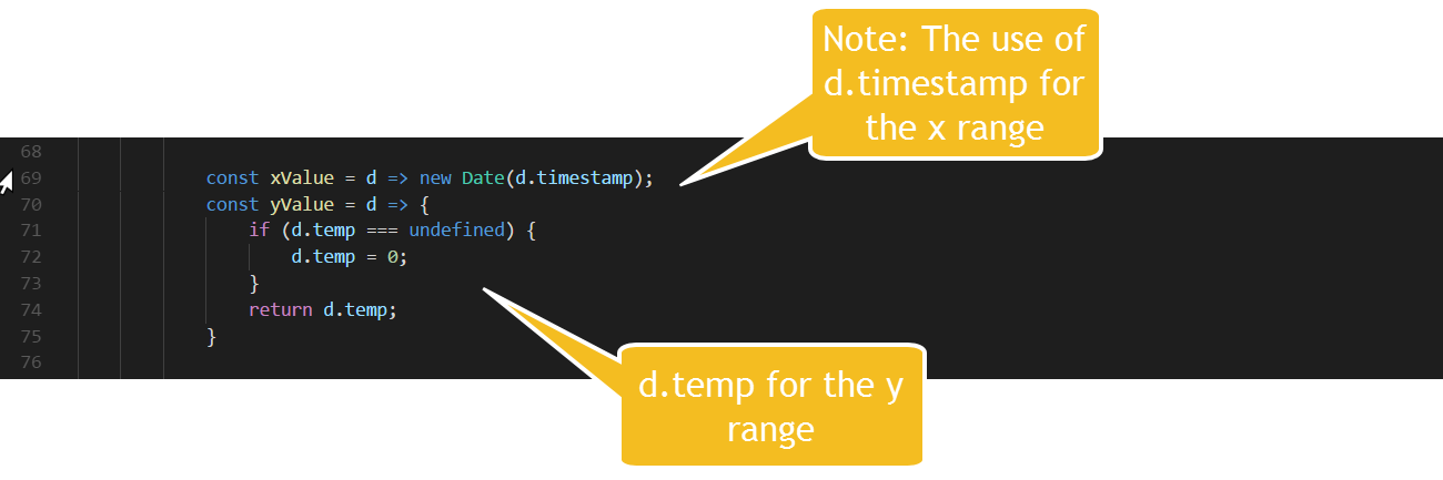

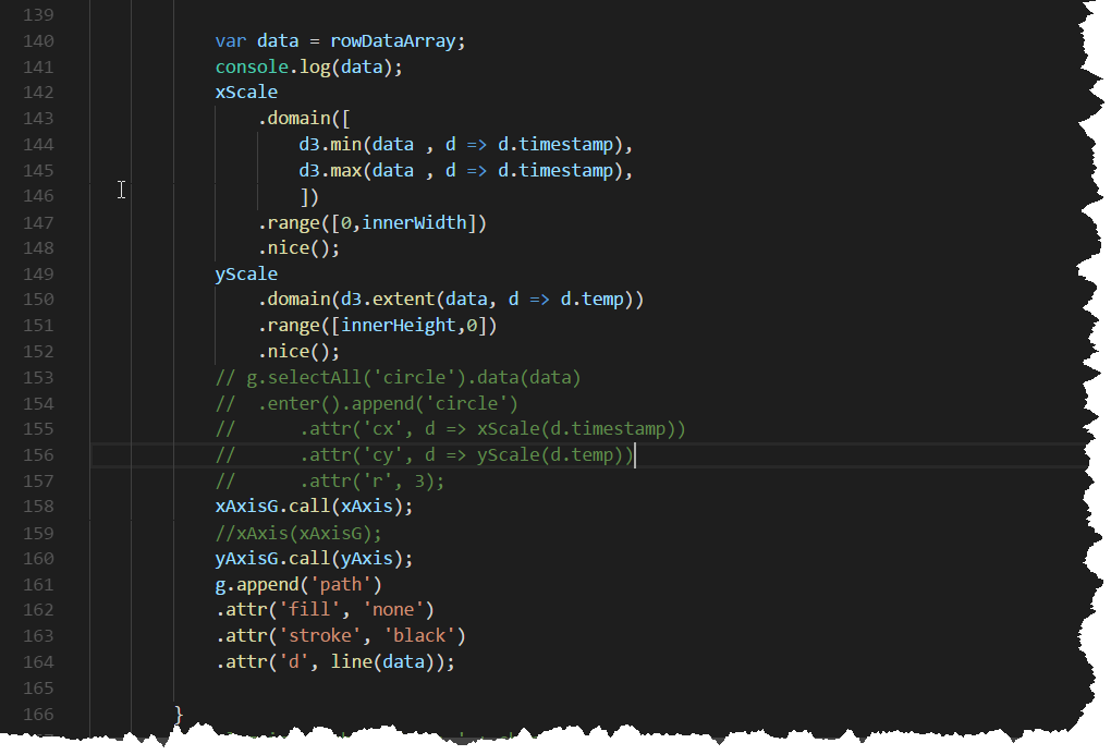

Next the x and y ranges need to be defined and notice that I have hardcoded for d.timestamp and d.temp these 2 are returned in the infotable rows

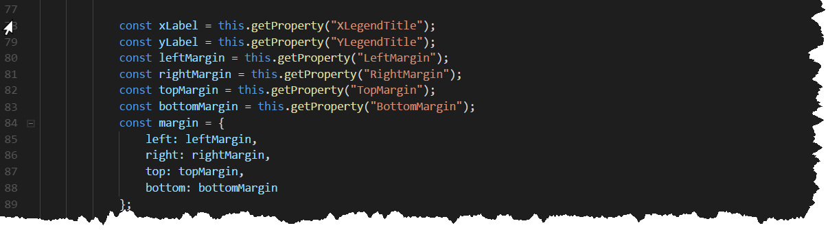

The last variable inputs are the layout properties

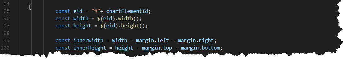

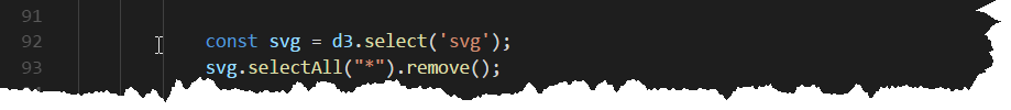

Define a svg variable and use D3 to select the div element defined in the init function. Also remove any existing elements this helps in the resize call.

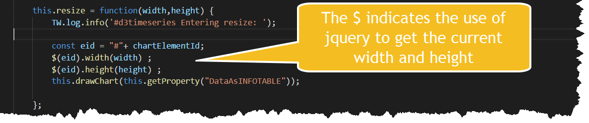

Get the current width and height as before

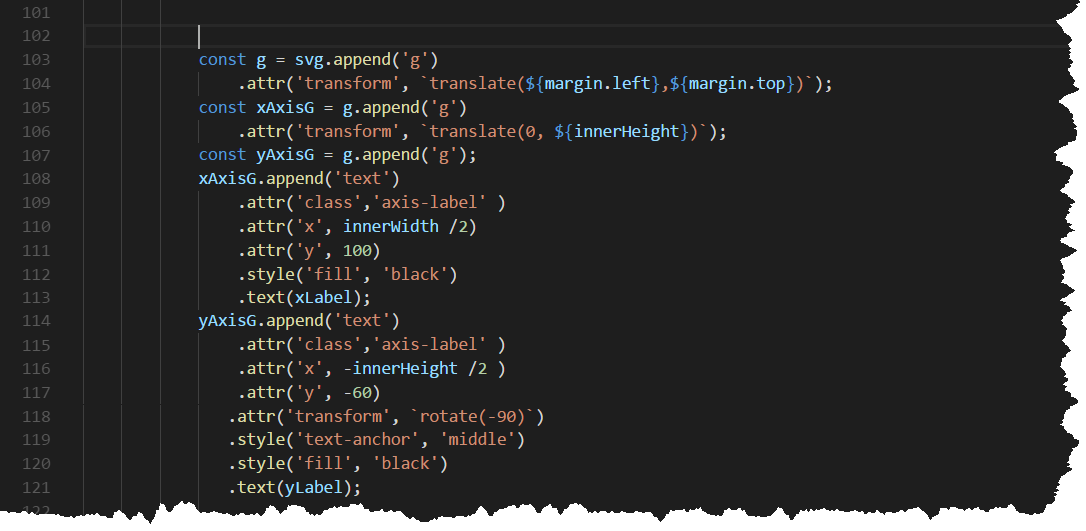

Below sets up the x and y axis and labels

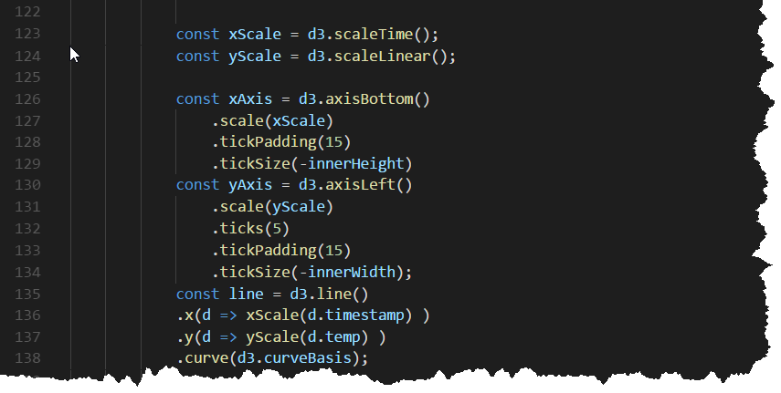

Next define x and y scale so the visualization fits in the area available and actually add the axis's and ticks, plus the definition for the actual line const line = d3.line()
Now we are ready for the row data which gets defined as data and passed to the xScale and yScale using in the const line = d3.line()

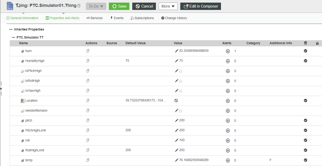

Thing properties example

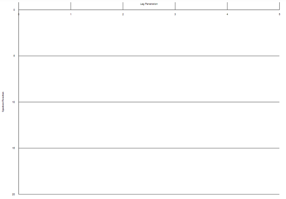

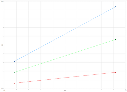

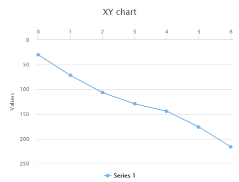

Thank you for your post for helping me to get started on my widget extension using d3.js. However, rather than a timeseries chart, I now have an XY chart which looks as follows (done using the existing XY chart widget in Thingworx). I want the x-axis to be on the top of the chart so that the intersection of the x-axis with the y-axis is in the top left corner instead of the bottom left corner. The x-axis values should increase from left to right and the y-axis values should increase from top to bottom. Therefore, I have combined the code of an XY chart widget with your code.
Current results (using existing XY chart widget and d3.js respectively):
Expected result:

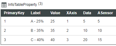

I have studied and followed your example but I am stuck on getting the grid lines for the x-axis and displaying the binded data in my infotable. My infotable is as shown below. I am using the XAxis value (1,2,3) for my XAxisField and ASensor value (5,10,15) for my DataField1 in the composer.
I have attached the zip file containing the code for the existing XY chart widget for reference as well. Any help will be greatly appreciated!
