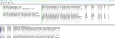

I have the similar problem as NM_12850686. Could you please share the port issue solution?

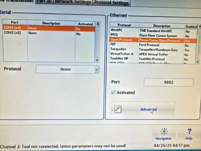

Here is my setup:
Cleco Controller mPro200 - Open Protocol - Port 9002 - Activated
Cleco Controller mPro200 - TorqueNet- Port 12345 - Activated
Cleco Controller mPro200 id : 192.168.50.20

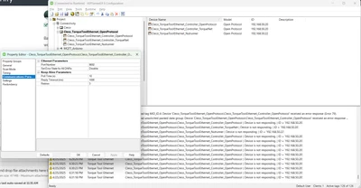

KepServerEx - Channel:TorqueToolEthernet - Device:Cleco (Open Protocol - 192.168.50.20 - Port: 9002)
Both the controller and the port can be ping successfully from the PC.
However, none of the tags receives information from Cleco. Could you please look into this?
Thank you,
LP

Greetings LP_12507955 ,
  • Connectivity to port 9002 is OK (Test-NetConnection success ✅), so network is not the issue.
  • From logs (image), Kepware shows “device not responding / timeout / write rejected / bad quality” → indicates protocol-level issue, not port issue.
  • Possible causes:
    • Open Protocol not fully enabled/configured on Cleco controller (MID messages not active)
    • Kepware driver expects specific Open Protocol handshake (MID 0001/0002)
    • Controller may require login/acknowledgment before sending data
    • Wrong controller mode (tightening vs monitor mode)
  • Checks to perform:
    • Verify Open Protocol license/activation on mPro200
    • Confirm MID traffic via Wireshark (data actually coming or not)
    • Ensure correct device model/driver mapping in Kepware (Cleco Open Protocol driver)
    • Check if controller requires KeepAlive/heartbeat
  • Important:
    • Ping/port open ≠ data communication working
    • Issue is application/protocol layer, not network
  • Suggestion:
    • Enable detailed diagnostics in Kepware
    • Cross-check using third‑party Open Protocol client tool to validate controller response

1. Controller-Side Validation
  • On the Cleco mPro200, go to:
    • Menu > Protocol Settings > Open Protocol > Advanced
    • Ensure MID 001, 005, 006, 0062, 0064 are activated for replies
    • Set Primary Trace MID = 0064 or the expected MID your system should respond with
    • Enable Auto-send MID 0064 on job completion

2. Kepware Device Settings
From your screenshot:
  • Job Select Method: Try setting it to None initially for testing
  • Start MID: Enable “Send MID 003” to select Job
  • Enable Auto-send MID 0064 (result transmission from Cleco to Kepware)
Also:
  • Increase Timeout from 5000 ms to 10000 ms for slow reply testing
  • Ensure Device Read Mode is set to either On Demand or Cyclic (not “None”)
