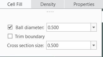

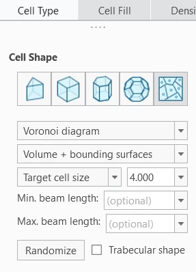

Here are the steps I followed to create a stochastic lattice cube:
1. I created a 10x10x10mm cube using an extrusion ;
2. From the engineering menu, I created a lattice function ;
3. I replaced the body with lattice, choose stochastic as cell shape with the Voronoi diagram ;
4. I chose a cross section size of 0.5mm, a sphere diameter of 0.5mm and a uniform lattice density ;
6. I chose a simplified representation of the lattice.
After that, I tried to import the cube in 3MF format, but the resulting file is empty.

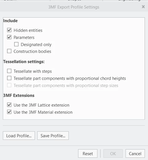

Hi @CS_9946686
Thanks for sharing the detailed information.
When creating Lattice feature, change the representation to "Full Geometry".
Also, other option for Simplified representation is to uncheck "Use the 3MF Lattice extension" in export settings.
This will allow importing the 3mf correctly.
