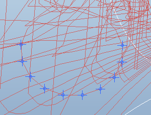

Any one else seeing more toolpath errors?
I have been finding more and more gouges lately and i am wondering if any one else has been finding the same. MAINTAIN_CUT_TYPE will generate these strange circular gouges.
18 replies
Dec 2, 2011 10:47 PM UTC
Sorry to say this but I have never used Maintain_Cut_Type. What strategy is that in the picture?
Dec 5, 2011 3:44 PM UTC
The picture is from a roughing cycle
Dec 5, 2011 6:12 PM UTC
What release are you using? I have seen similar output. We have also ran into an issue where the tool path will reverse the cut direction midway thru a cavity. Support says the issue has been resolved in Wildfire 5.0 M120 which is due out the end of December.
Dec 5, 2011 7:05 PM UTC
WF5 M100 but I have seen this circular error happen since wildfire 3 it just seems to be happening with much more frequency now. I'm to the point where I avoid using this cut type at the cost of cycle time.
Dec 6, 2011 1:53 PM UTC
Wow... gouging with roughing is a serious problem. If you leave more stock will the gouges go away?

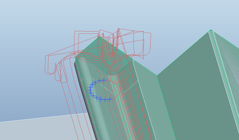

Found another one today!

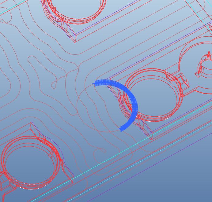

Here is a roughing error for you Nick!! Why do they always seem to be round. Software must be confused and running in circles!
Dec 20, 2011 2:17 PM UTC
yes I like that one! it is always circles have you noticed that adjusting the step over can effect these errors?
Dec 21, 2011 6:21 PM UTC
Nick and Brian:
Just to make sure we're all in the same page: Was the problem formally reported to PTC? Did you get an SPR?
I'm assuming that the problem is not the same for both...
This seems critical and sometimes we think someone reported a problem but nobody did, so PTC don't fix it... I'm struggling with a problem when reversing cut direction and lead in / lead outs getting messed.. never reported because it as a very known flaw...I thought other people have done it... so, just in case...

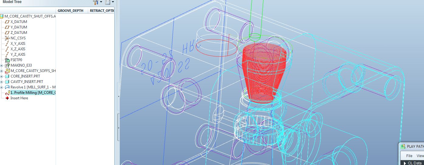

How about an error while profile milling while we are on toolpath errors!!
I do a lot of profile milling. Look at what I have been getting lately. I built a revolved mill surface for the profile cut then select that mill surface for the profile sequence. for some reason after making several correct passes it makes a pass outside the surface in another cut for no apparent reason!! WTF!! this stuff is really starting to bother me.Tired of trying to make good parts, But spending WAAAAY too much time trying to diagnose tool path errors on stuff in previous revs I could do without even thinking about.
