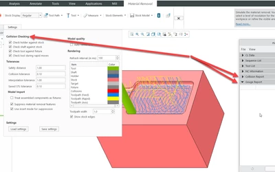

Is it possible (in the base Creo CNC) to replace or add to the tool shown in the "play path" a partial model of the machine head? I am using position milling in Creo NC to program a 5 axis gantry mill. The parts are quite large and require that the machine head goes inside the workpiece. There are areas that require close attention to avoid crashing the machine in to the workpiece. I need to find a way to see the machine head so as to avoid collisions. Is there a easy way to do this in the base Creo NC software?

Hi Barry,  using the Creo NC basic functionality  you can use fixtures to place them where you want and check potential gouges and collisions against them...
Combine that with the functionality  included in Material Removal:
Regards
Jose

  The parts/workpieces are large (36" + deep). The collisions are not only between the tool and the workpiece/part but also the machine itself and the workpiece/part. There are areas where the head of the machine will barely fit in the machined pockets.
  We are probably exceeding the intended purpose of the base software. It can be done but it is not easy. I was hoping to avoid the expense of moving to a more advanced module.
