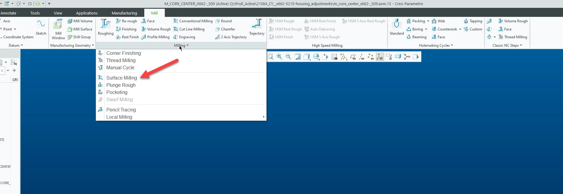

Creo 7.0 Surface Milling
Sometime between 7.0 and 4.0 Creo think tank decided to destroy our most useful sequence.  Surface Milling.  What was done for so long in Surface Milling now has to be done in Conventional Milling.  One can open an older project with surface milling in it, and it works fine.  Make a change to that sequence, such as an added or removed surface, and it "updates" to the new version of surface milling which appears to be useless.  This forces us to make a new conventional milling sequence.
Surface selection in conventional milling is unbelievably inefficient.  No more are the days of dragging a box around a group of surfaces to collect.  The tech support seems to push the Seed and Boundary method of collection.  This works OK for simple pockets with a flat plane at the top boundary.  If what you are milling has a varying top surface, it just doesn't work.  We have tons of projects that capture geometry via Mill Volumes.  To select the surfaces within a Mill Volume, one has to right click, left click over and over and over hundreds of times sometimes to collect the surfaces that you want to "conventionally" mill.

Razmosis,
I complained about this when they first made the change. It fell on deaf ears as usual. At one point the surface milling was under classic NC Steps where you could window around a set of surfaces, but it appears to be gone now(Creo 8). The only saving grace to conventional surface milling is the mill window option in the reference type pull down menu. if not for that selecting surfaces is a chore like you say.

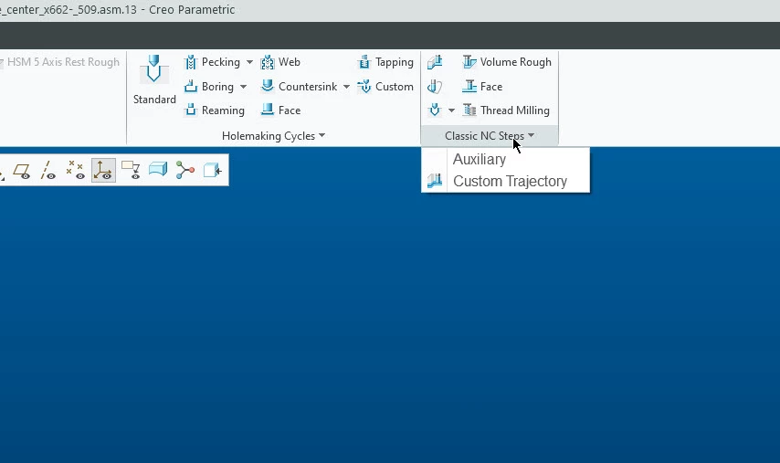

Ken, Razmosis,
The classic surfacing is still there just not where i was expecting to see it.
I think the config setting ENABLE_CLASSICNC_STEPS = YES  needs to be set to see it. It still allows window surface selection but it's the old menu style.
The custom trajectory is still under the classic nc step pull down menu.
