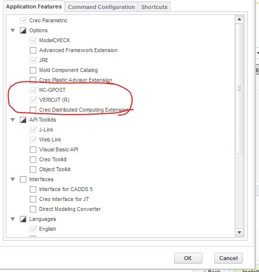

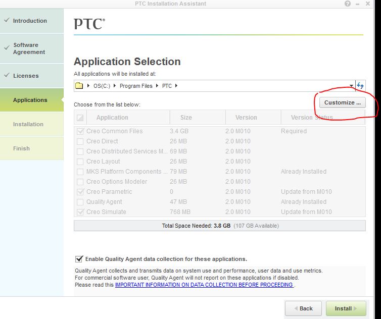

I just installed creo, and i am missing the vericut option. While The installation is totally different then before, i cannot find where to install this. anyone an idea?
Thanks in advance.
Paul
Jul 10, 2012 6:31 PM UTC
Paul,
after the license screen you should see the applicatio selection screen if you look at the top there should be a cusomize button
Jul 11, 2012 8:42 PM UTC
Steve,
I got it up and running. Thanks for your support and help.
