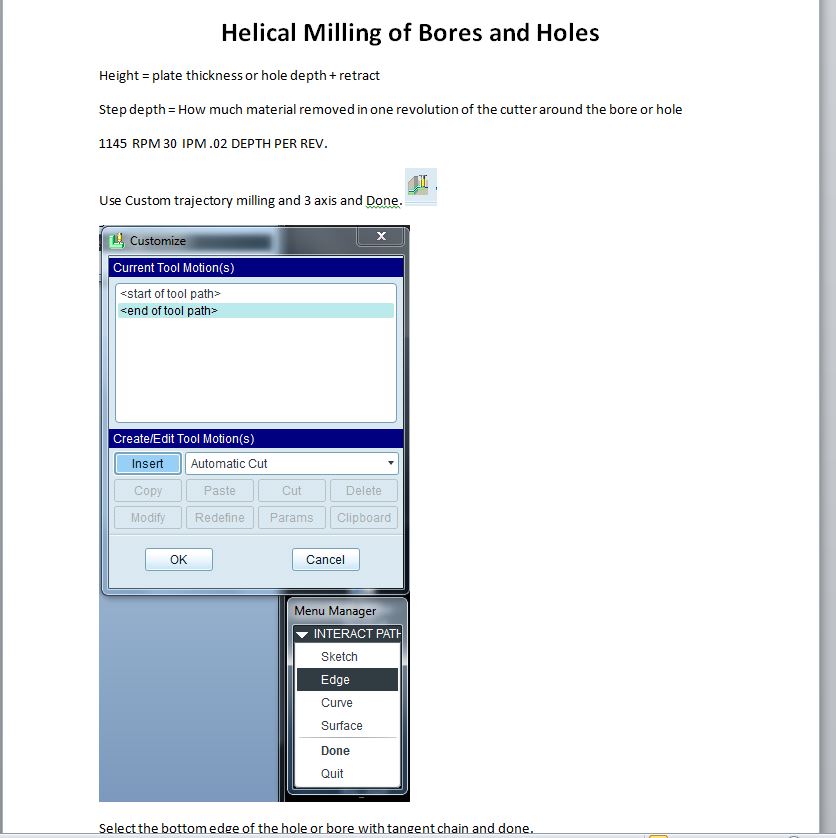

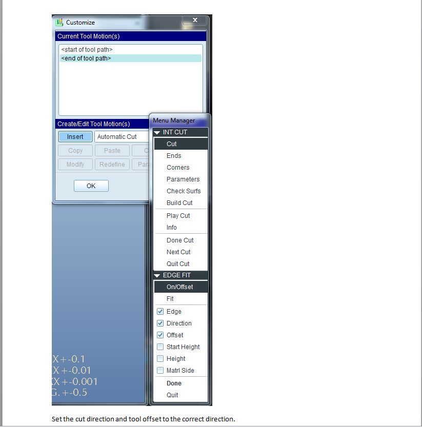

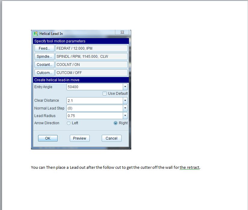

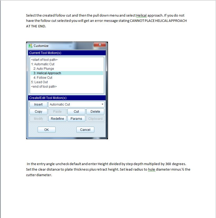

I can try and paste my cheat sheet fo helical milling in here but email would be better.
This is the way I used to do helical bores way back in WF4 days. Crude but it works.
hope it helps.
Steve
hope it helps.
Steve

Thanks Steve!
I knew there had to be a better way.
The only reliable way I had previously found was to do it as a Mill Surface and set the cut lines as closed loops at each end of the cylinder. Then I could go back to Parameters and change the scan type to Helical.
I still had to go to the custom area to add lead-in/lead-out but at least the parameters propagated.
Many thanks!
