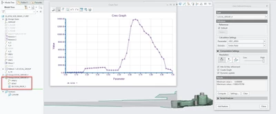

Dec 30, 2021 7:31 AM UTC
BMX brings in analysis features, which will give you (among other tings) ability to generate graph over model how section area changes. From that graph it is quite easy to compute other derived measures as well.
SAMPLE:
The red box contains datum field point, datum plane which defines cross section location and section measurement analysis feature. The idea is, that datum field point lies on curve and goes from top to bottom of model.
