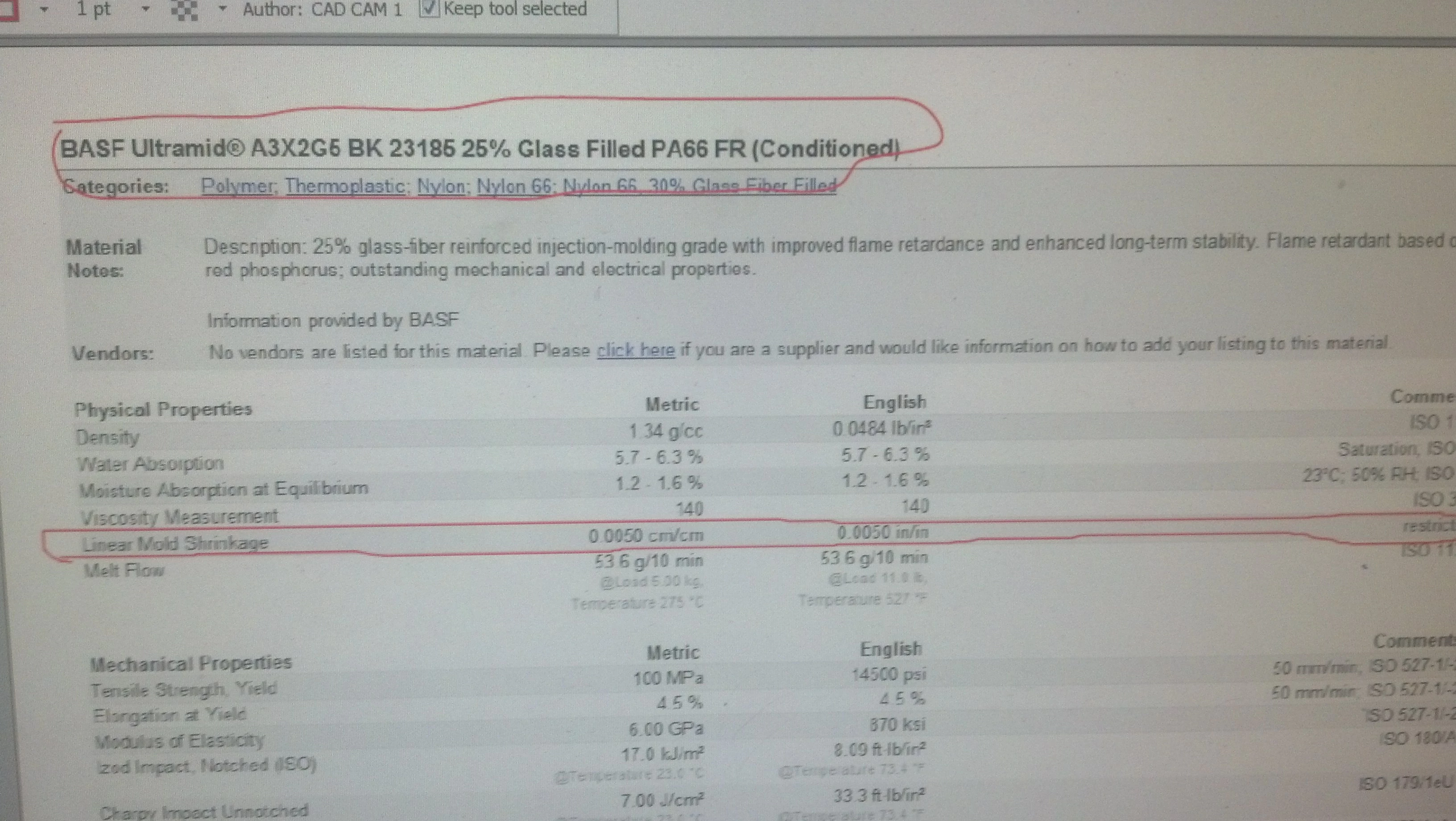

Can't understand how do I put these shrinkage value(see jpeg) on my model.. please any one guide me...0.0050cm/cm
....or 0.0050in/in...????what does it mean

Thanks Ben for your reply.... I know how to use shrinkage dialogue box in creo..but what confusing me is the value which I take from metweb..of that plastic...as 0.0050cm/cm.or
0.005in/in....if I work in millimeters...then what should I have to put in shrinkage column.....

I would say if you are using millimeters it would be a safe bet to use .050 mm, which would be the same as .005cm.

Mold shrinkage is a ratio, the units don't matter.  Notice that the value is the same, 0.005, for both metric and English.  It's 0.005 inches of shrinkage per 1 inch or 0.005 cm per 1 cm.  The same would be true of mm or km or yards or whatever.
What it is saying is that it shrinks 1/2 of one percent. In other words, for each 1 unit of length it will shrink 0.005 units.
