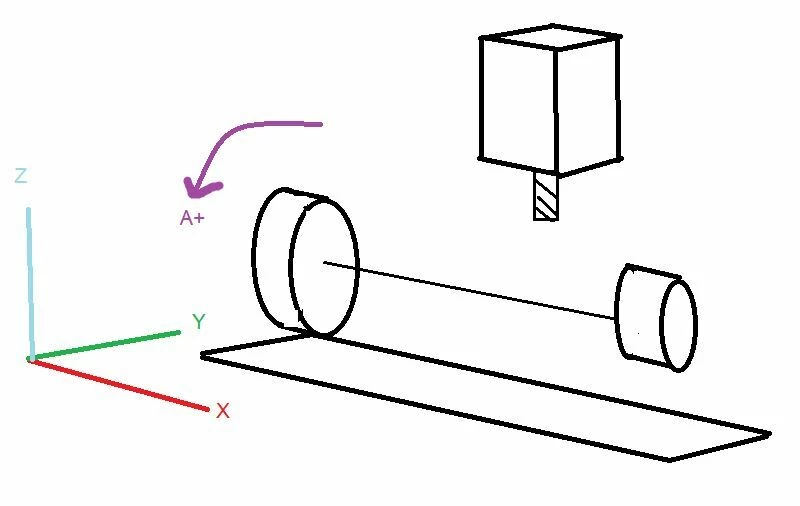

Hi there. I built a pretty typical 4-axis desktop CNC machine with an ‘A’ axis which rotates in the positive X direction and controlled by Mach3 on a USB controller. Overall it works well for any 3 axis milling/roughing/surfacing operations. See below configuration.

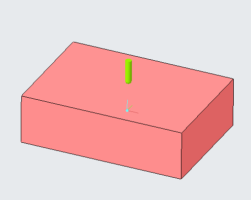

The material removal simulation in Creo shows the appropriate rotation happening. I can also manually type in the “A -90.0” command into the exported G-code in the proper spot, which works great on the machine and allows me to accomplish my goal...But I’d prefer not to type this in with each required rotation of the part I’m milling.

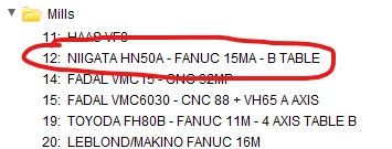

I was able to select the second default Fanuc mill (which is 4 axis) and then change the B axis to an A axis which then worked for me and included the rotation commands in the G-code.
I’m not sure which setting or syntax this second post processor is including to make things work, but it is including the A axis commands as it should. I would have to compare it between the HAAS VF8 default above it to see which command or radio button is included now.
