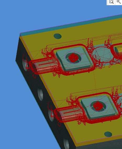

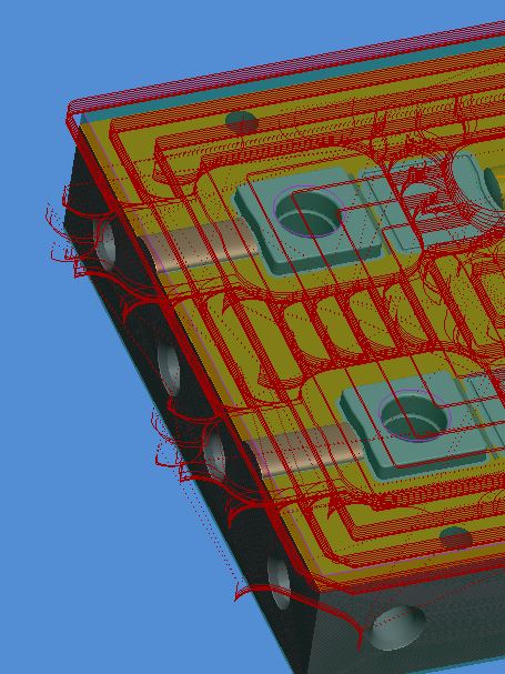

I have a roughing sequence with a sketched window.750 diameter high feed mill pictured below.It works great. I then do a rerough to tighten up the corners with a solid carbide .375 high feed end mill and it drops into the core holes. I don't want it to drop into the core holes but I don't see a way to exclude surfaces in the re - rough routine. with regular volume roughing with a mill window. you can exclude surfaces? am I missing an exclude command somewhere or did that get left out of the rerough.

Yes you can define new widows for re-roughing sequences I do it all the time. I did think of another trick that might work for ya. just create some solid extrude cylinders and assemble them into the holes.

Try this define a new sketched window for your re-roughing with the core hole edges refrenced.

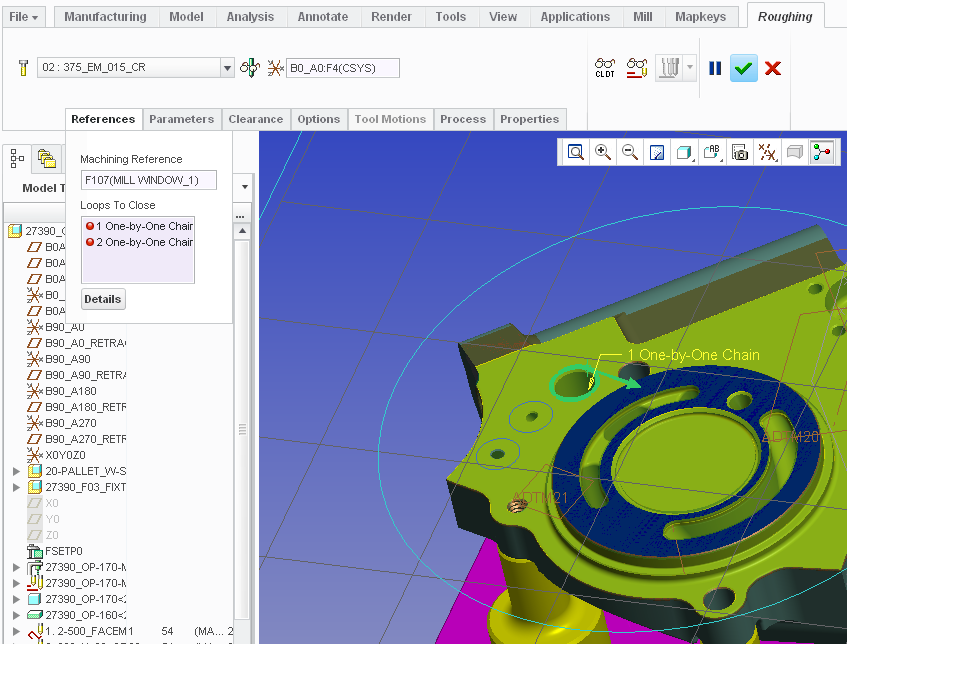

It is a sketched window with the core holes refrenced. if you look at the the second picture close you can see a purple line around the core holes. that is what has me baffled. I kind of anticipated that happening so I made the sketch for roughing with the holes. but even so it still cuts inside. Also can you reference a roughing routine with the rerough and then create a new sketch for the rerough? Not sure it will recalculate what has already been cut ?
I guess I am back to using volume rough. and making a couple different sketches to rough and rerough or the old nasty mill volume that no one likes anymore except me I think.

you could try the "loops to close" option to get the cutter to avoid your holes.loops+to+close.bmp
May 29, 2013 1:17 PM UTC
I dont believe that option is available for re-roughing
May 29, 2013 2:12 PM UTC
Nick is right Paul you loose the close loops when you rerough.
I have this in as a product sugestion. if you could go and vote for it to be implementedthat would be great. the more interest there is the more chance it has of happening. I think the product sugestion is on the creo front page on the right. Took me a while to find it to get the sugestion in.
