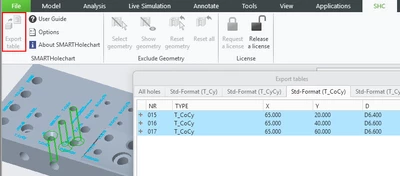

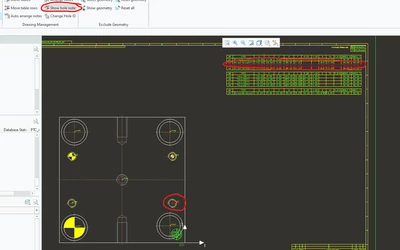

Please refer below. Here the Smart hole chart option "Show hole ID" will show the individual hole position when selecting the respective table raw. It will be great if i can select the full set of type holes (Example A1-A4) to see where these holes are positioned. This will be helpful when showing the hole details in section view as i don't want to show same hole type in multiple section views. please let me know in any way it is possible.

Using the command 'Show hole ID' let you only show one hole.

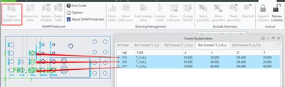

But you can reopen the SMARTHolechart dialog at any time.
Inside the dialog you can sort by columns in the 'All Tables' view and select your holes.
You can also switch to the “Type” tab and select all types.
The corresponding holes are then highlighted for all selected rows.
Sometimes it is clearer to work in the 3d model - this is also possible.
