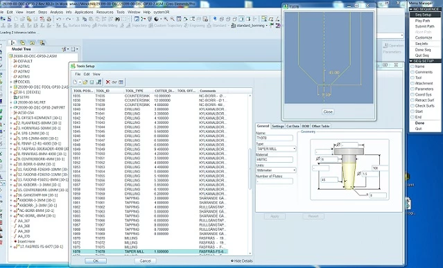

Hi all,

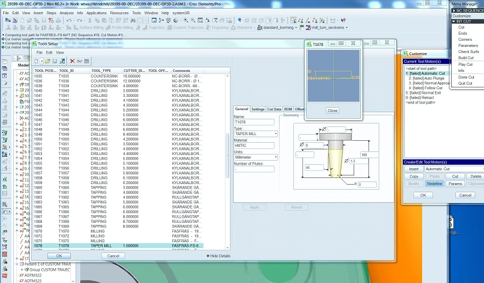

We have over the years had random problems with some tools, and now it is specifically the Taper mill tool. When defining the tool setup parameters the tool window is not showing the correct look of the tool, as would be expected by the values put in. Please seecorrect and wrong picture attached.
When the tool window displays the tool in a wrong way, the resulting tool path programme will be wrong as well ! So it is not just a display issue.

I've dealing with this for years... It's random and hard to reproduce at will...
I've tried several times to report this to PTC but I'm never able to reproduce the issue... close the NC assembly , erase memory and open it again seems to solve most of issues...
This problem is also linked to failures in material removal features, once the tool shape is corrupted the system also fails to MR features...
I've seen this behavior with several tool types, not only taper mills, although I think they are more prone to show it...
The tool manager as a whole has some "ghosts" in its code... One of the most famous ones is the wrong graphical representation of tapered mills with a corner radius...
