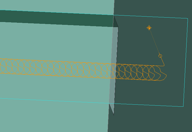

Had some free time to work on this today.  Source link
I created a curve by equation and used that to drive a trajectory milling sequence for some long slots I needed to mill.
here is the equation I used to create this curve.
/* ENTER TOOL STEP OVER
SO = 0.05
/* EMPIRICAL VALUE TO CORRECT SHAPE ERROR
SF = 0.0175
/* ENTER PROFILE ALLOWANCE (STOCK)
PA = 0.005
/* ENTER TOOL CUTTER DIAMETER
CD = .3937
/* ENTER SLOT WIDTH
SW = 0.811977
/* ENTER NUMBER OF REVOLUTIONS
N = 100
A = ( ( SO * SF ) / 3.141592654 ) / 2
B = ( ( SW - ( 2 * PA ) ) - CD ) / 2
x = ( A * ( t * N * 360 )) - ( B * sin ( t * N * 360 ) )
y = ( B * cos ( t * N * 360 ))
z = 0
I don't understand what the shape error value is about but it seems to work for this application.  Just thought i should share this with everyone in case they wanted to use it or improve it

Nick,
Nice looking tool path !
Oct 13, 2016 3:47 PM UTC
Thank you

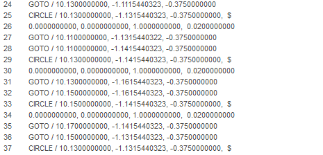

I'm finding that the cl data and g-code is all points so now am looking into arc fitting but not sure if this is a wise move.

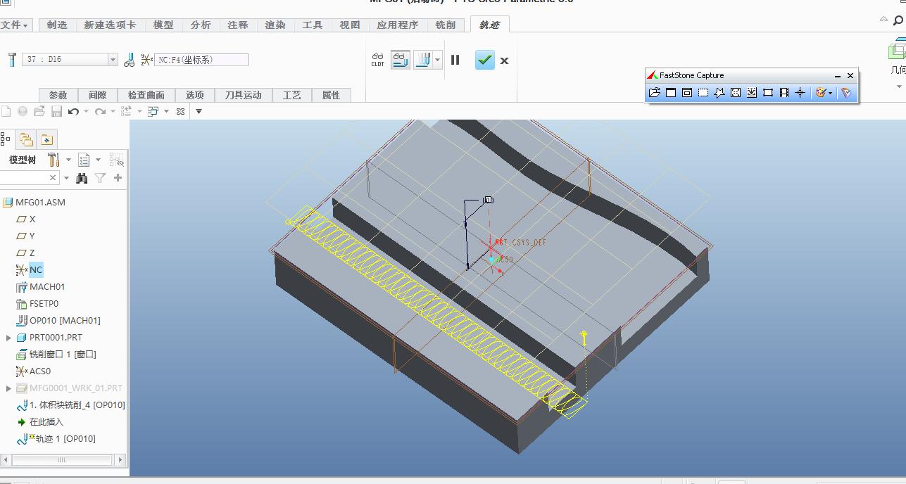

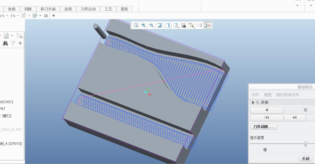

Interesting application.
If you are using creo3you can do something similar using volume-mill and the cl data isn't all pts. This would allow you to control tool selection and parameter adjustment normally. You can also do slots that aren't straight.
Josh
Oct 13, 2016 8:56 PM UTC
oooh i like the look of that cl data but volumill is extra $ correct?

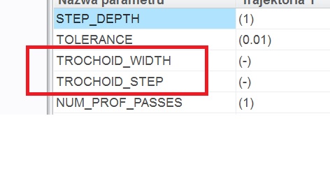

Oct 21, 2016 1:58 PM UTC
Set hidden option in your config.pro
trochoid_milling yes
Then in your parameters of 3 axisTrajectory miling appears 2 additional parameters:
TROCHOID_WIDTH and TROCHOID_STEP
and then you can use it.
