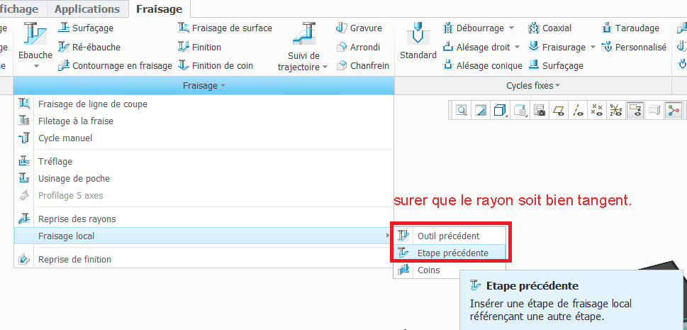

If I have well understood your problem, you should use one of the two sequences I surrounded below. From my point of view the trajectories that are calculated are not always very optimised but it's the only I have found to do what you describe.

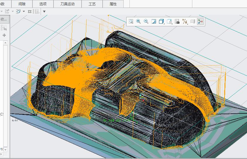

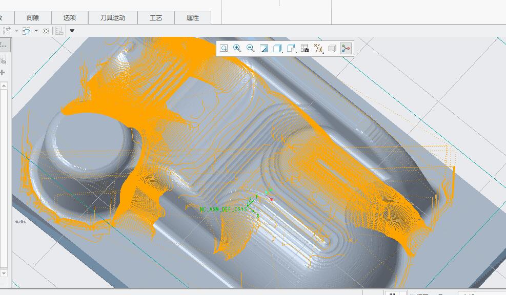

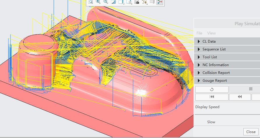

Jan 17, 2017 5:19 PM UTC
The pictures seem to refer to a finishing sequence not to a roughing one.
Finishing do not need workpiece or stock model.

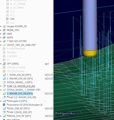

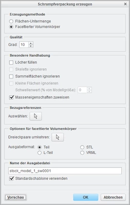

You can do it following those steps:
- Save the StockModel as a prt-File.
- open the Part and save it as a shrinkwrap file.
it should be checked like this:
- load this shrinkwrap part as a workpiece into your nc asembly.
it works if it is not having problems with that second workpiece. In this case, you better test it in a new nc assembly.
Unfortunately, if you change the millingstrategy, yu have to do it again.
But for problematic cases, this could be handy to know.
The reason I am trying this out is because a re-rough step is not allowing after a lets say d16_r2 mill to use a D20_R10 ball mill.
Secondly, if you use a D32_R2 and then use for instance a D10_R5, the pathes are way to many because it can  not handle the now bigger radius of the ball mill.
Using other methods are clearly telling the user that he is expecting only ball mills. so no flat and then ball. bad for roughing.. bad for us creo nc users..
