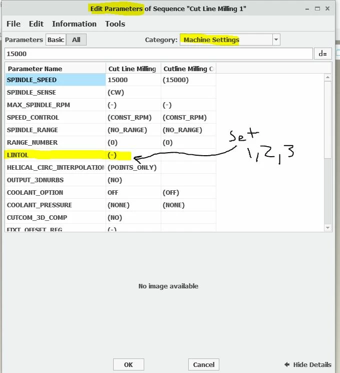

Jun 17, 2023 10:01 PM UTC
set the parameter LINTOL to 1, 2 or 3
in the fill file add
SET187=0  $$ this is a global variable and can go near the top of the fill file
$$ * L I N T O L S E C T I O N *
CIMFIL/ON,LINTOL
TPCDE=POSTF(7,4)  $$ get the lintol value
CASE/TPCDE
WHEN/1
SET187=1
DMY=POSTF(26,5,5,1) $$TURN OFF CIMFIL/GOTO FIL ROUTINE
WHEN/2
SET187= 2
WHEN/10 $$ TURN OFF G5 AND G5.1
SET187= 3
ENDCAS
CIMFIL/OFF
$$ *          GOTO POINT SECTION           *
CIMFIL/ON,GOTO
DMY = POSTF(20)
  CASE/SET187
   WHEN/1
  INSERT/'G187 P1'
  SET187=0             $$ RESET SET187 FLAG
   WHEN/2
  INSERT/'G187 P2'
  SET187=0
   WHEN/3
  INSERT/'G187 P3'
  SET187=0
   ENDCAS
DMY = POSTF(21)
DMY = POSTF(13)
DMY = POSTF(26,5,5,0)  $$ TURN OFF GOTO SECTION
CIMFIL/OFF

Thank you for the reply, this seems to be more what I was hoping for. One question though, is there a LINTOL parameter in the HSM Roughing tool paths? Also according to the documentation LINTOL specifies the interpolation used post processor for MULTAX sequences. TO be honest I do not know that this means, would someone be able to give a brief explanation?
