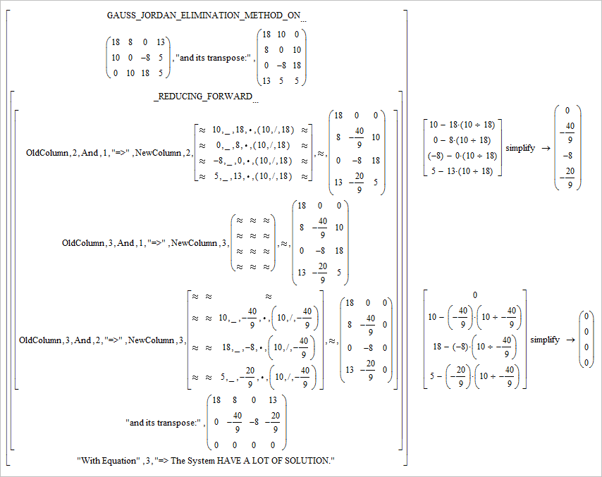

I'm trying to solve for 3 values, having 3 equations,
See attached file
Thnaks in advance for your help!
1) You had a multiplication sign between Find and the vector of variables Ri
2) Using a solve block with numeric evaluation will require you to provide guess values for the solved for variables. (For reasons I can't explain symbolic evaluation of Find will return wrong results, even if the units are omitted)
