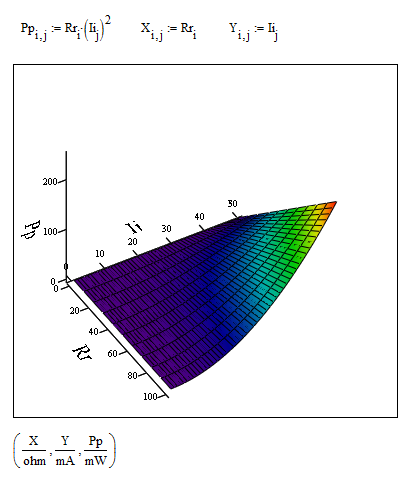

I have 2D matrix (NxM) created with indices which I like to plot in 3D. I wish to change the axes to display not the indices but rather the actual vector that have generated them (with units).
Please see the attachment.
How can I do that?

RichardJ19-TanzaniteAnswer
fpettazzi1-VisitorAuthor
Thanks! This is what I was looking for.
Cheers
Federico

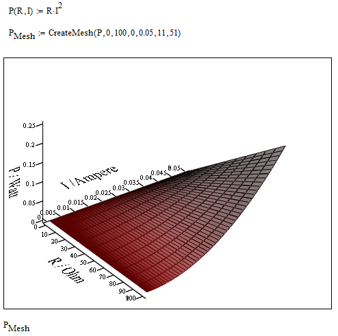

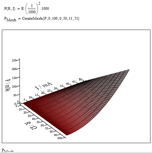

Here is a solution which just uses a function P(R,I) and CreateMesh, but the drawback is, that is has to be used unit-less and to show the results in other than the base units, you have to modify the function, which may be misleading. So you might prefer Richards solution.
Dear Werner,
Thanks a lot. I indeed find the solution of Richard more practical, but I am not familiar with CreateMesh and I will use your file to get to know this function.
best
Federico
