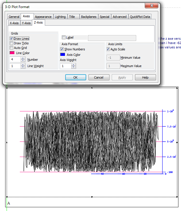

I am trying to do a 3d plot of an m x n matrix. I know that each point is plotted as an elevation on the z axe versus its respecctive row (x axis) and column y axis index. The values in the matrix are very diffrent, i mean i have -62 1.2 1 and 5.7 *10^9,  and i don't find for example the poin (1,1,-62) on the plot. Is it because the max values are so diffrent from the min values? Thank you

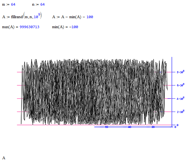

This is the data that i was talking about. I don't think that point is visible due to the differences between the max and min values.
Very Likely.
Can you manually set the lower limit in Prime?  Here's what you get when you turn off Auto Grid in M15.   You still can't really make out which values are the smallest, but at least you can see what the minimum value is.
Stuart

Even if i set the lower limit to -70 lets say, i will still not be able to visualize the point due to the high diffrence.

Can try with a logarithmic scale, after translate for avoid nonpositive values.
Best regards.
Alvaro.
Possibly because its the point (0/0/-62). Indices run beginning from 0, not from 1, when ORIGIN is set (by default) to 0.
And this point of course looks like the origin (0/0/0) because -62 is so small compared to other values in your field.
isavu1-VisitorAuthor
September 23, 2016
Yep, i think you are correct,    Thanks for the help everyone.
