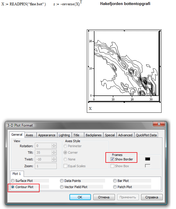

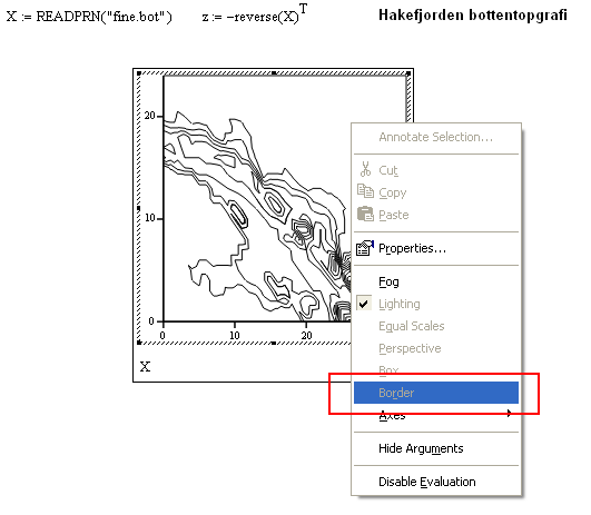

Right-click on the plot, then disable "Border":
P.S. What version of Windows OS and Mathcad 15 service release (F000, M005, M010) are you using?

January 29, 2012
How do I disable Border? It's inactive in my menue.
Windows 2007 Home Premium.
Release M010
January 30, 2012
How about that:
P.S. Also, try to disable "Aero" mode in Windows 7.
