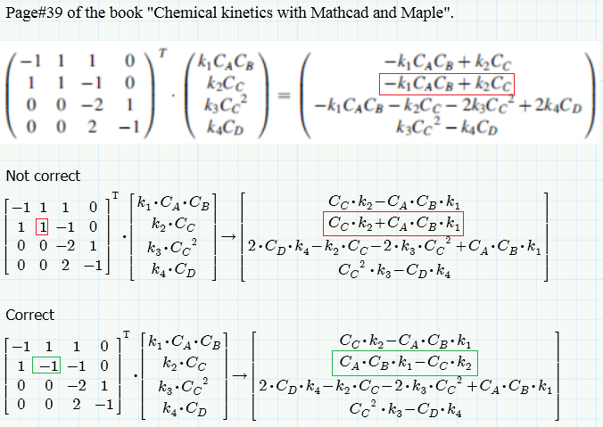

my question is focused on Page#39 of the book "chemical kinetics with mathcad and maple".
for the 1st row of the stoichiometric matrix, I think that the second element should be -1 instead of 1
Best answer by ViktorKorobov
Dear Fan CG,
Thank you. Indeed, in the book there is a error in the stoichiometric matrix. You're right.

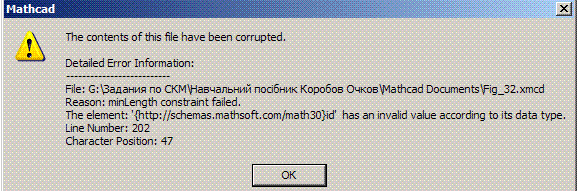

However, I do not recommend using chemical notation in symbolic calculations. Sometimes this leads to an error in Mathcad 11/13/14/15.

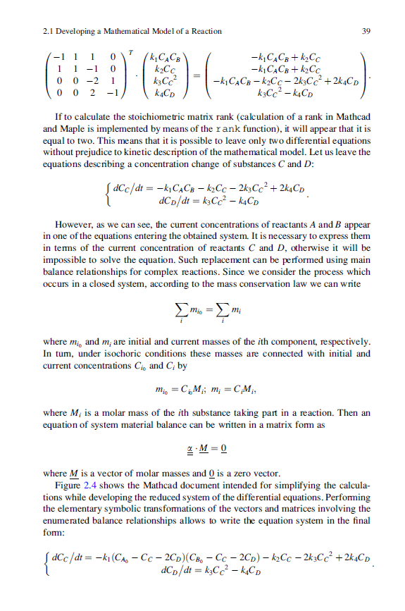

August 21, 2012
Valery Ochkov wrote:
...Can you point me the picture number!...
Page#39 from a book:
August 21, 2012

August 21, 2012
Thanks!
You are right:
