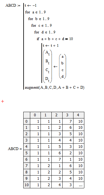

I need some ideas on how to do the following:
I have two variables a and b, the sum of a & b is 10. I would like Mathcad to work out all the possibilities that give me a+b=10, and a keep in mind I would like them to be integers.
Thank you

What if I have a, b, c, d and e?
May 8, 2014
Here's a brute force and ignorance method, again assuming positive integers only.
Alan

May 8, 2014
Are you placing bounds on a and b? Integers, fine. Positive? Or are negative values allowed? Count "0" as an integer?
