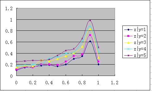

during recent experiments, I got some data like following figure.
y is the operating parameter of my experiment and z is what I wanna measure. x varies from 0 to 1
usually, such kind of data are usually fitted by an equation that looks like "z=F(y) exp[Σαi x^n]"or something others like this.
I tried to do this in mathcad twicely, but failed totally at last.
could anyone please help me solving the problem?

Best answer by RichardJ
Here's a general way to fit multidimensional data. It will work with any number of dimensions and any objective function, and does not need multidfit.
You need a different objective function to the one you specified though. That sum of exponentials cannot fit the shape of your curves in the x direction. You should be able to edit this worksheet easily enough to change that though.

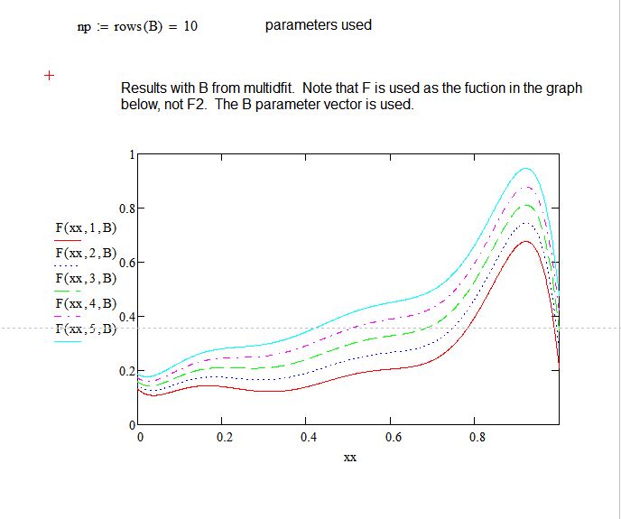

April 13, 2012
Here's another approach.

April 13, 2012
I'm using version 15. I tried sending a pdf file so you could at least see the results, but the upload seemed to stall.
