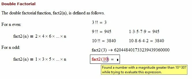

@-MFra- wrote:
I have the impression that you are making confusion. The double factorial is not the factorial of the factorial of n. On Wiki ... there is a broad description.
The number that you show fact2(3) evaluating to is actually (4!)! (620448401733239000000000).   (10!)! is monstrously long.
Do you have anything else defined earlier in your worksheet that might affect the result?

Works for me in M15:
If I try   fact2(10)=    I get the error message "This variable is not defined".  (It's symbolic only)
Alan

I also use M15.
June 22, 2020
Appears to be wrong, see also:https://www.maplesoft.com/support/help/Maple/view.aspx?path=factorial
