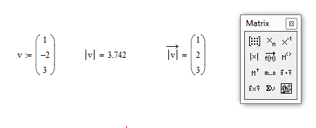

In MathCAD 14 I am attempting to find the maximum absolute value in a vector that contains positive and negative numbers. With only positve numbers in the vector this works to determine the maximum value:
max(vector)=
With positive and negative values I have tried putting the vector in absolute value bars within the max function like this:
max([vector])=
but the answer is strange and is larger than the aboslute value of any of the entrys in the vector (maybe it's finding the determinant?).
How can a command be written to find the maximum of all the absolute values in a vector?
June 17, 2014
Just vectorise the absolute value calculation. e.g.
Use the f(M) with the arrow over it to vectorise. You can then put the vectorised absolute values into the max() function.
Alan
June 17, 2014
Alan

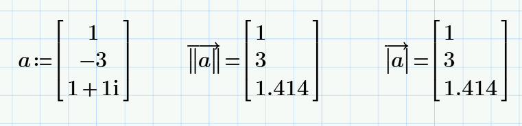

This solution works in Mathcad 14 but not prime. Is there a simple way to create a vector of the absolute values of another vector?
May 16, 2017
dsochor1-VisitorAuthor
May 16, 2017
Thank you Valery, that was very simple
