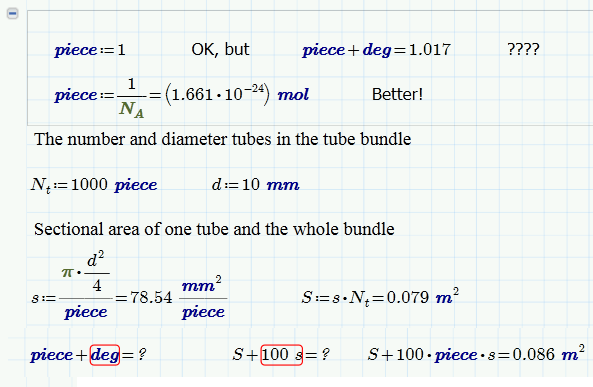

There have been at least half a dozen PTC/Mathsoft initiated attempts to collect feature requests into one place. At least three of the user-input threads to these attempts have slipped into the oblivion reserved for old, unsupported databases (ie,the Collaboratories). We shouldn't be having this conversation, because PTC/Mathsoft should have sorted the unit system out properly at least 5 years ago - certainly, as major as rewrite as Prime should have been a lot smarter than what amounts to little more than a resurrection of Mathcad 11's dynamic type checking.
Valery's example below is a good example of why a quantity tracking system is preferable to the dimension tracking system in place at the moment. Dimensionless quantities (ie, quantities of dimension 1) are indistinguishable from each other and allow such things as adding bits to bytes and angles to solid angles - thus obviating the advantages of a "unit" tracking system. One way round this is allow the user to define the quantity that is associated with each unit (and, yes, just like money, that will form a new base quantity in the Mathcad System of Quantities if it's of dimension one and not a derived quantity).

One (crazy) idea in Mole day (http://en.wikipedia.org/wiki/Mole_Day)
And what about this unit of Substance:
