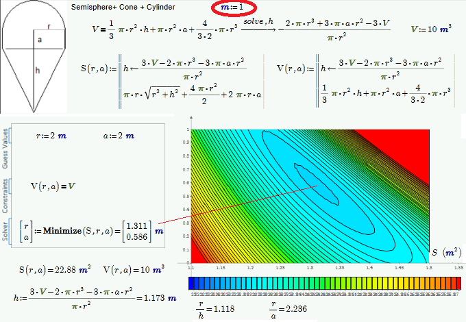

February 21, 2013
It will be good to work with units on the counter (and surface) plot in Mathcad Prime 3.0.
Now I must do so - m (meter):=1
